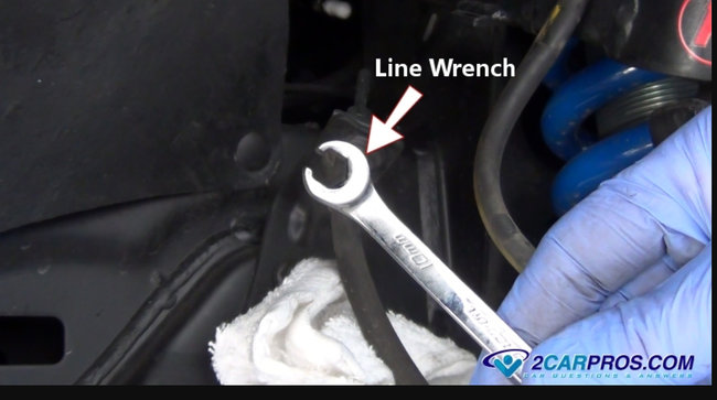

Try this. Safely lift the front of the vehicle. Have a helper apply the brakes. Once released, is the wheel still locked? If it is, open the bleeder on the brake caliper and see if the wheel can then be turned. I attached a pic below of the bleeder I am referring to.
If the wheel is locked and releases when you open the bleeder, the rubber hoses are bad and need replaced. If the wheel remains locked, then you have a caliper issue.

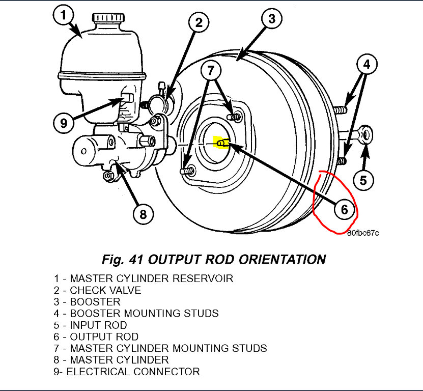

If that is the case, I suspect that when you installed the new master cylinder, the push rod wasn't aligned properly into the rear of the master cylinder. If the brakes drag even slightly, they will heat up. When that happens, brake fluid expands and will cause them to get tighter and tighter until they lock.
I attached a pic of the rod I'm referring to. Take a look through these directions for MC replacement. See if you did what is explained. I circled the part I'm referring to in the second pic. I have a feeling this is what is wrong. However, if you try the last test I suggested, we will know if it is between the pedal and MC. I can't think of anywhere other it could be, but better to check.

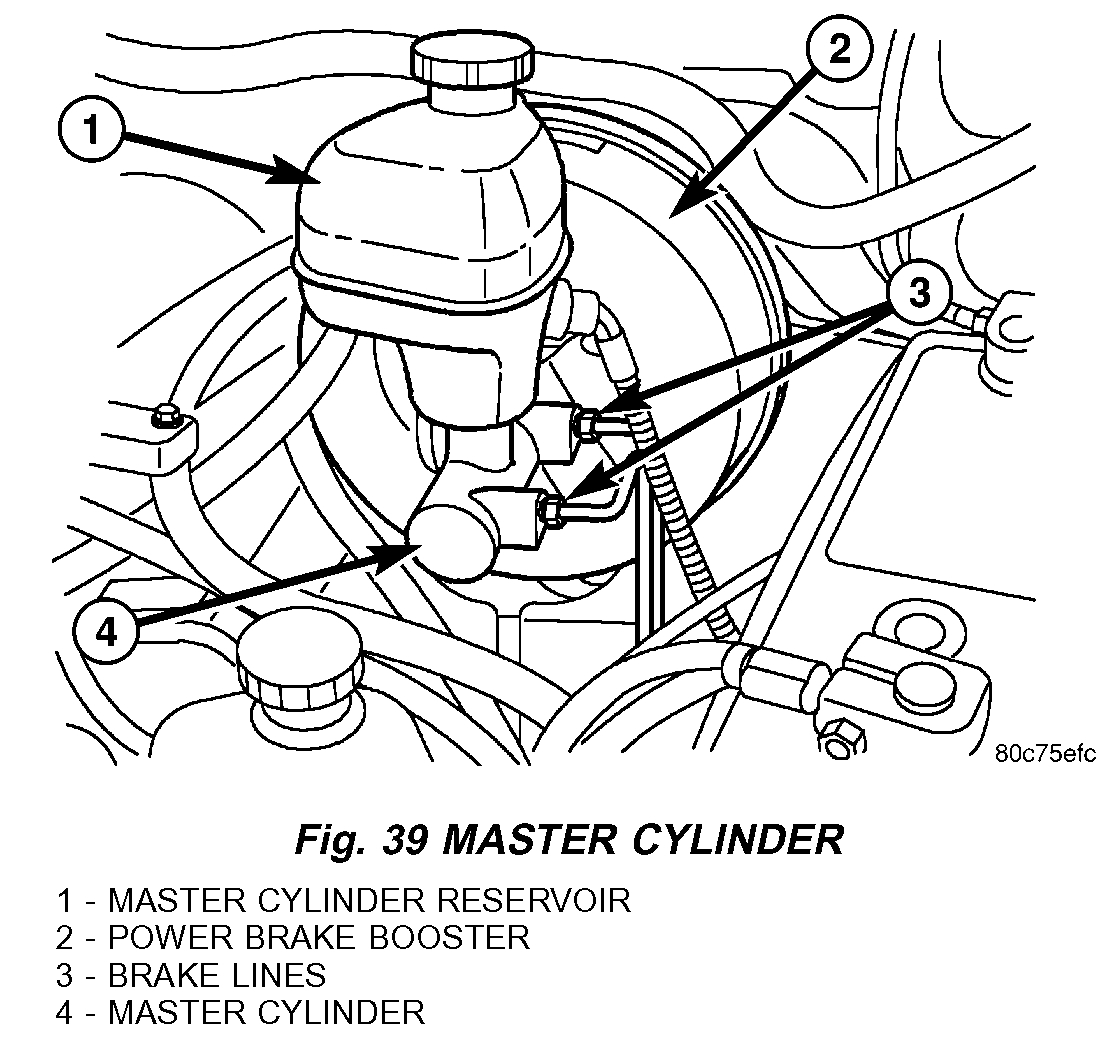

1. Remove the brake lines from the master cylinder.
2. Disconnect the electrical connector for the low fluid level.
3. Remove the mounting nuts from the master cylinder.
4. Remove the master cylinder.
NOTE: Using care remove the master cylinder directly forward in order not to dislodge the output rod from its seat inside the booster.

pic 2
NOTE: Make sure the output rod of the brake booster is in position before mounting of the master cylinder "This position will enable the output rod to enter inside of the master cylinder plunger sleeve during installation". Proper position is obtained when the output rod is centered perpendicular to the master cylinder mounting hole.

Next time they lock up, park on a slight incline, shift to neutral, and crack open the steel lines at the master cylinder. If that lets them release, suspect contaminated brake fluid. If they do not release, open the bleeder screws. If that lets them release, suspect the rubber flex hoses are restricted.
