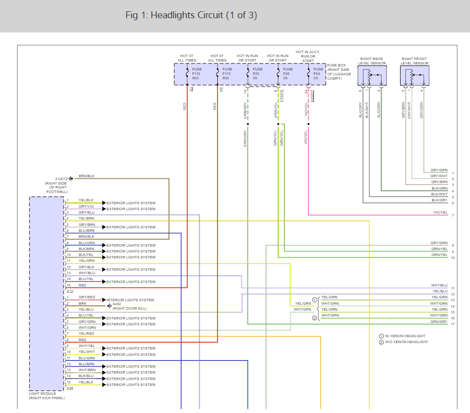

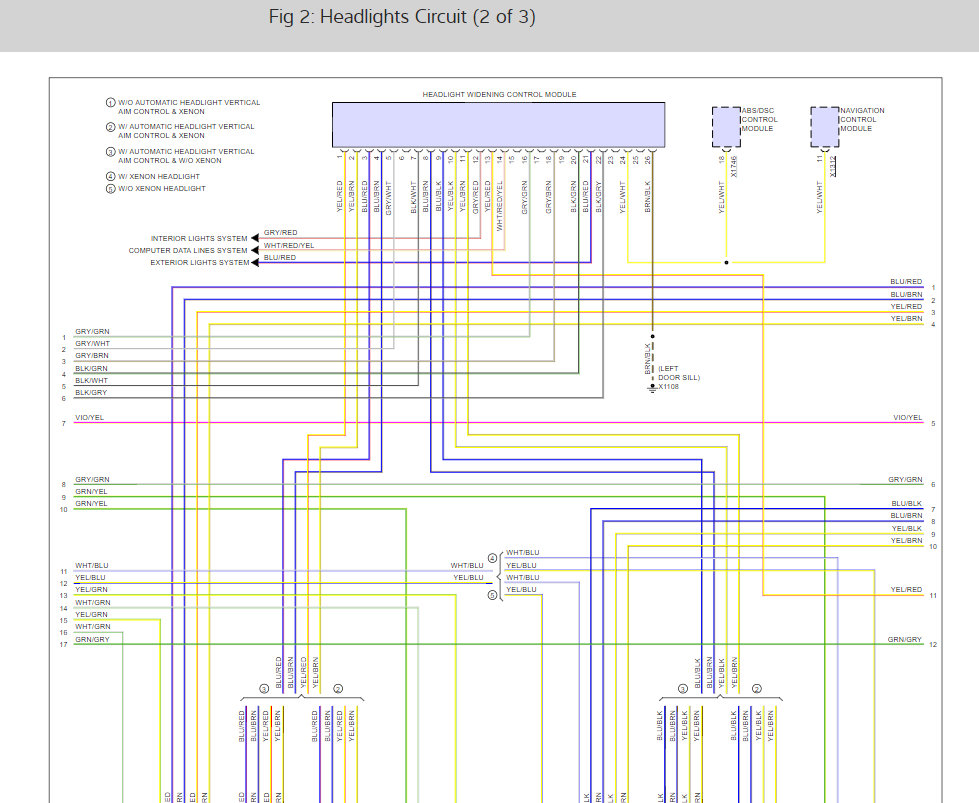

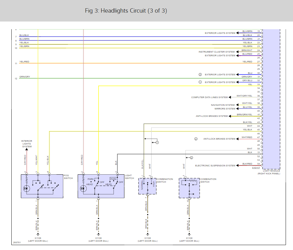

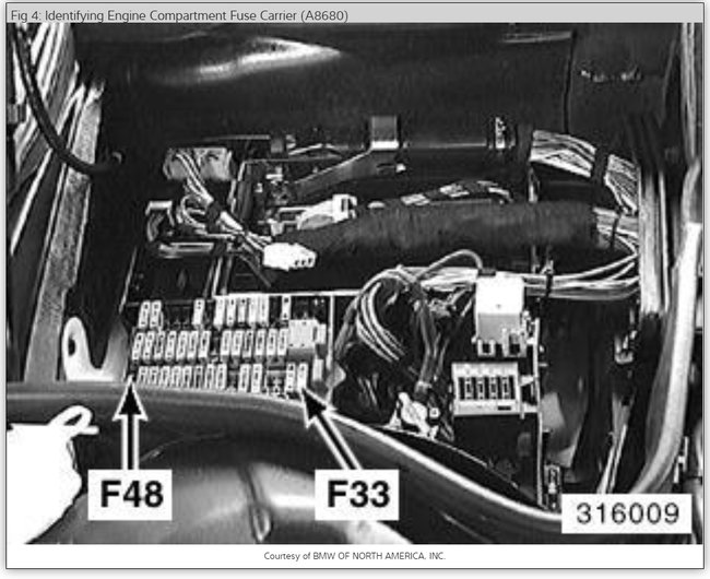

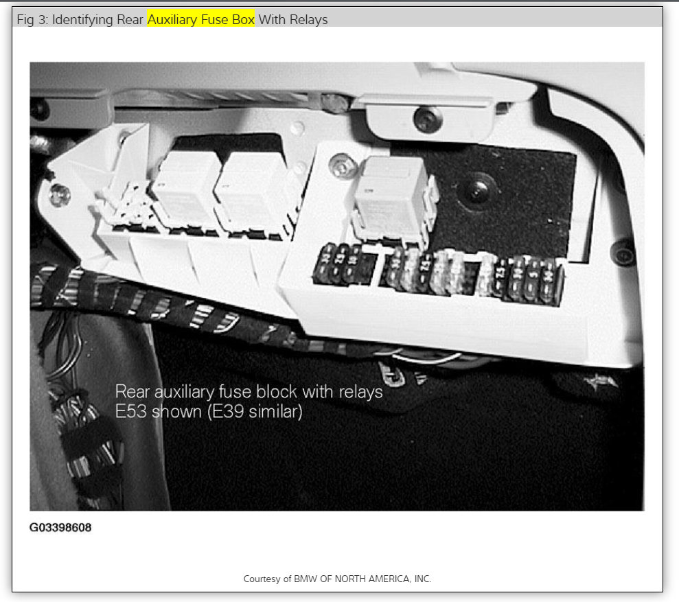

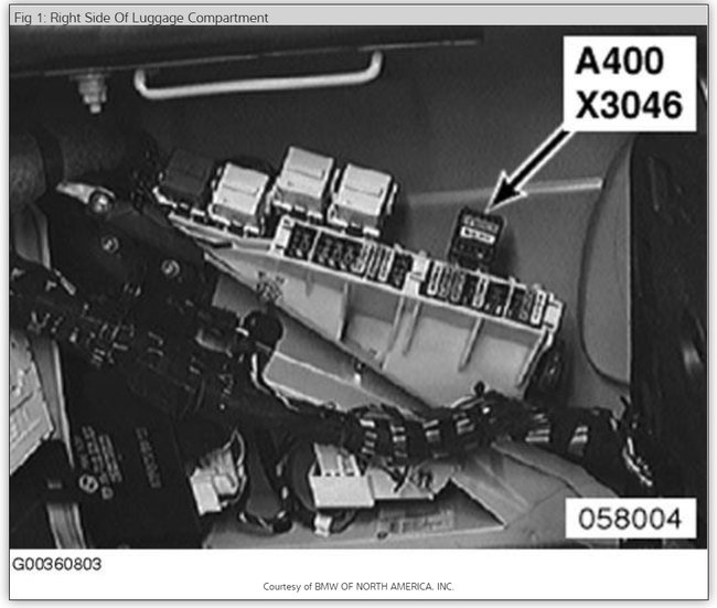

The first thing that comes to mind is the fuse. The fog lights are controlled by the lighting control module which is run by several fuses.
Here are a couple guide to help you see what is up:
and
Fuses by Fuse Number

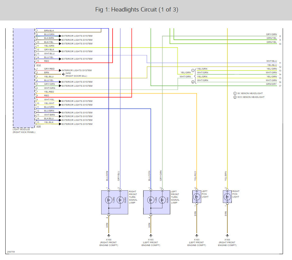

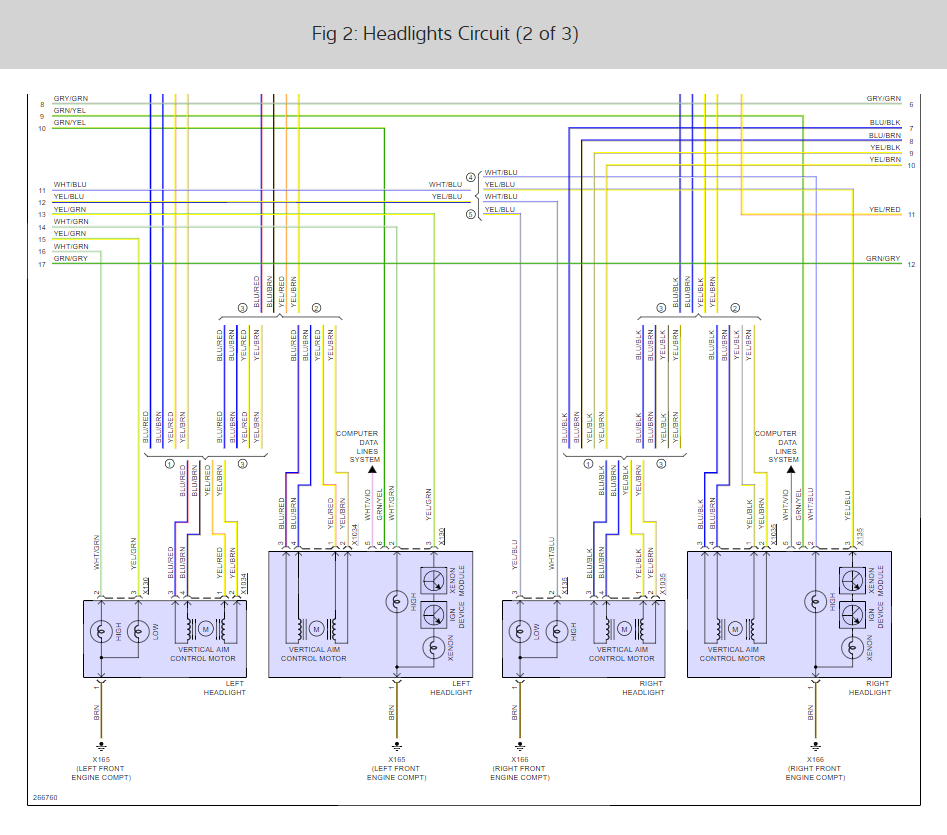

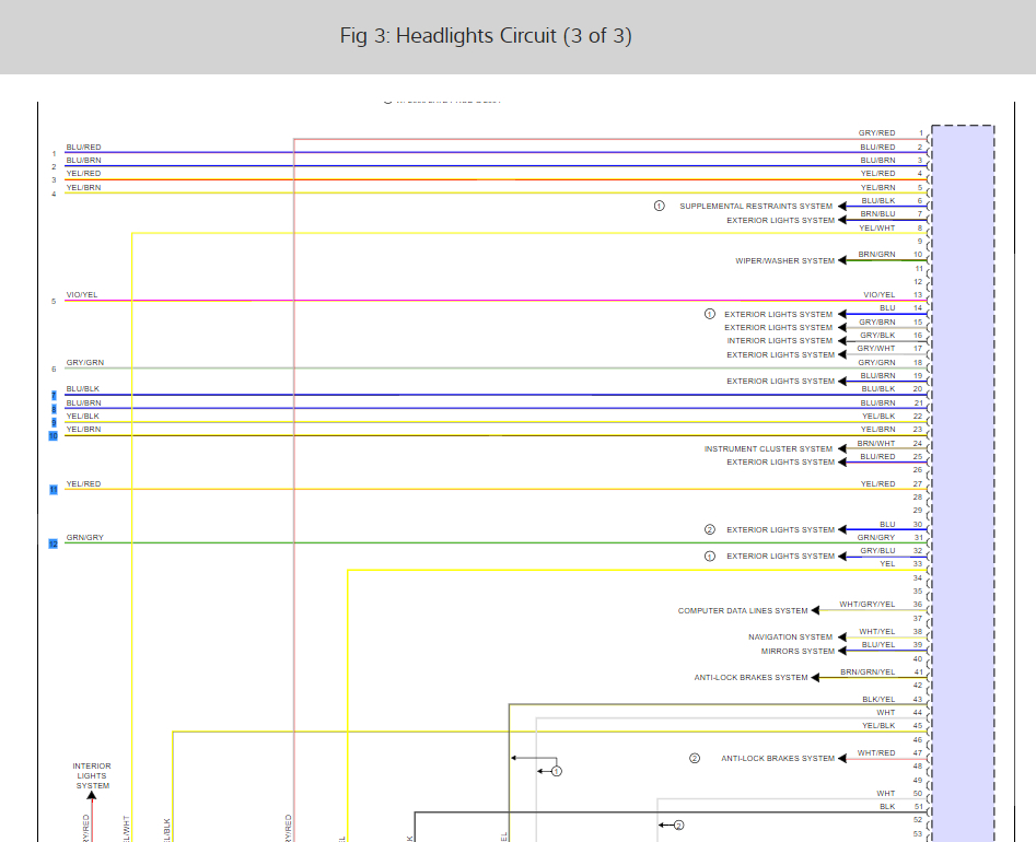

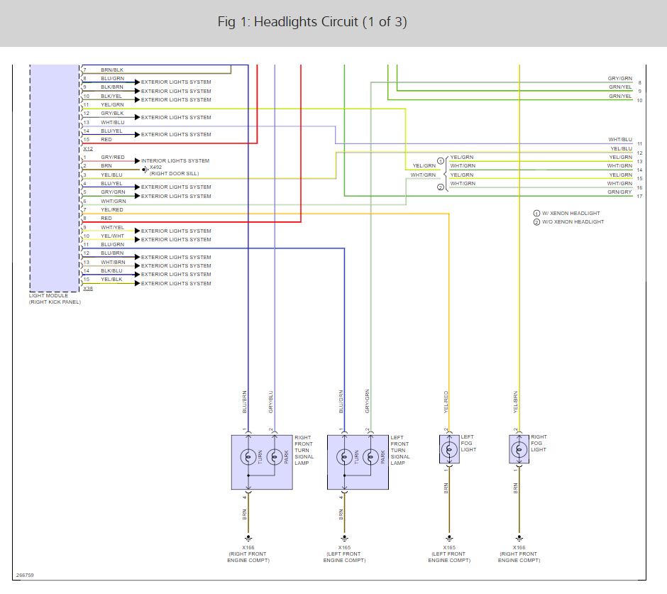

See where the system loose power check out the fog light wiring diagrams and fuse panel identification (below).
