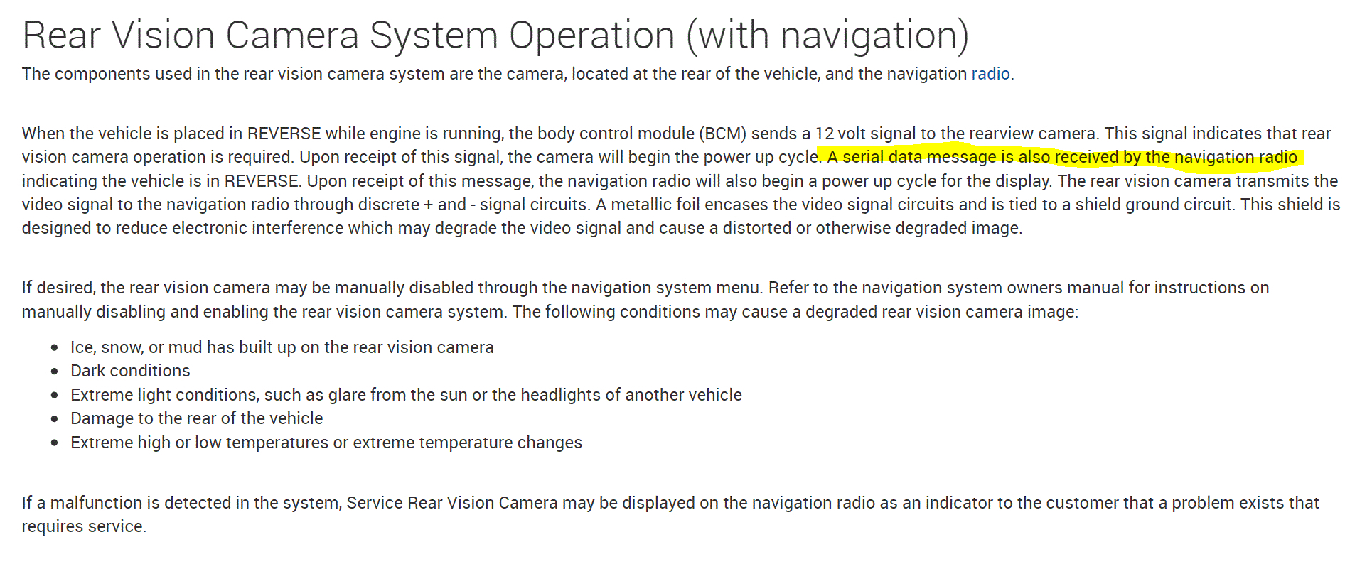

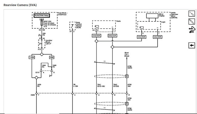

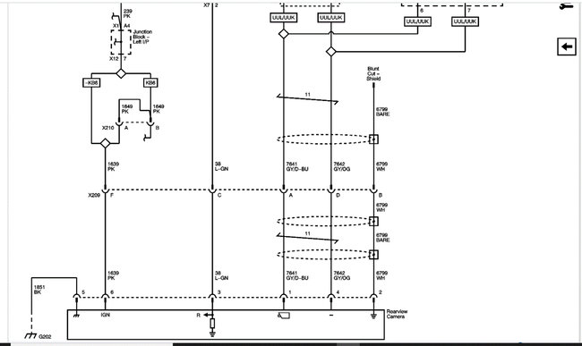

When you removed the radio, you opened the park assist system was opened. The beeping is powered via the radio. If you look at pic 1, I highlighted where it is indicated in the operation of the unit. Also, pics 2 and 3 are the schematic. You can see where the radio is tied in.

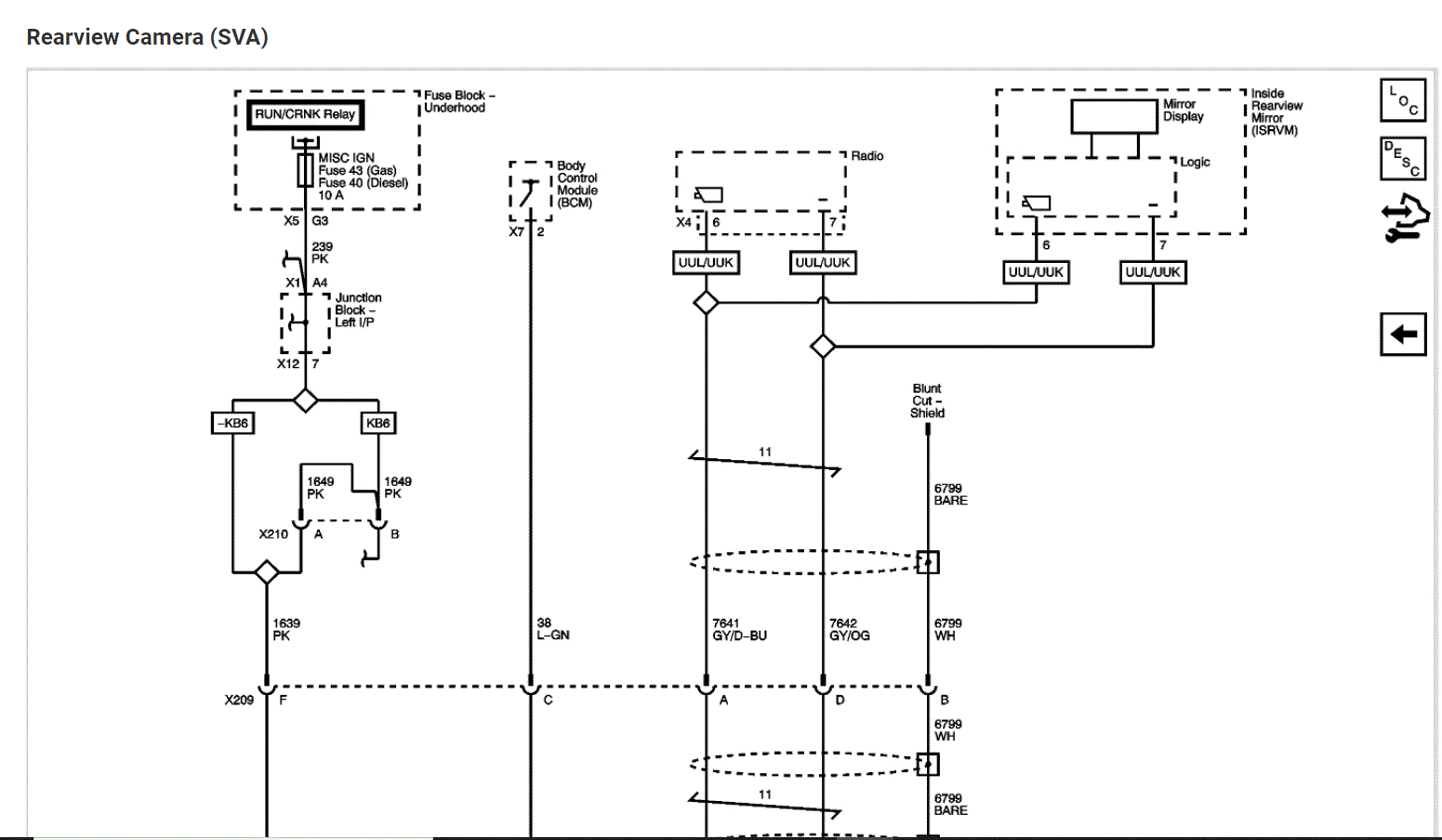

I'm not sure what you are seeing as far as wiring on the new radio. If you look at pic 4 below, I listed the radios that were options in your vehicle. If you tell me which one is yours, I will be able to provide the wiring schematic.
See pics below.
