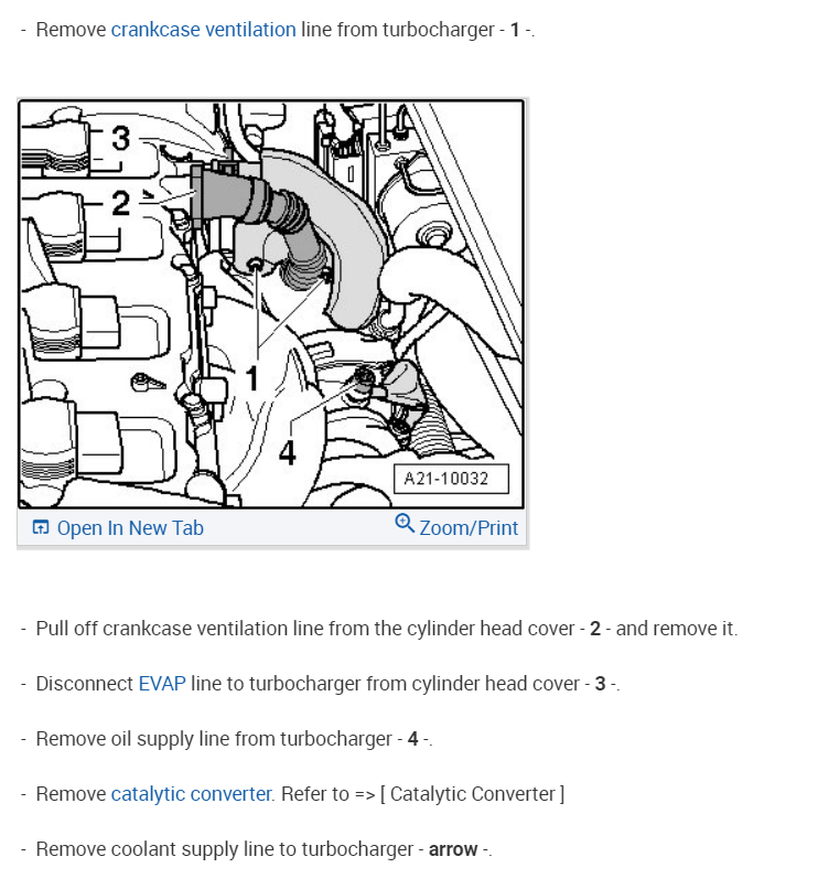

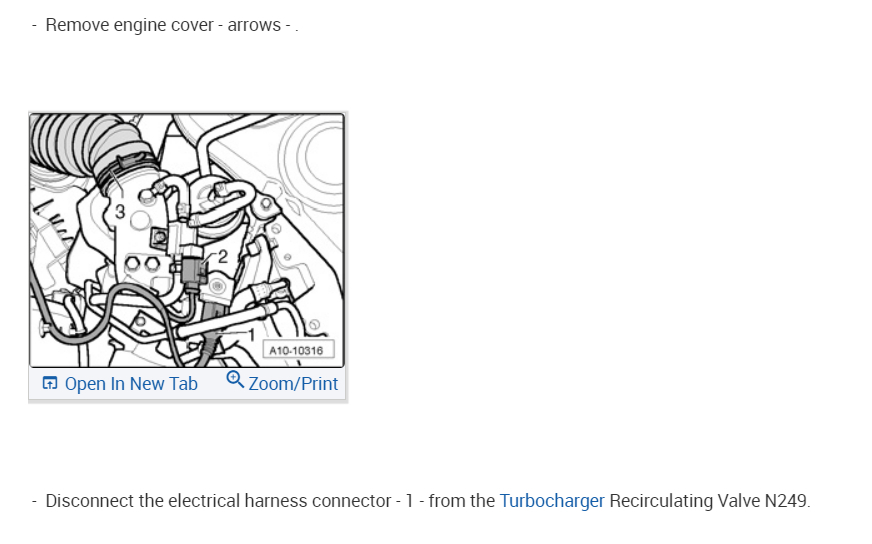

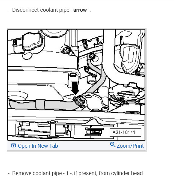

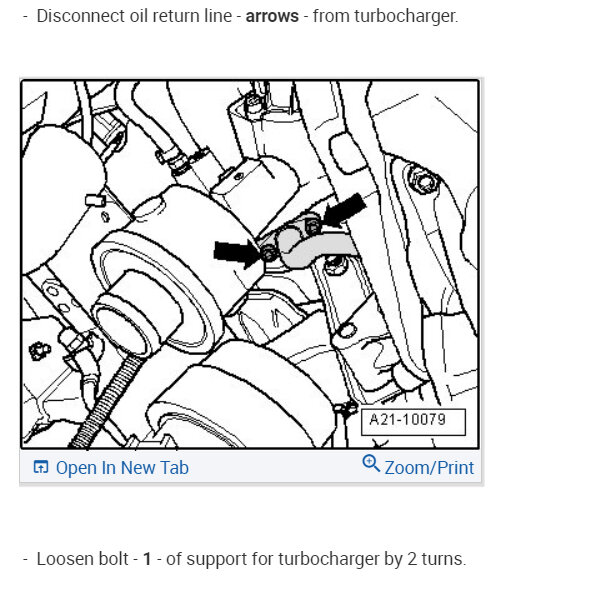

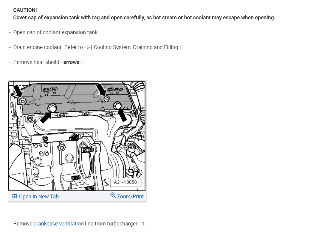

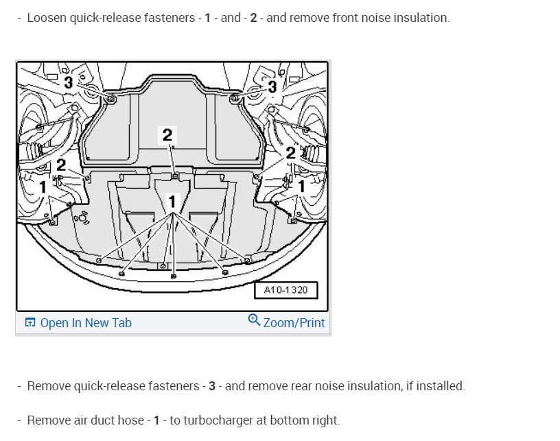

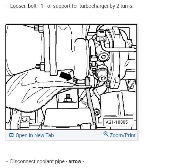

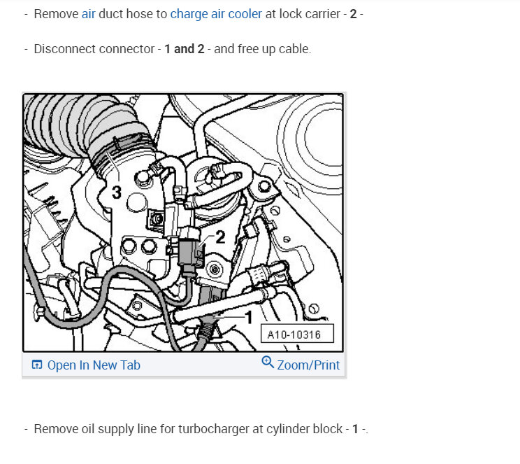

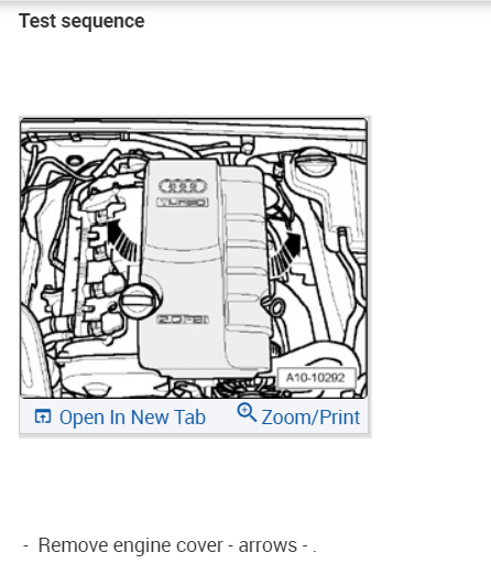

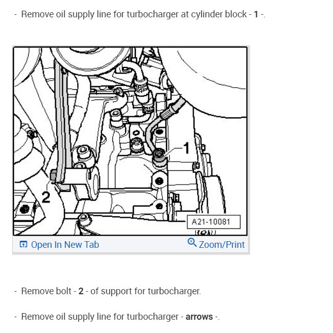

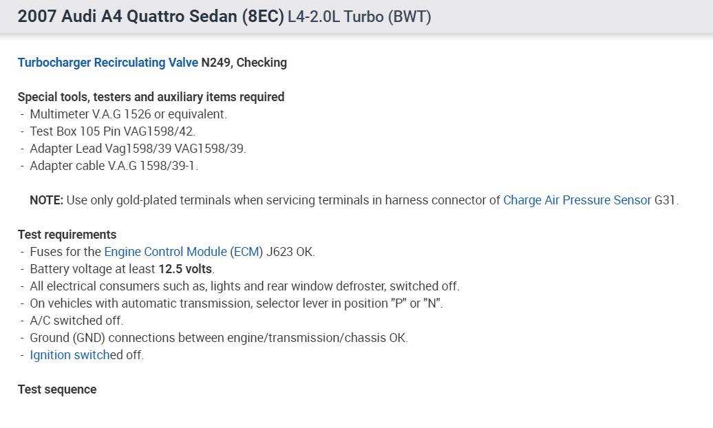

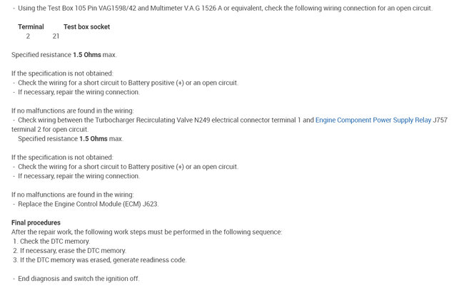

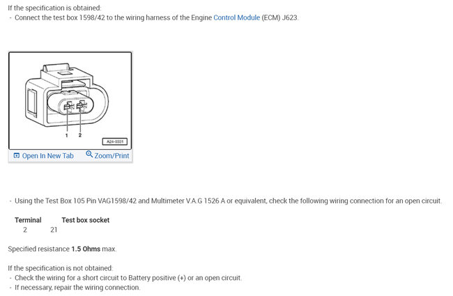

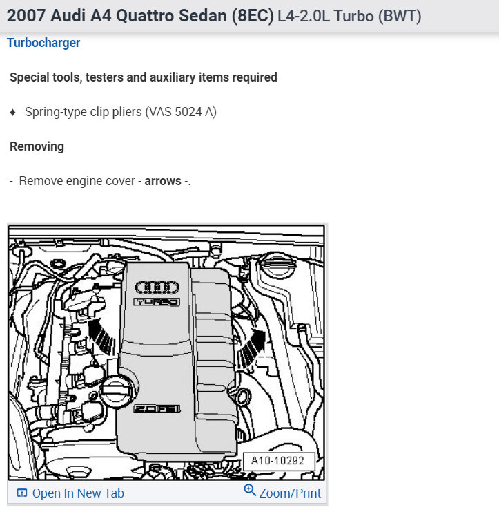

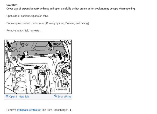

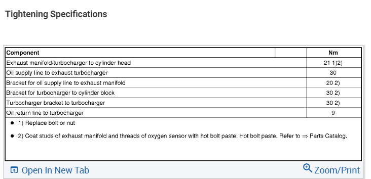

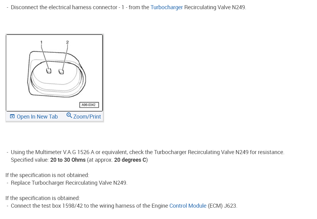

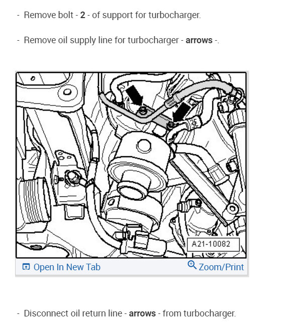

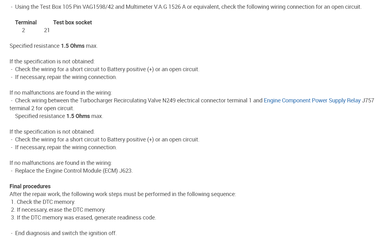

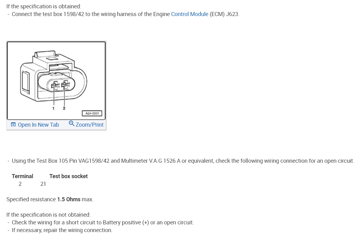

This could be the waste gate not working correctly or the turbo is worn out and needs replacement. Do you have a check engine light on? If so, let's run the codes, this guide can help:

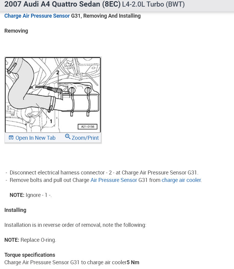

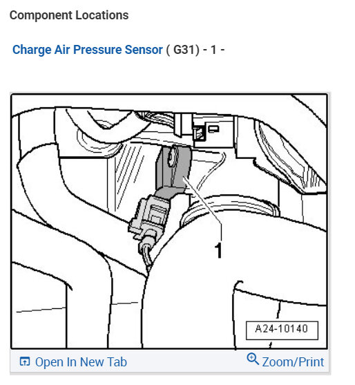

I have also seen the air charge sensor go out and cause this issue as well. Check out the images (below). Let us know what happens and please upload pictures or videos of the problem so we can see what's going on.
Jul 7, 2023 at 11:50 AM
