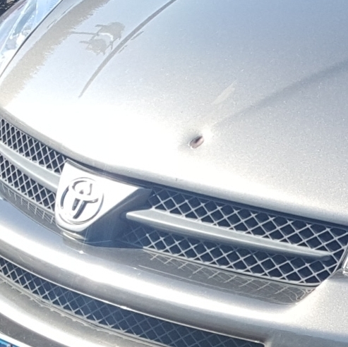

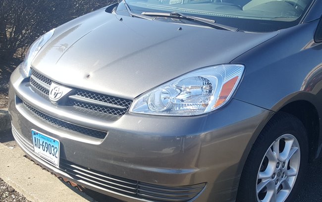

I just fixed and painted my hood on my van. As by the pictures , you can see by the first 2 pics it was a deep dent. The 3rd. picture shows the finished repaired product.
Should I had pulled out the dent with a dent puller and hammered it from the other side of the hood first before repairing and painting it?
The steps I took to repair it were as follows:
1. cleaned out the rust with sandpaper.
2. applied bondo to the dent to level it off and sand it down smooth.
3. applied glazing & spot putty and sand it down again.
4. sprayed primer on top and sand it again.

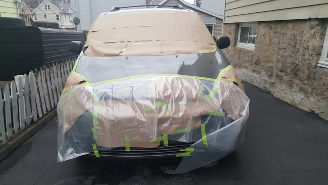

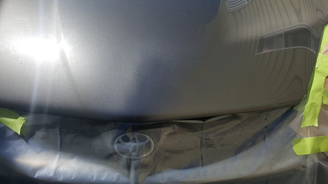

5. masked the car as in the 4th picture below for 2 weeks.
6. painted and clear coated.
Now, can I still hammer out the dent from the other side of the car. In the 3rd picture below which shows the repair done, you can't see the imperfection but up close you can somewhat see the dent a tiny bit.

To be honest, it looks like you did a good job. As far as using bondo, you always want to use as little as possible. When you put a lot on, it is more pron to crack. However, since the dent wasn't too big in diameter, you should be fine.

To echo Joe, it looks pretty good for not being a bodyman. The small imperfection is likely due to sanding, The hood has a rounded profile in that area. When you filled in the ding with the bondo it was softer than the metal. That means it made a flatter area because of the softer bondo sanding away while the metal was acting as a bridge. That is one of those things you only get used to with a lot of practice.

For a DIY job you did better than a lot of the repairs I have seen over the years. Removing a dent like that requires quite a bit of work. The reason is that the metal is severely stretched to form the dent that deep. Once stretched like that it is very difficult to shrink it all back into place. To do that repair with minimal filler would require that the dent be beat out until it was in effect reversed. Then you would work the steel to shrink it back to the original shape. Not something you want to do without a bunch of practice. Plus that would be reserved for a car where a replacement panel would not be available or replacement could hurt the cars value. In my old shop I would likely have used a spotter gun to lift it as much as possible, then filled it or just replaced the hood, a new replacement for that van is about $100.00. Then you would scuff it, shoot on the color and clear and ship it.

if I oversprayed an area, how can I fix this, by wet sanding with 1500 to 2000 grit sandpaper?
Mar 27, 2020 at 2:38 PM
You can buff it with a very fine grit polishing compound. That should remove it. Or, if you want to wet sand with 2000 until the shine is gone, that will work too, but it will require you to buff the color and smoothness back to the finish. Most times, polishing compound and a buffer will do it. If you plan to wet sand and buff, don't use anything more aggressive than 1500. It may take a bit longer, but it will be much easier to bring back the finish you want.
