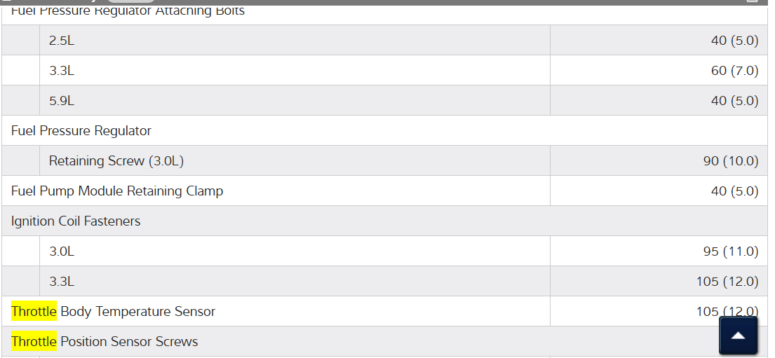

Need to replace the four bolts holding the fuel injection throttle body to manifold. where can i get information on the specs and where to buy them? i live by Tulsa OK.

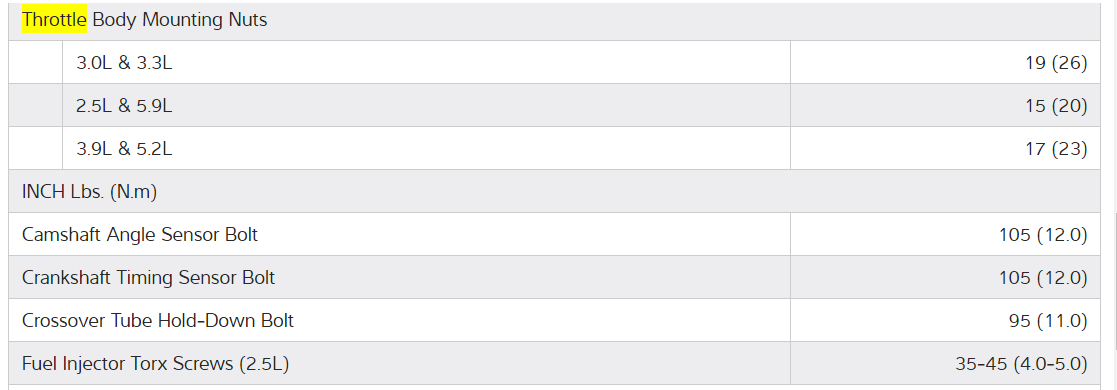

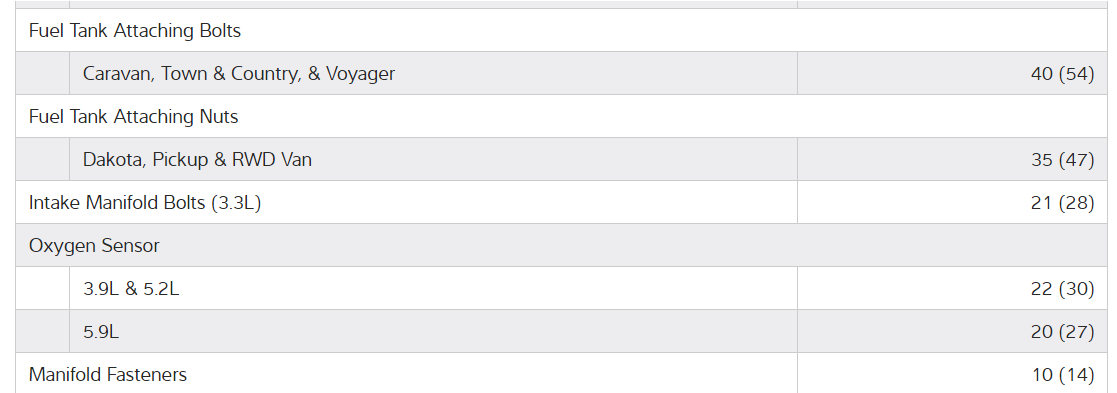

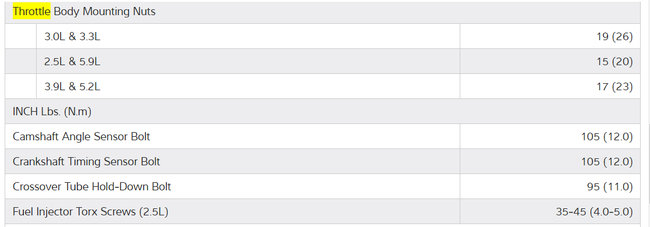

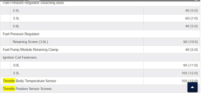

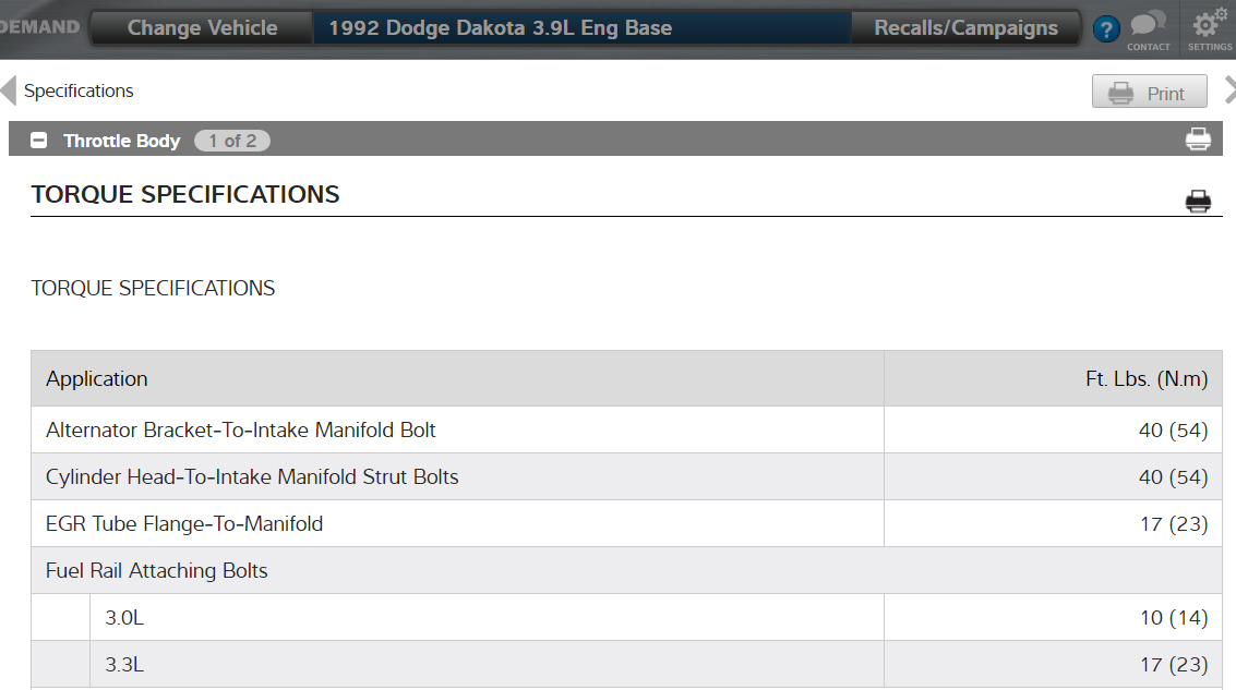

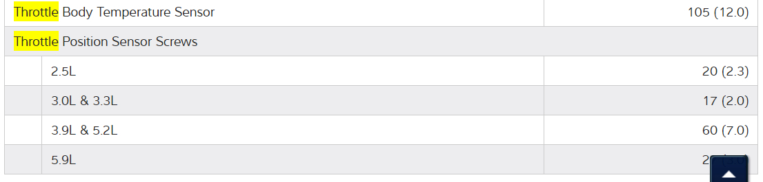

The bolt size you are looking for is M6X1.00X45.00. The best place to buy them at be at your local hardware store. Most hardware stores have a great fastener section and you can pick them up fairly cheap. I have also included in the diagrams for you down below all the torque values for your vehicle to make sure that they are torqued down tight and to specs.
Please don't hesitate to ask if you have anymore questions. That is what we are here for.

Who can i contact to get the information i need. please help.
