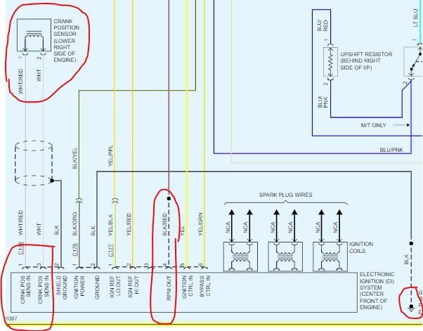

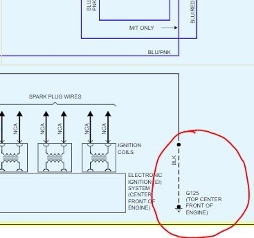

The problem occurs when the car is hot. depress the accelerator too far and the car bogs down. feels like its starving for fuel. rpm's simply top out and the car loses power, especially when going uphill. seems to be a bit better with momentum but if the pedal is depressed.. vrooom but going nowhere slowly back off the accelerator and hit it a few times it will shift up and begin to accelerate as long as i don't give it too much gas. if i go too far it bogs down again. through any and all gears.
Fuel pressure is 55 psi. Changed the filter twice anyway. First time discovered the one on the car was installed with flow pointing to tank. i figure someone just stuck a screwdriver through it before then..
I have replaced the coils did find one out of range and replaced the ignition module. Thing of that is i have four modules now for this car and all four have different readings. i don't know if one or all is good or not.
I also changed the wires and plugs..did a trans service and fixed the transmission oil cooler fan and exhaust leak in the resonator just under the transmission oil pan that was cooking the transmission. old transmission oil looked like dark grape juice compared to the koolaid clarity of the Dextron i replaced it with. i also found and repaired a host of broken or cracked vacuum vacuum lines and for the heck of it replaced the timing belt including tensioner and water pump prior to this issue developing.
