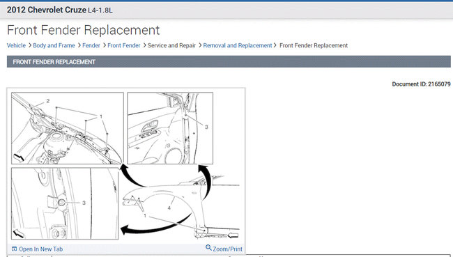

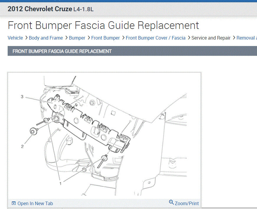

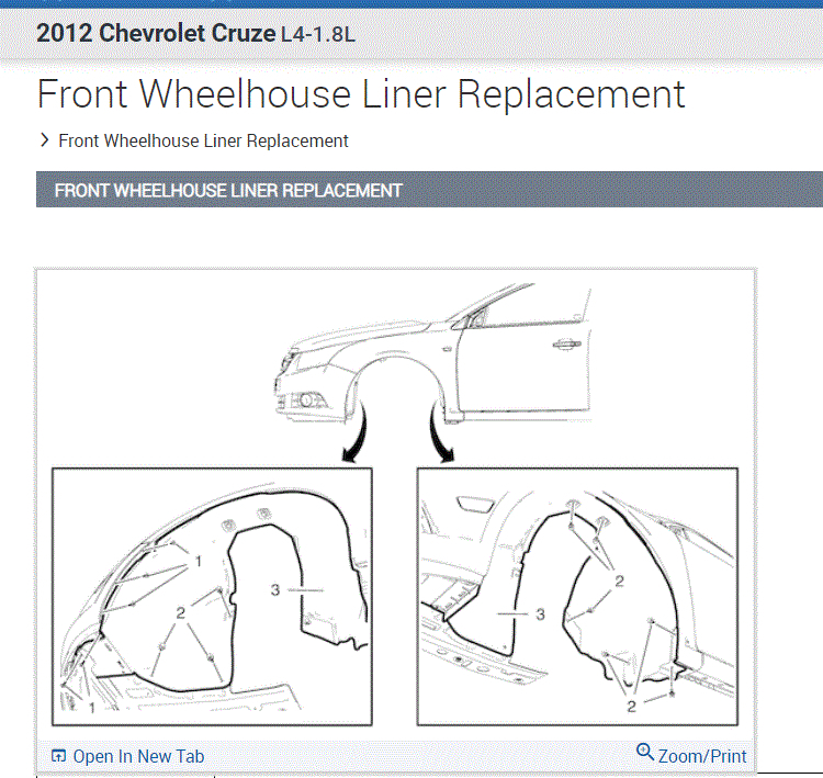

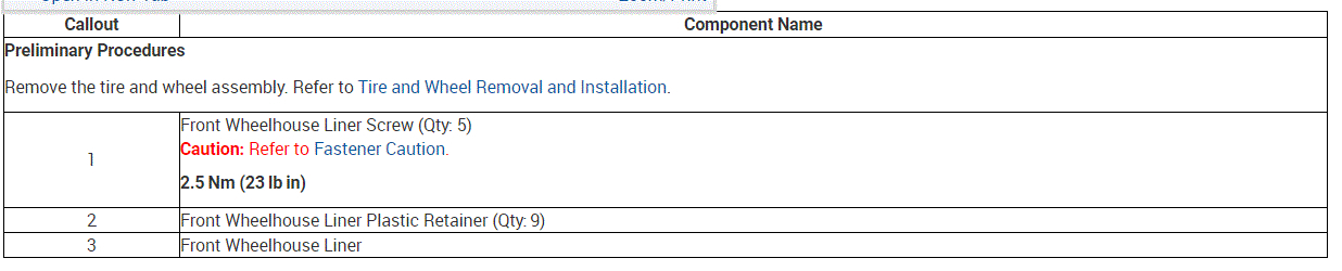

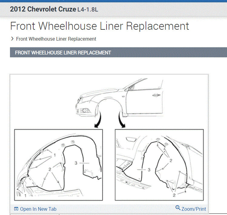

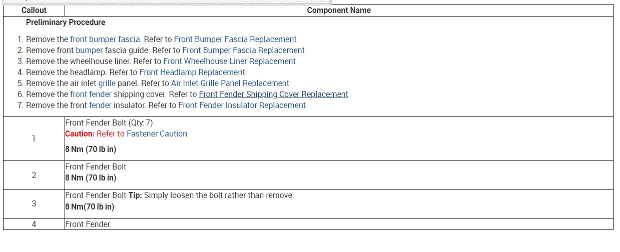

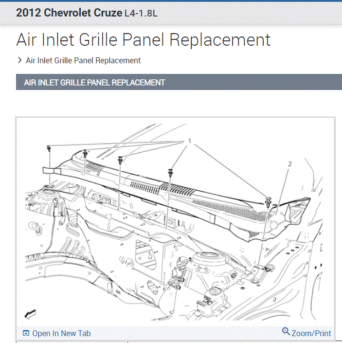

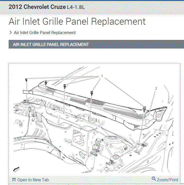

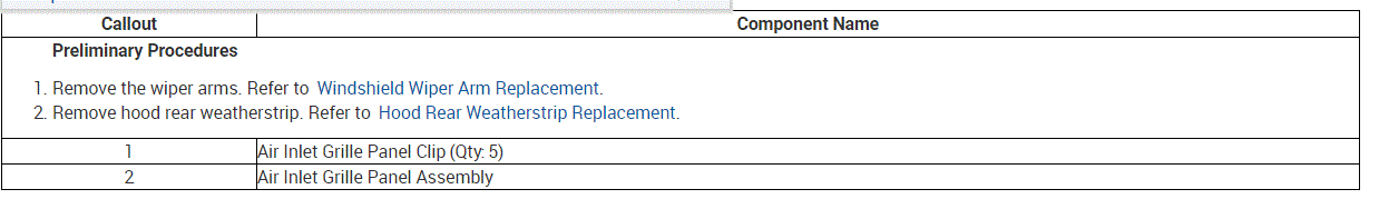

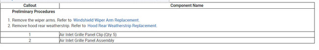

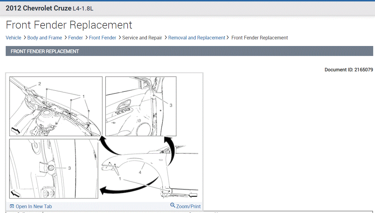

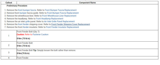

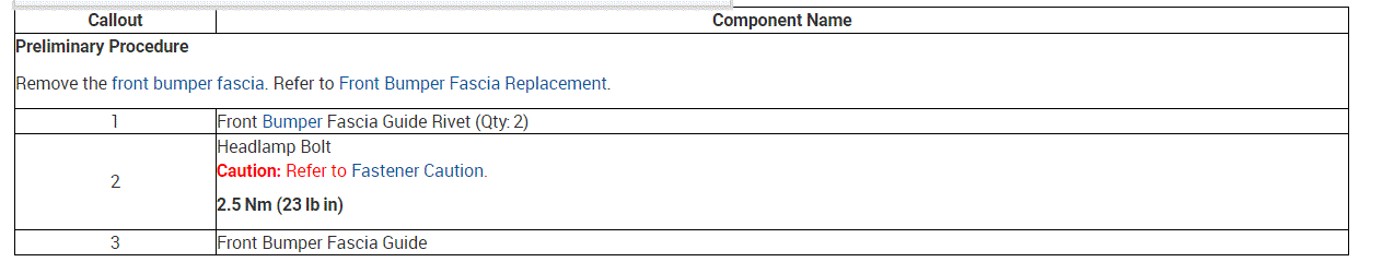

To remove and replace a front fender will require other things to be removed. If you look at the first two pics below, they provide the directions and pic related to fender replacement. The remaining pics and directions are for the other components related to this procedure.
I hope this helps. Let me know if you have other questions.
Again, check out the pics below for directions.
