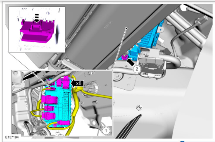

I’ve been having a strange issue where my blind spot monitoring, passenger window controls, and center climate control panel panel will not come on. The lights on the center console flash for a second when the car starts and previously the whole system would work normally for a time if I unplugged battery and BCM fuses and reconnected them after some time. It seems my body control module has gone bad but I cannot locate the part number or even location of the module when searching online. I would appreciate any guidance on this.

Yep, it does sound like the BCM is is going out and is good for a while once rebooted which is common. But I would do a CAN scan to help confirm the issue, this video will show you how
CAN SCAN - https://youtu.be/u-4syLc-ifQ
Here is the location of the BCM in case you need to swap it out, Also I would use these guys for the rebuilt BCM.
https://www.flashmastersecm.com/
The location of the BCM is under the dash on the drivers side. Check out the images (below). Let us know how it goes
