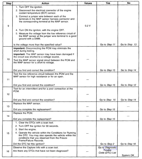

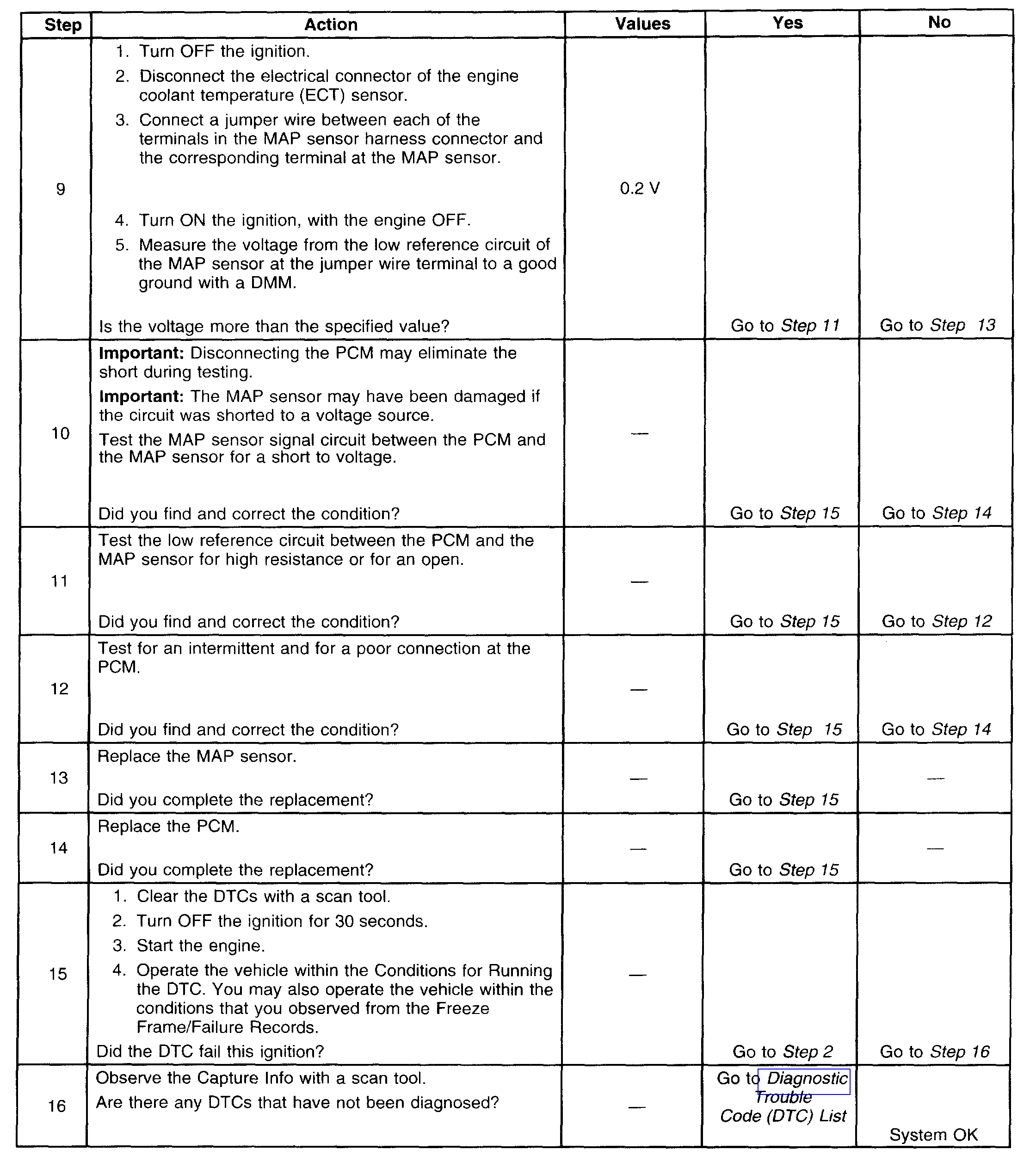

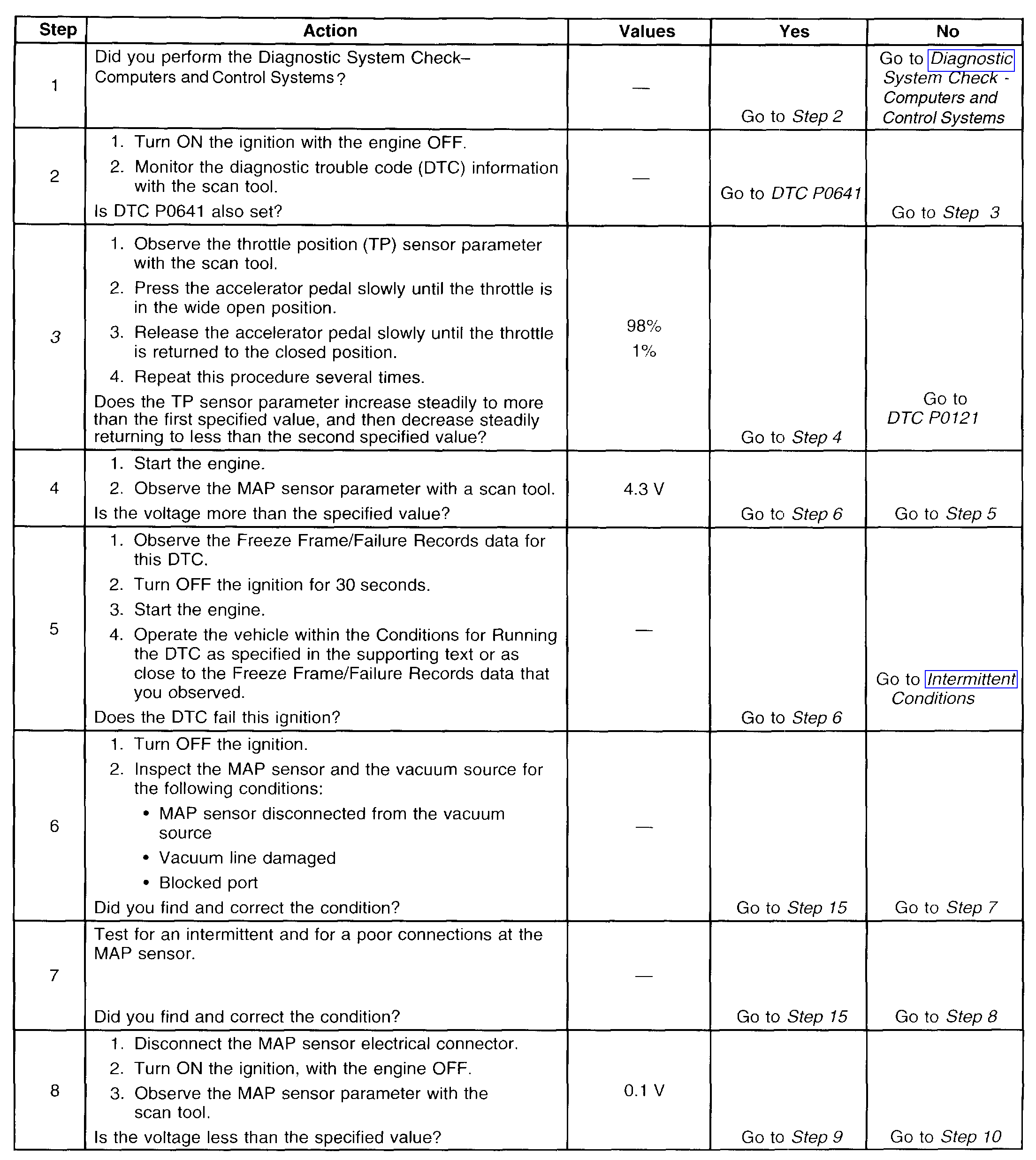

The code is related to the map sensor. Have you checked voltages to it?
Don't laugh, but this could even be related to a faulty coolant temp sensor (ECT). Do you have a live data scanner? If you do, check to confirm the ECT is close to the temp you feel the coolant would be. Also, the throttle angle sensor can be an issue as well.
As far as the MAP, again, you need a live data scanner. For the code to be set, the PCM detects that the MAP sensor voltage is more than 4.3 volts for 3 seconds. So the voltage needs to be checked.
Also, the computer is designed to identify the failure in the event it happens more than once. If the diagnostic reports a failure on the second consecutive ignition cycle, the control module records the operating conditions at the time of the failure. The control module writes the operating conditions to the Freeze Frame and updates the Failure Records. So again, if you have a scanner, I would suggest looking at freeze frame information to help identify where the failure begins.
I don't know if you have the scanner to do these checks, so let me know. Also, I attached a flow chart to help diagnose this code. See pics 1 and 2.
If there is something you can't see on the chart, let me know. I will watch for your reply.
