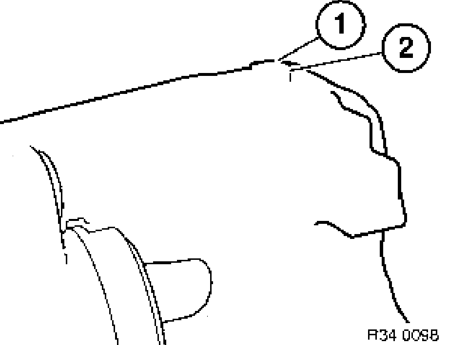

Remove wheels.
pic 1
Lift out retaining spring (1).
Left:

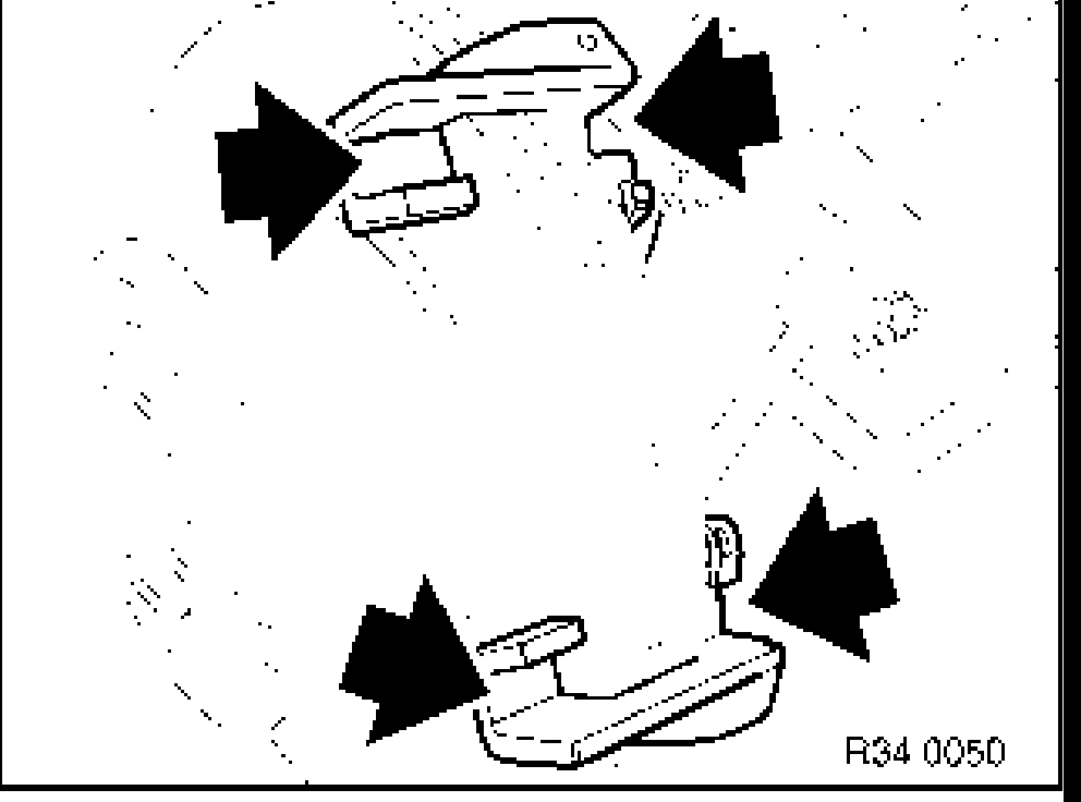

Disconnect plug connection for brake lining wear sensor.
If necessary, replace brake lining wear sensor.

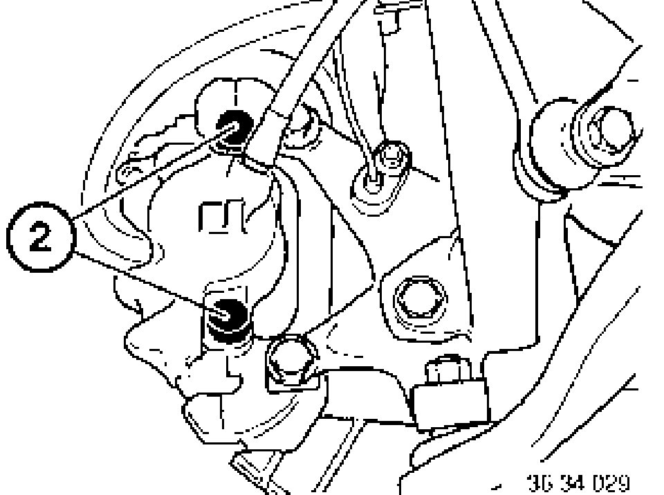

Remove plastic plugs (2).
pic 3
Unfasten guide screws (1) and lift out brake caliper towards rear of vehicle. Do not allow brake caliper to hang from brake hose, risk of damage to brake hose.
Installation: Only clean guide screws; do not grease.
Check threads.
Replace all guide screws which are not in perfect condition.

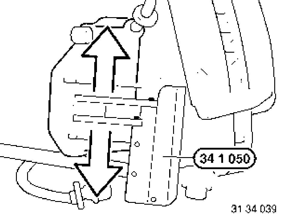

pic 4
Turn piston fully back with special tool 34 1 050.
Important:
When turning back the piston, watch the brake-fluid level in the expansion tank, as overflowing brake fluid will destroy the paintwork.

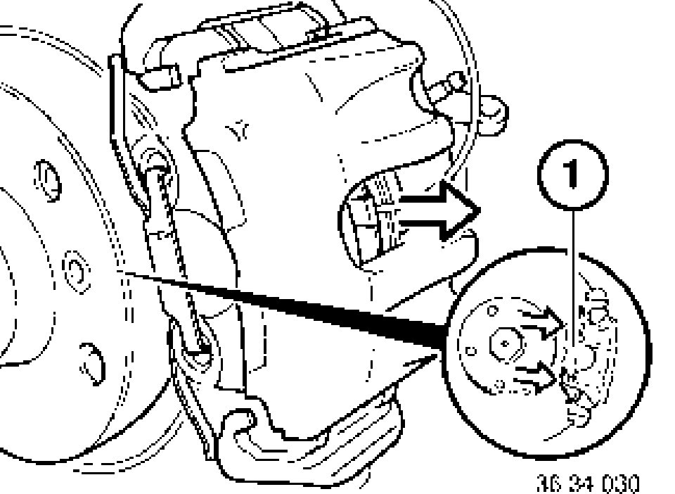

pic 5

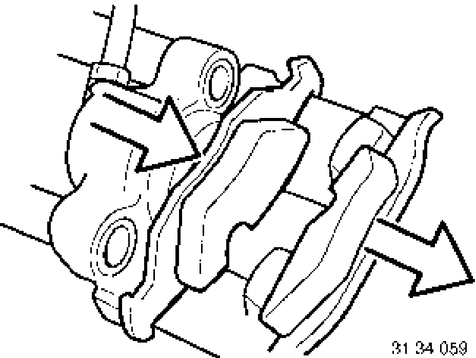

Remove outer brake lining.
Inner brake lining is located with its spring in the piston.
Important: Mark any worn brake linings.
In the event of one-sided brake lining wear, do not change brake linings round.
New brake linings may only be installed if the brake disk thickness is greater than or equal to the minimum brake disk thickness (MIN TH).
Observe minimum thickness of brake linings,
Clean brake linings.
Do not grease backs of brake linings sleeve.

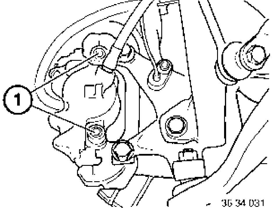

pic 6

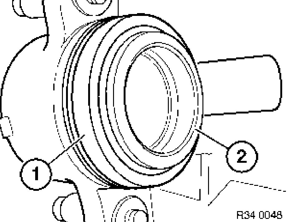

Check dust sleeve (1) for damage and replace if necessary.
Clean contact face (2) of brake piston and apply a thin coating of anti-squeak compound.
Anti-squeak compound, refer to BMW Service Operating Fluids.
Important: Dust sleeve must not come into contact with anti-squeak compound as this may cause the dust sleeve to swell.

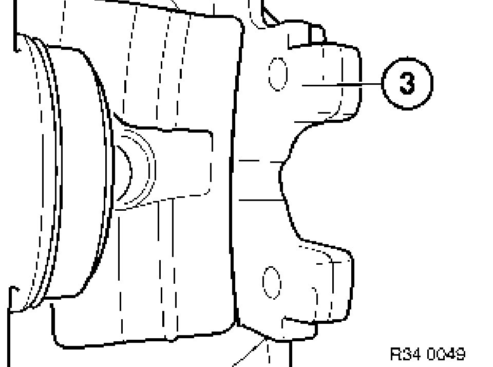

Clean contact face (3) of brake caliper and apply a thin coating of anti-squeak compound.
