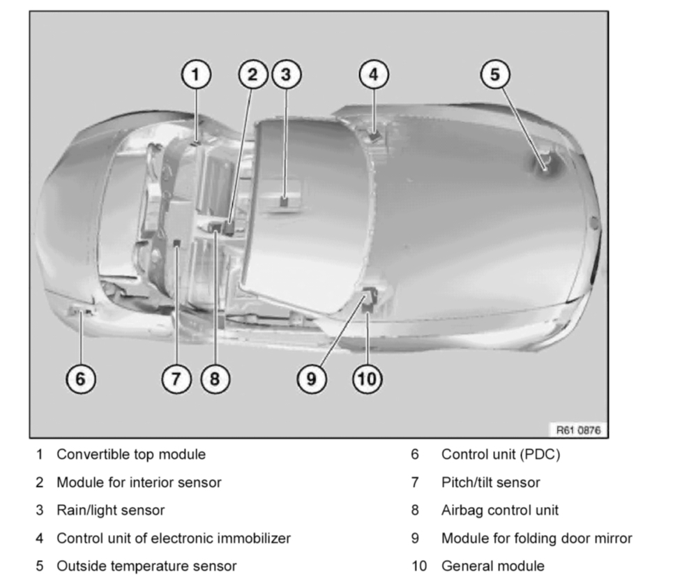

It sounds like the general control module has gone out (bcm) I would remove the electrical connectors and plug them back in to hopefully fix a bad connection. If that doesn't work I would try a used/rebuilt unit. Here is the location in the diagrams below
Check out the diagrams (Below). Please let us know what you find. We are interested to see what it is. Cheers

I had this problem, I was the general control module It cost me $340.00 at the dealer but I will try a used one next time.

Can you give me an idea of the unit that you installed? I am having trouble figuring out exactly what module you replaced, I have the same issues.
Mar 21, 2021 at 11:26 AM
it is #10 in the diagrams above click to enlarge the image so you can see the location. Please let us know if you need anything else to get the problem fixed.
