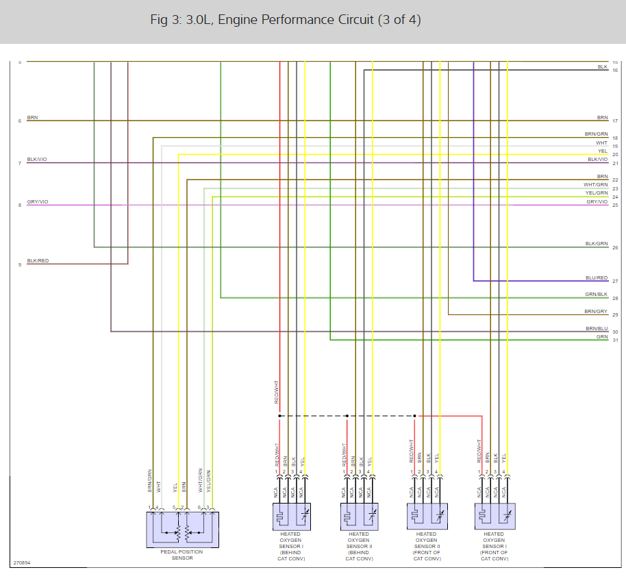

Heater control circuit low is a shorted O2 heater circuit. Start by tracing the wires from the sensors up to the computer. Most likely item will be that they are hitting the exhaust or engine and have melted/chaffed through and are grounding out.

Do you have twelve volts at the red wire/white stripe on each sensor?
Check to see if the brown wire is grounded with the key OFF.
Next connect a test light between the brown and Red/white and turn the key on.
Do you have a scan tool that can command the O2 heaters on/off?

The first codes you had (P0036, P0056) both indicated a problem with the heater control circuits. Then after the exhaust and changing the sensors you now have P0037 and P0057, Both of those codes still indicate a problem with the heater control circuits, this time it's low voltage.
The battery voltage should be the same to all 4 sensors as they all use voltage from the same fuse. The heaters are turned on/off by the PCM using the Brown wires to ground them. The codes say that the voltage the PCM expects to see on that wire isn't correct.
Were the sensors you used OEM units or after market? It's possible they are just enough different that the PCM thinks they are bad, even if they are working.
BMWs can be temperamental like that. If the OEM sensor is 4 ohms and the new sensor is 5 ohms the PCM will see a lower voltage then it should. Even though the heaters are working you will get a code.

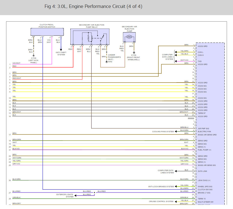

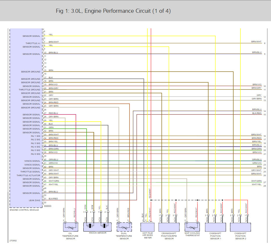

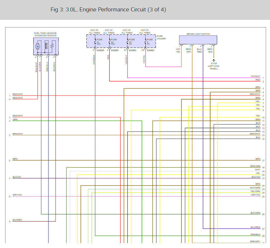

I was going to suggest the same thing its time to check the wiring. Here is a guide to help you see what you are in for and the engine wiring diagrams (Below) so you can get the job done.
