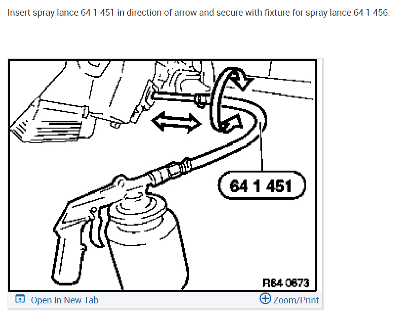

I can hear water sloshing around under the glove compartment. i believe it is the air conditioning condensation not draining. i think it might be clogged, bit do not know where the drains are located to check?
Nov 8, 2008 at 4:43 PM
DOCHAGERTY
  • 9,603 POSTS
The drains are visible from underneath the vehicle and are located at the front of the transmission hump. A little puff of compressed air in the drains should do the trick.
Nov 9, 2008 at 10:58 AM
Yep, this video can help you find the tube and unclog it.
https://youtu.be/q9_MZiS2_NE?si=t5AFjJUKxGpbe-TH
