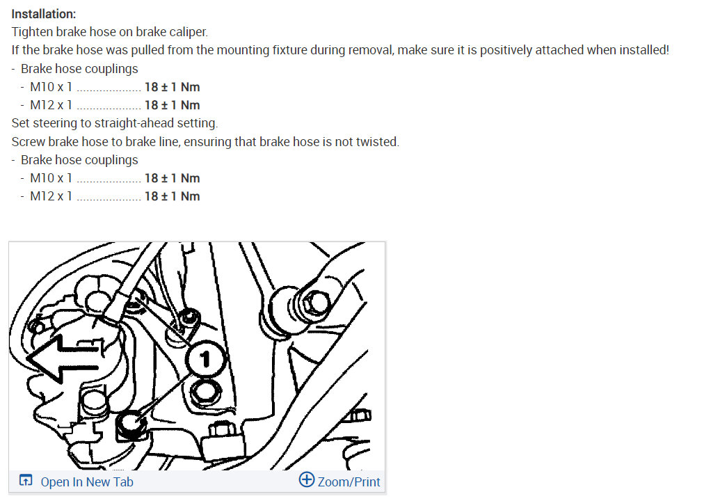

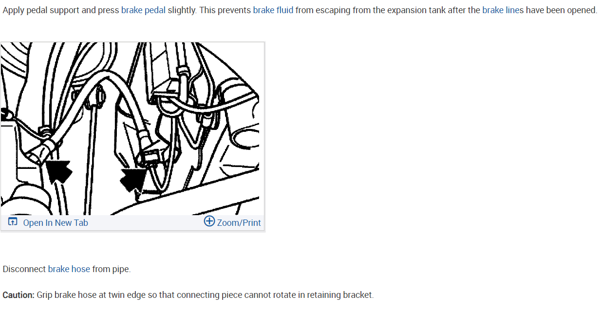

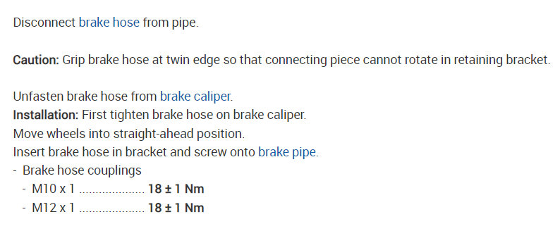

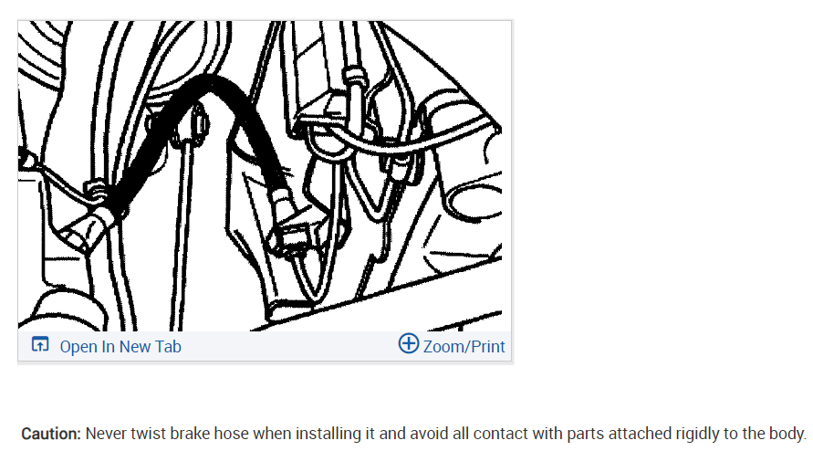

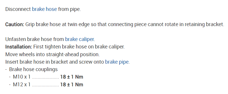

This is common when the brake flex hose needs to be replaced or the caliper slide is frozen. Here is how to swap the parts out so you can re-bleed the system.
