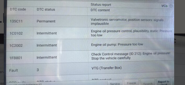

Hello, I just bought this BMW and have quite a few codes that I pulled from the computer. One in particular that I am concerned about is this 135C11 code for the valvetronic motor.
What would be the process to correct or fix this issue?
Can it be reset? Or is there something that can be done to correct the issue without having to replace it?

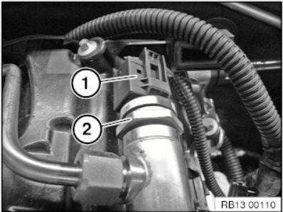

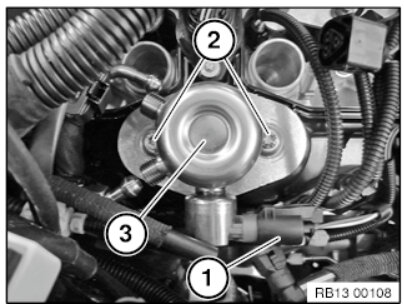

So this is telling you the high pressure fuel pump cannot keep up or the fuel pressure sensor is going out.
Code 135C11 - DME: Fuel pressure too low during cold start
I would try the sensor first because they have a high failure rate, and if that doesn't help you will need a high pressure fuel pump, also check the cam lobe once the pump has been removed, there is a chance the camshaft lobe is worn out FYI. Here is how to change the sensor and HPFP. When you change the parts out be sure to loose the fuel line to release the fuel pressure slowly. Check out the images (below). Please upload pictures or videos in your response

I attached a photo of the code. So, even though it says “valvetronic servomotor position sensors signals implausible” it really means “Fuel pressure too low during cold start” ???
Aug 1, 2025 at 10:13 AM
That is a general code that is telling you one of the sensor is giving back information that is not viable. which will be the oil pump control solenoid as per the other codes.

That is all they give us, I would crack a fuel line to relieve the pressure on both high and low side. Also you can upload images so I can see the vital parts and I can tell you if they need replacement. I would replace the HPFP because they have a high rate of failure.
