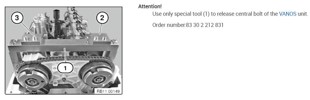

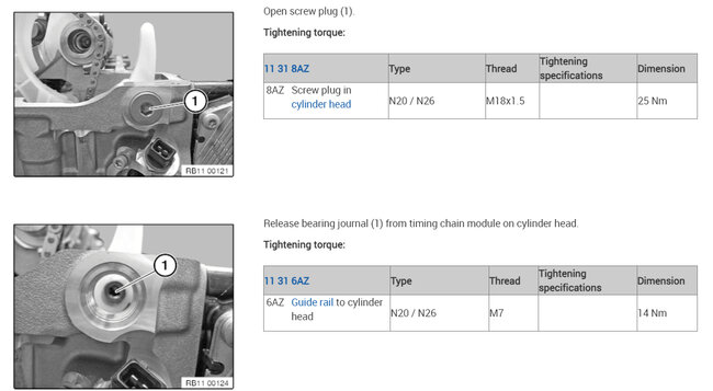

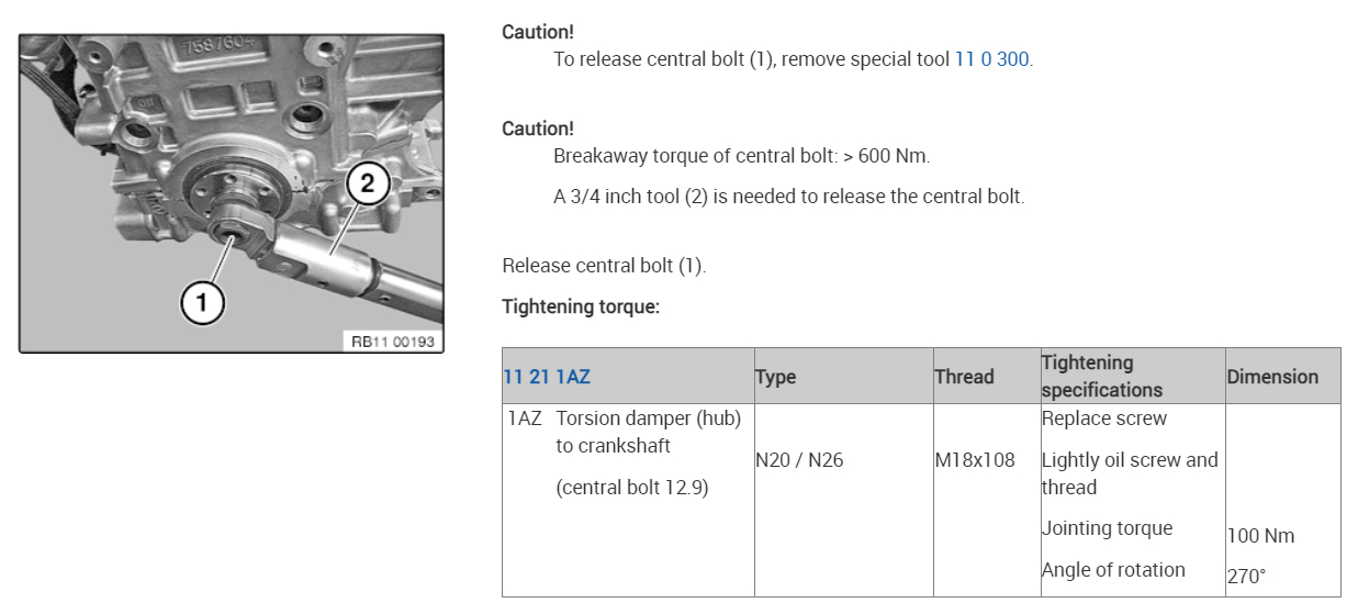

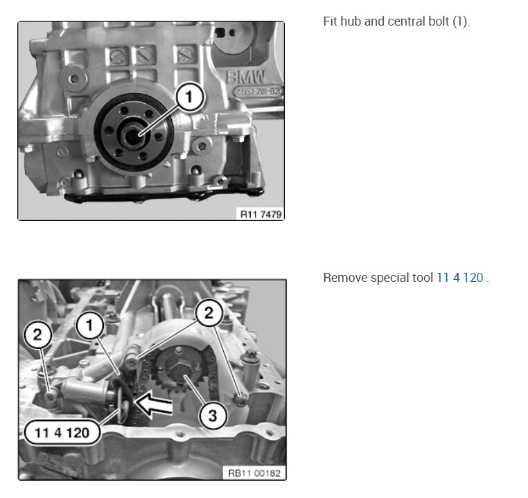

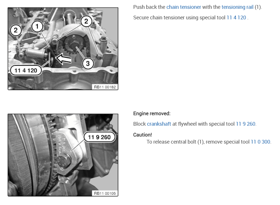

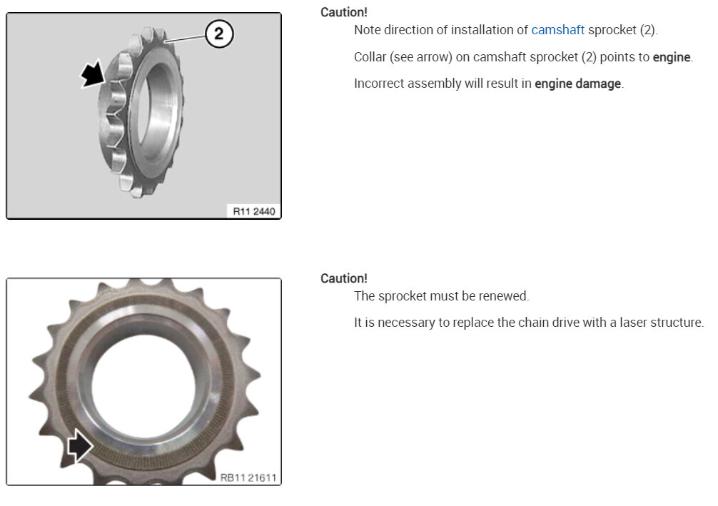

When I received this vehicle, it was not running. The diagnosis given to the owner was a catastrophic turbo failure. Upon inspection the only problem that was obvious was the timing chain. I have replaced the timing chain. The timing chain was still intact; however, the guides were in pieces. After this repair I discovered the turbo had bad oil seals. I replaced the turbo. Now I get these faults.
DME (ECU) 120408 Charging pressure control: Switch off as consequence
DME (ECU) 130304 VANOS, exhaust: control fault, camshaft jammed
DME (ECU) 130104 VANOS, intake: control fault, camshaft jammed
DME (ECU) 131501 VANOS, intake, cold start: not
controllable
DME (ECU) 130401 VANOS, exhaust, cold start: not controllable

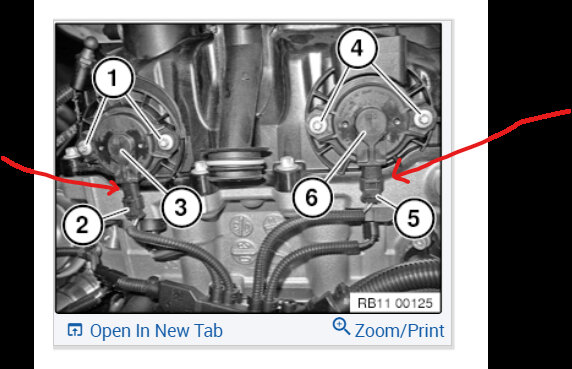

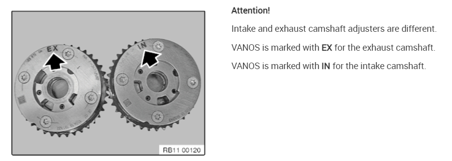

I have checked the movement of the VANOS pistons and actuators. All are good. I also replaced the turbo boost solenoid valve. The waste gate functions but I get no boost. I am using an Autel MaxiCOM MK808BT Pro scanner.
