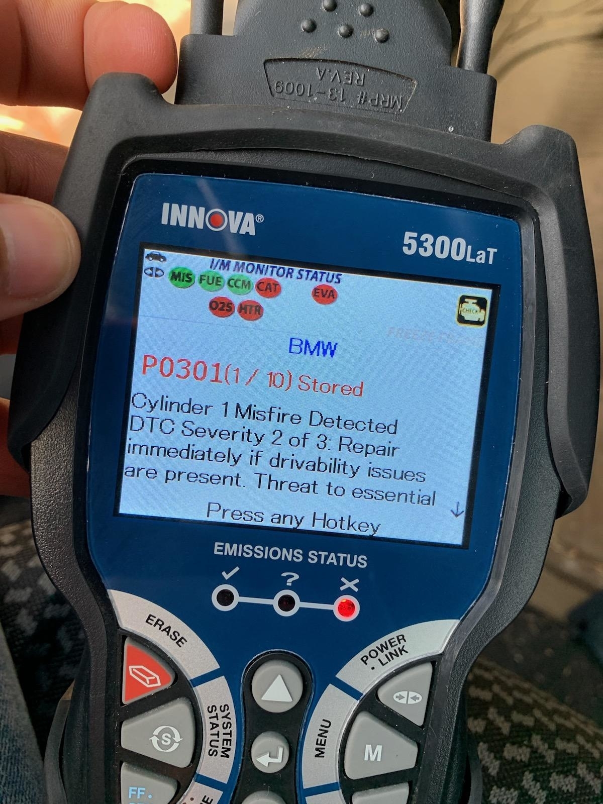

If the converters are plugged, that can cause it. However, you would likely notice a power loss. Is that the case? Has the mechanic indicated any diagnostic trouble codes that are related to the catalytic converter?
If you think it could be the converters, the easiest thing to do is remove a pre cat oxygen sensor to see if that changes the issue. When removed, it allows an exit for the exhaust which is usually enough to notice a difference.
Here is a link that explains how to test a converter. Also, I'm attaching a link that explains the common symptoms of a failing converter. Let me know if anything mirrors what is indicated.
https://www.2carpros.com/articles/bad-catalytic-converter-symptoms
Let me know. Also, if there are codes, let me know what they are.
