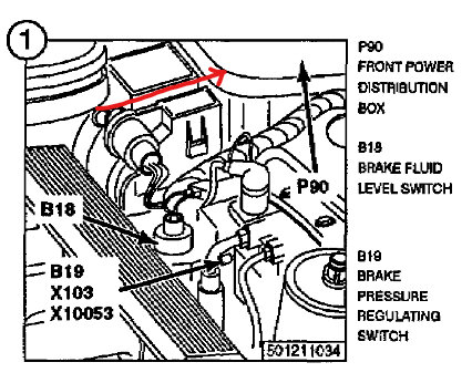

Yep, it sounds like the alarm control module is out but we should check the fuse F18 7.5 amp fuse in the front power distribution box which could be blown. Here is a guide to help you.
Check out the images (below). Let us know how it goes
