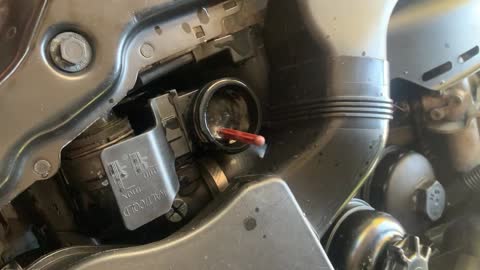

So I changed my lower radiator hose because it was leaking coolant and after I went for a ride, I saw that my temperature needle went high enough to the red part. After my car cooled down I bleed the system (with the bleed screw off of the upper radiator hose) and my car kept overheating so I tried to bleed it again but instead of using the bleeder screw I left my radiator cap off and started the car, at first I saw some bubbles coming from the tank but after a while it started to overflow and it was kind of boiling. I've even flush my coolant system and this keeps happening. can you guys help me out with this?

this is a video I recorded .

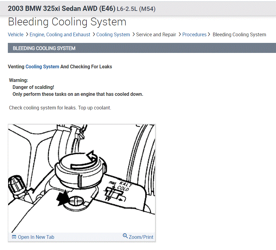

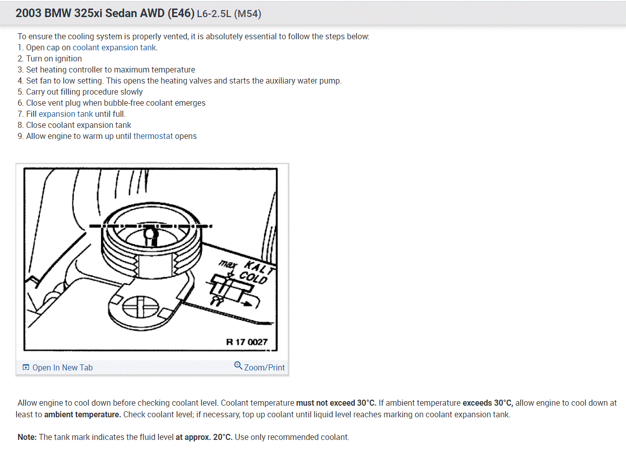

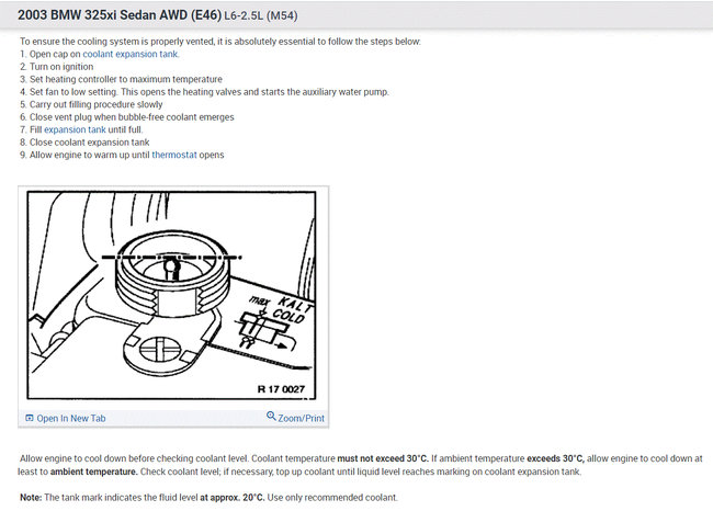

When you bled the system, did you have the heater on? If you don't, it won't actuate the auxiliary water pump. Do me a favor. Take a look at the directions below. These are the specific directions for bleeding the cooling system on this vehicle. Let me know if this is what was done. If it wasn't, try it and let me know if it helps.
See pics below.

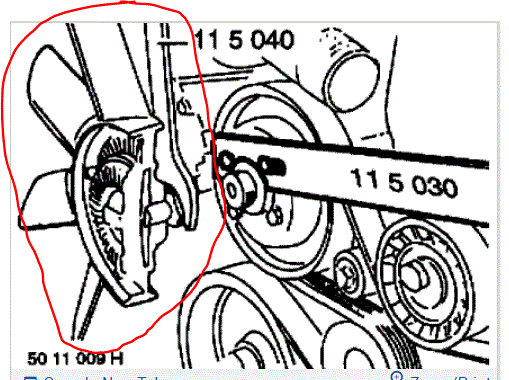

Do me a favor. Check to see if there is a fan clutch on the vehicle. It won't be electric but belt-driven. My manual is showing that it should have one. See the attached pic below.
Take a look through these two links:
https://www.2carpros.com/articles/how-a-clutch-fan-works
https://www.2carpros.com/articles/fan-clutch-symptoms
