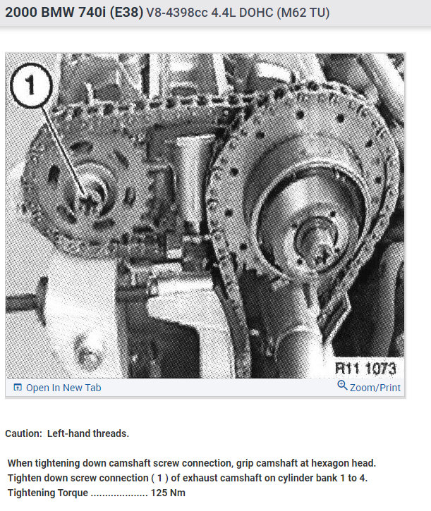

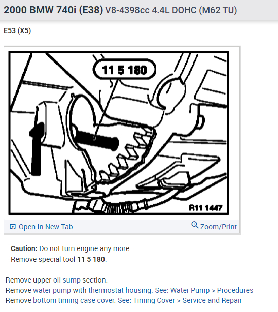

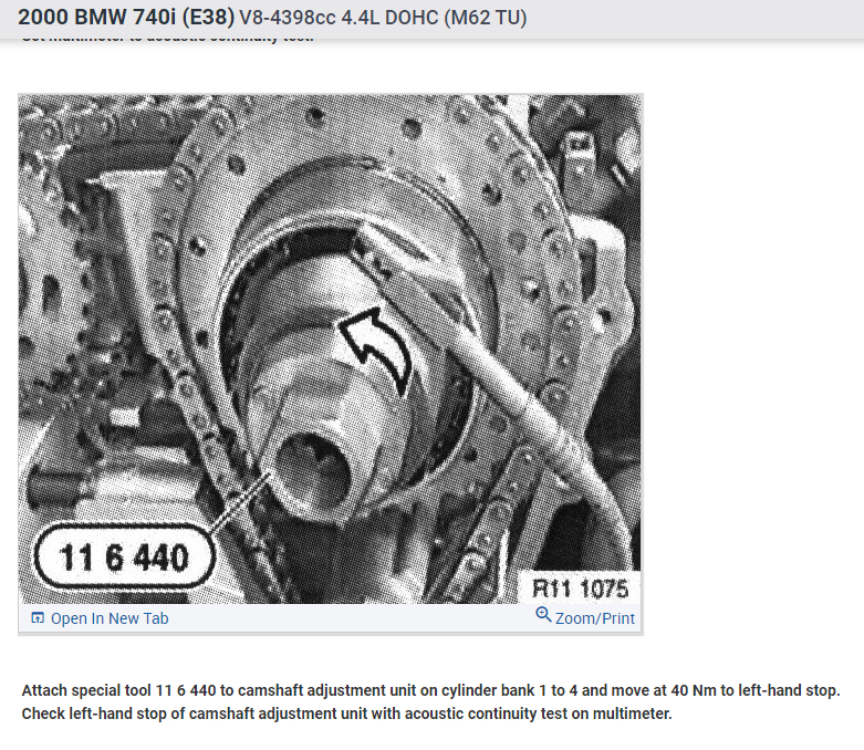

need timing marks. pictures, specs, any help please!!! I need to replace the chain, can you help me?
Mar 25, 2010 at 3:32 PM
SQM
  • 6,383 POSTS

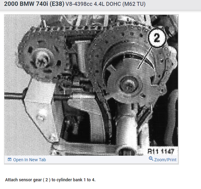

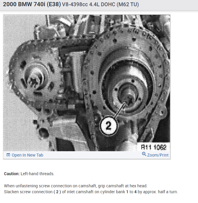

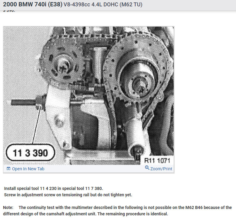

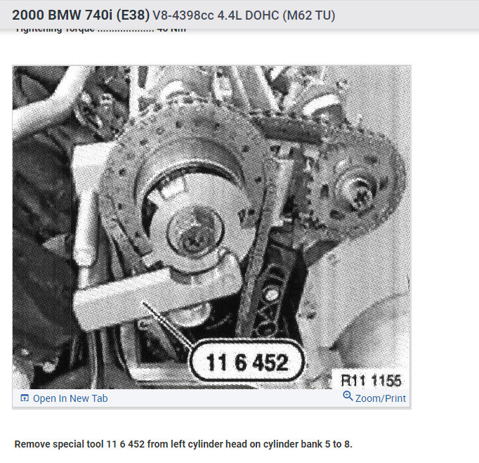

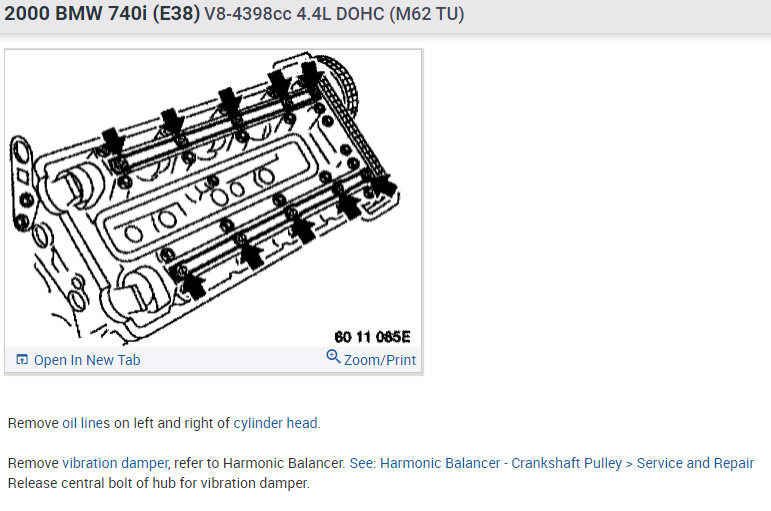

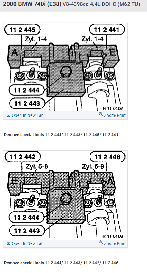

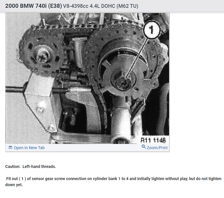

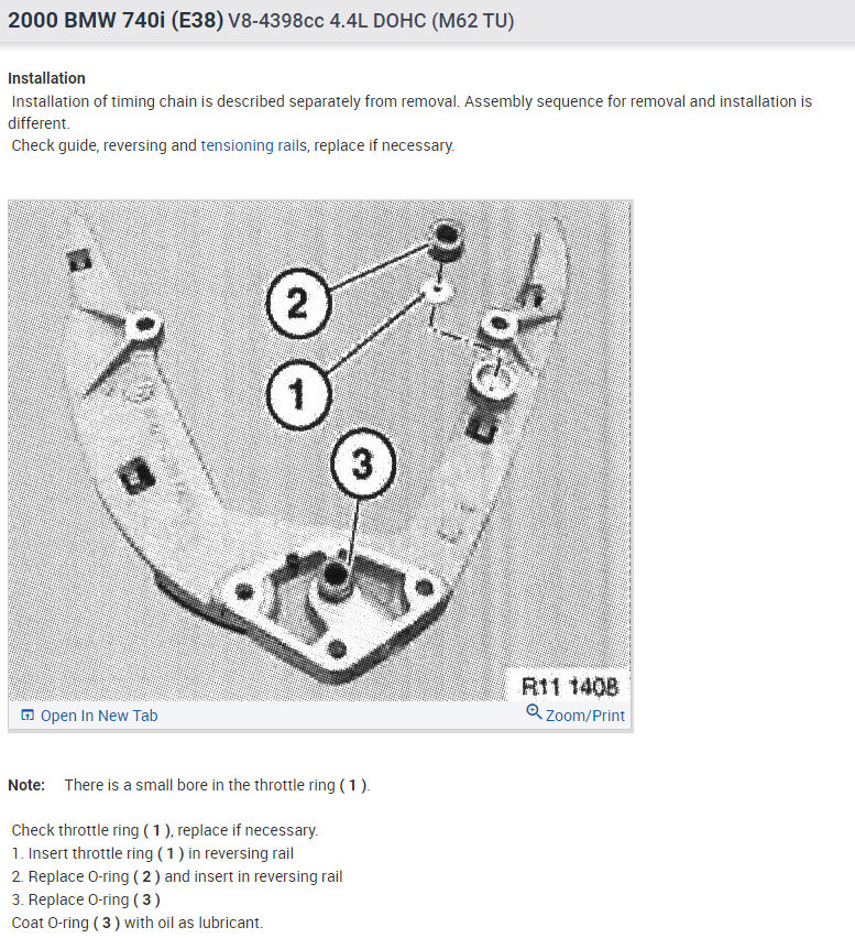

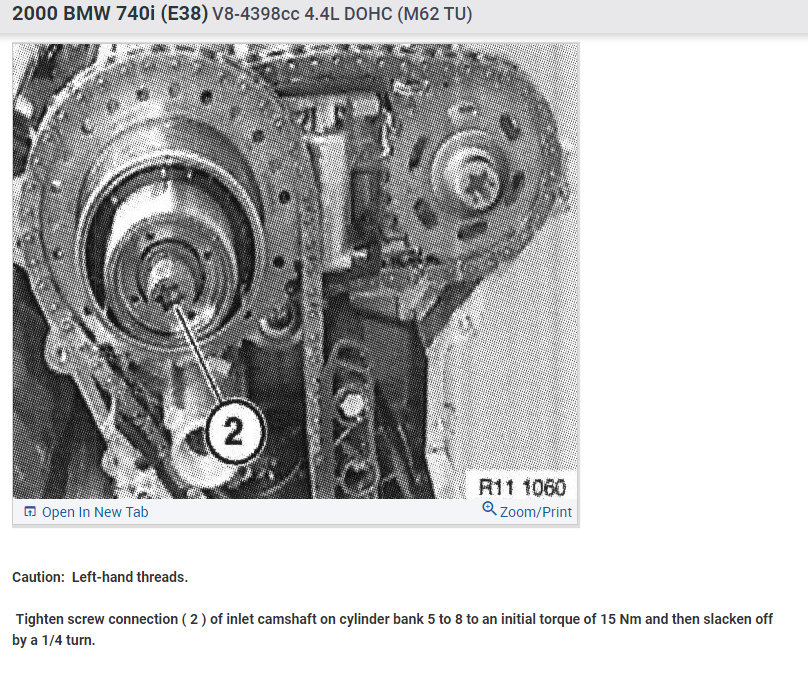

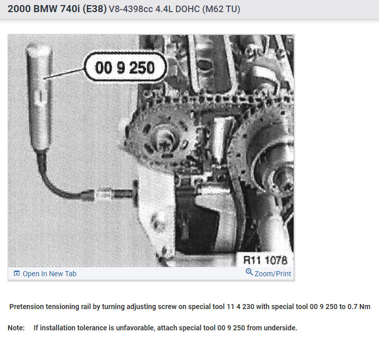

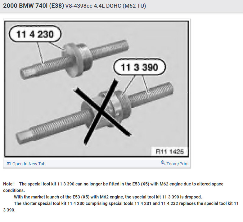

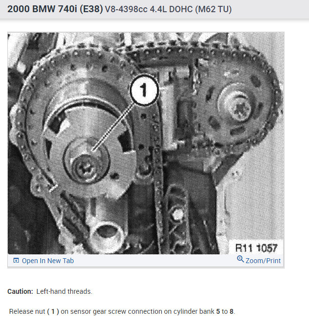

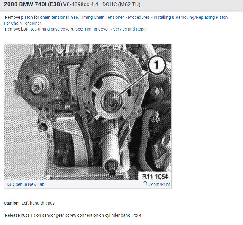

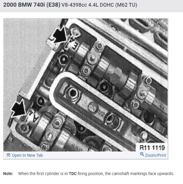

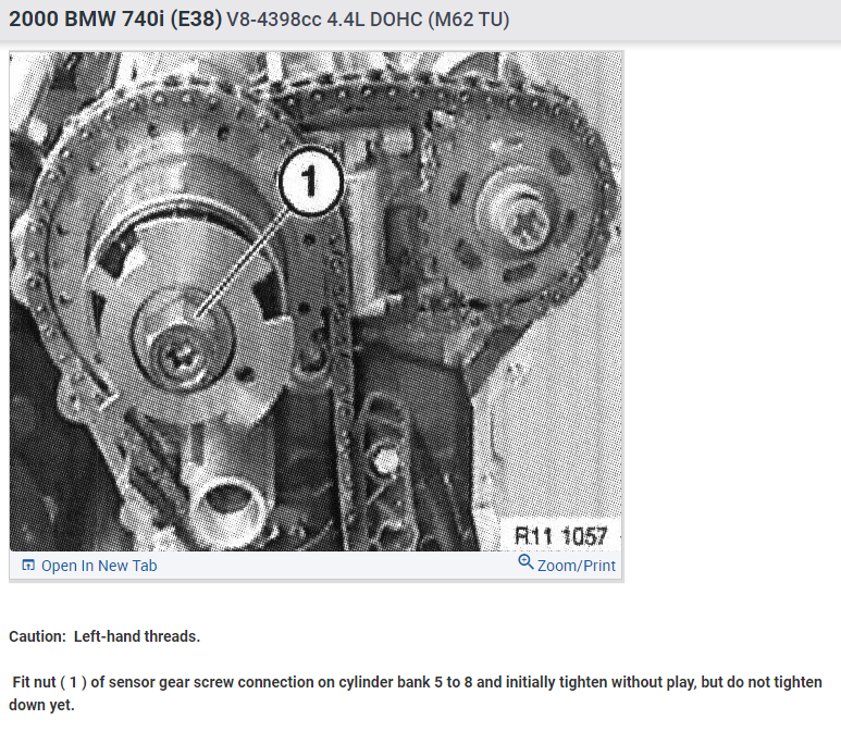

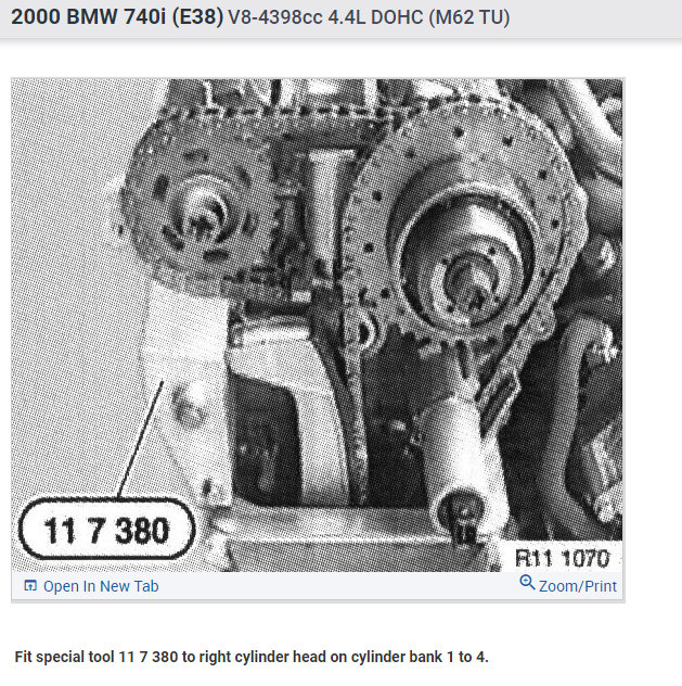

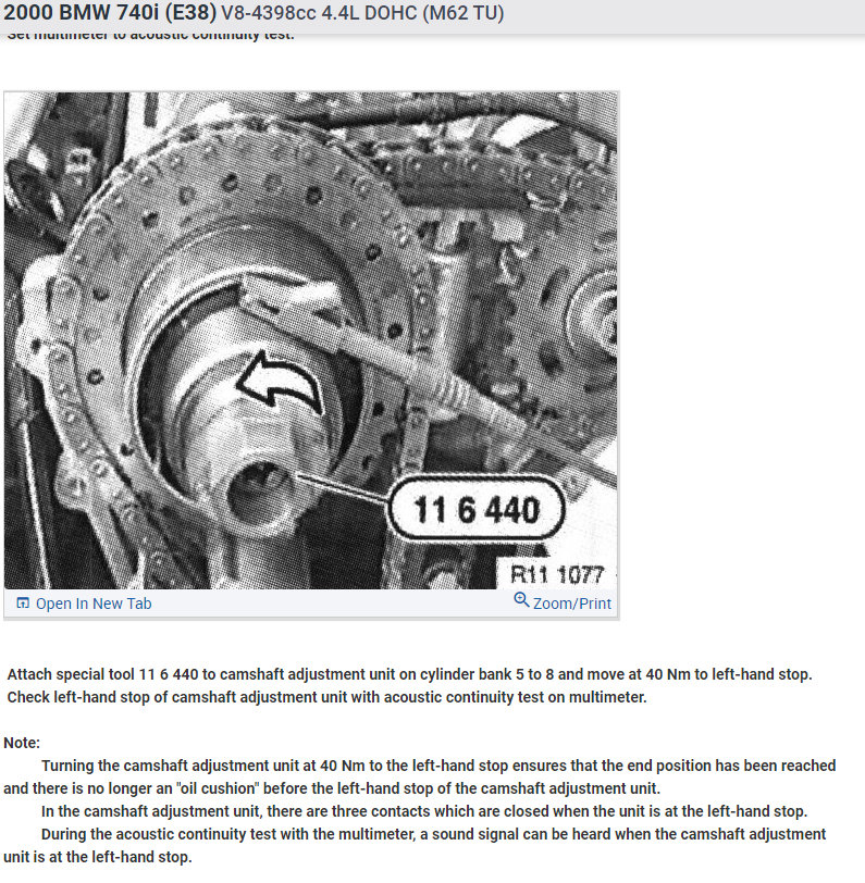

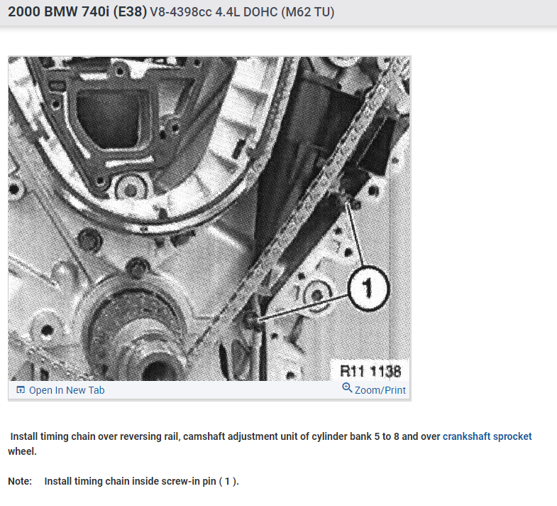

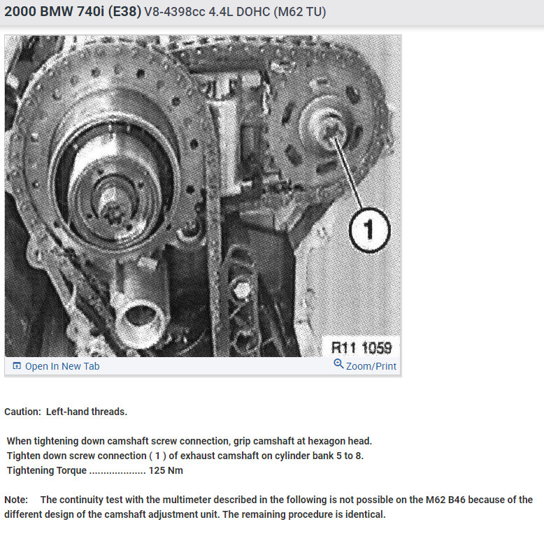

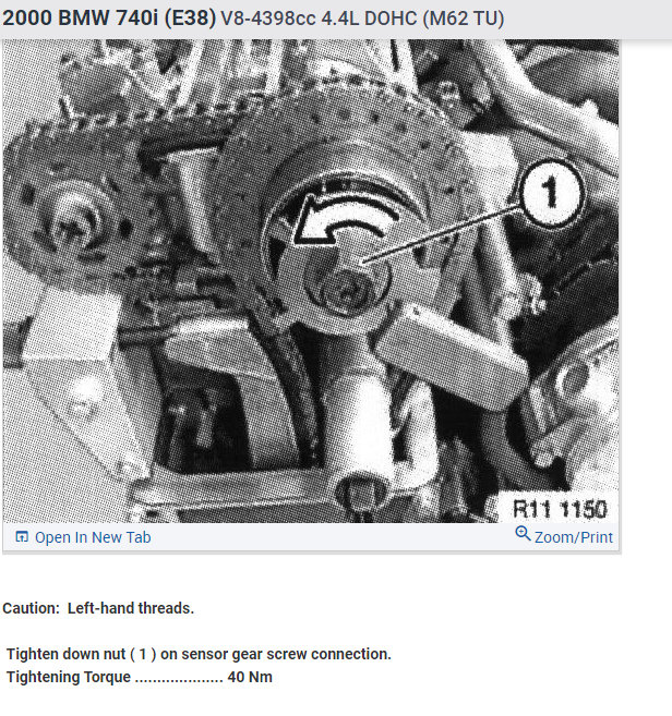

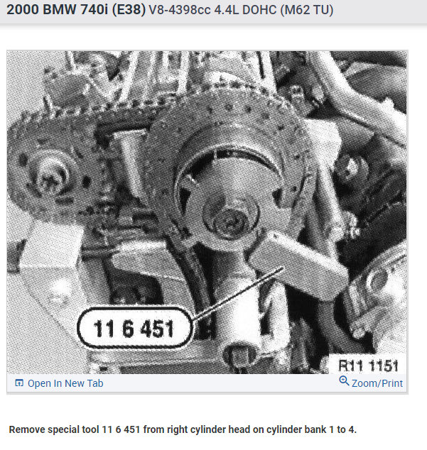

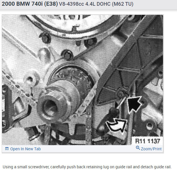

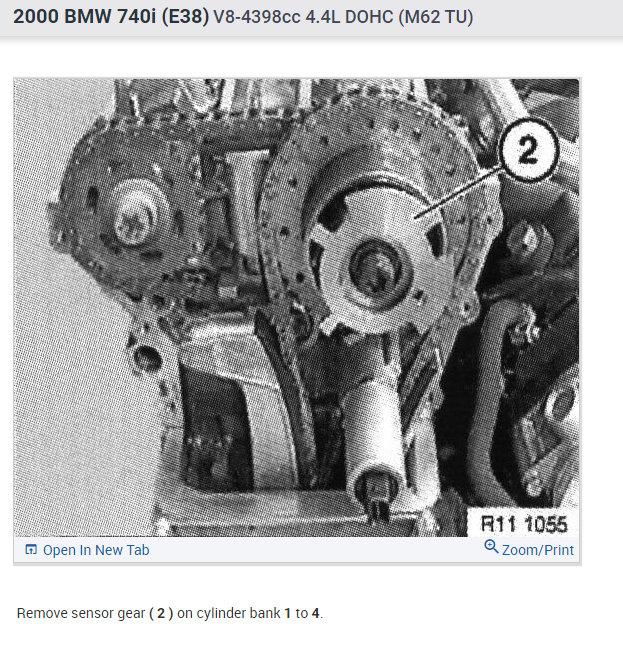

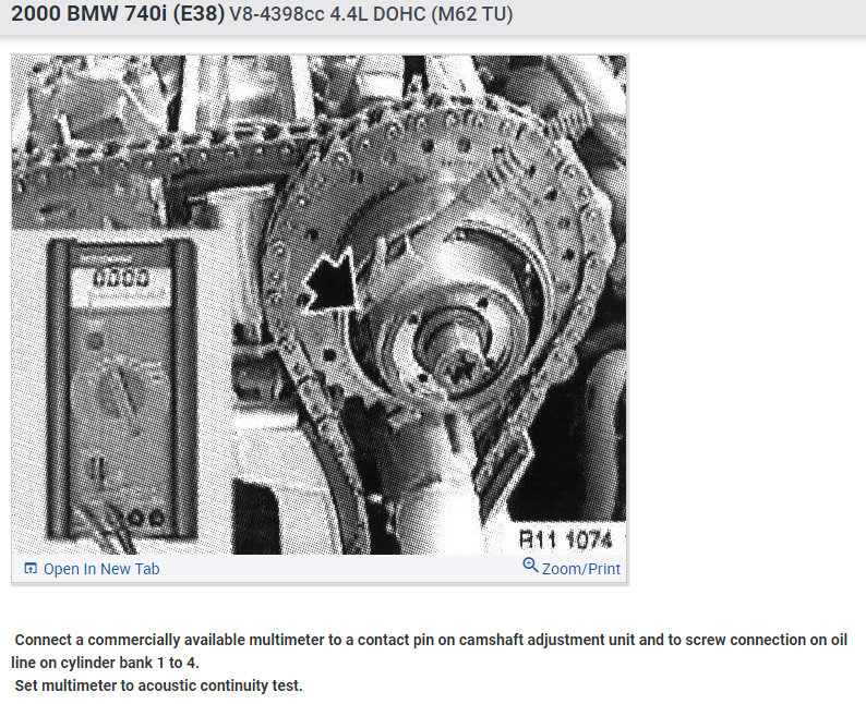

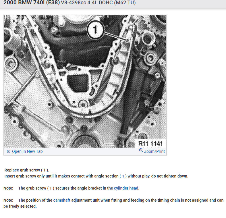

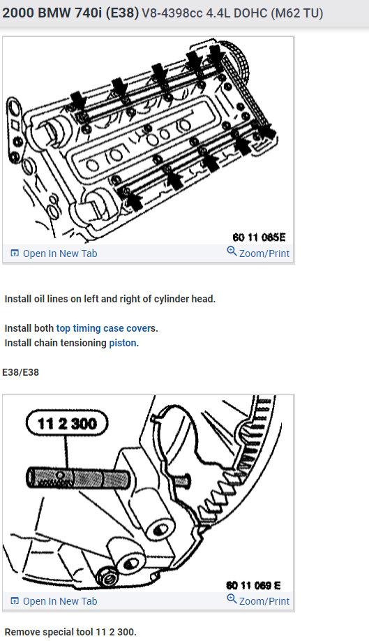

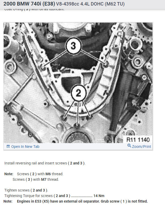

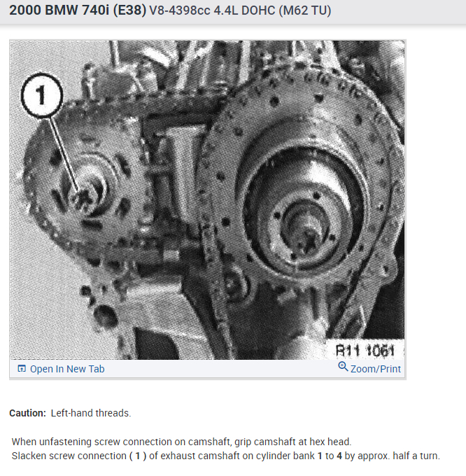

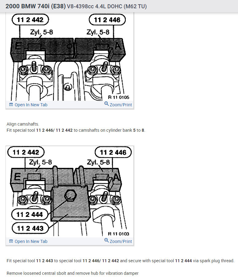

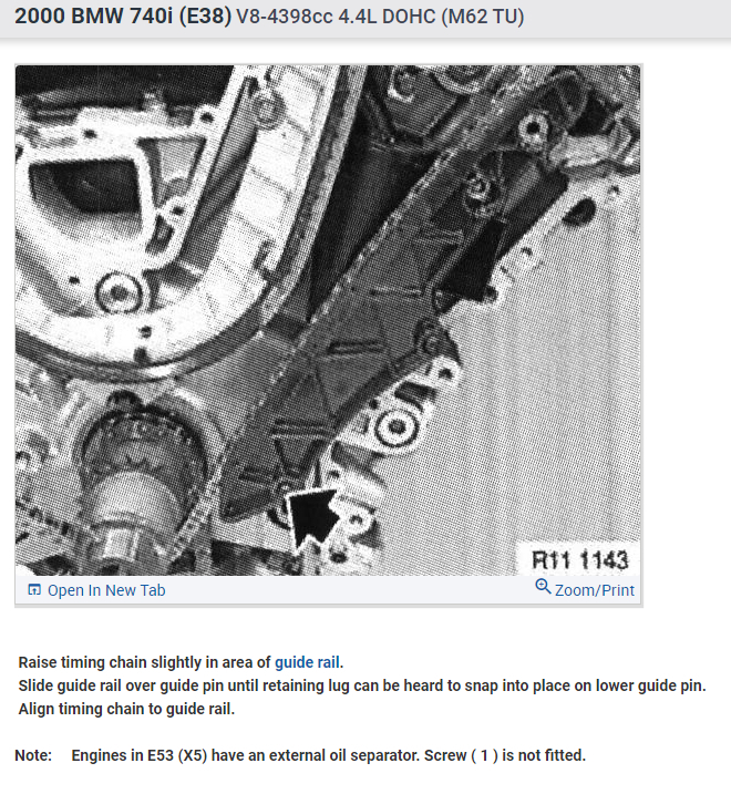

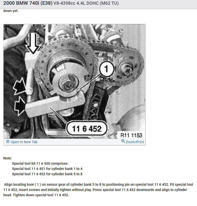

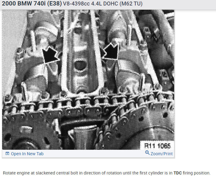

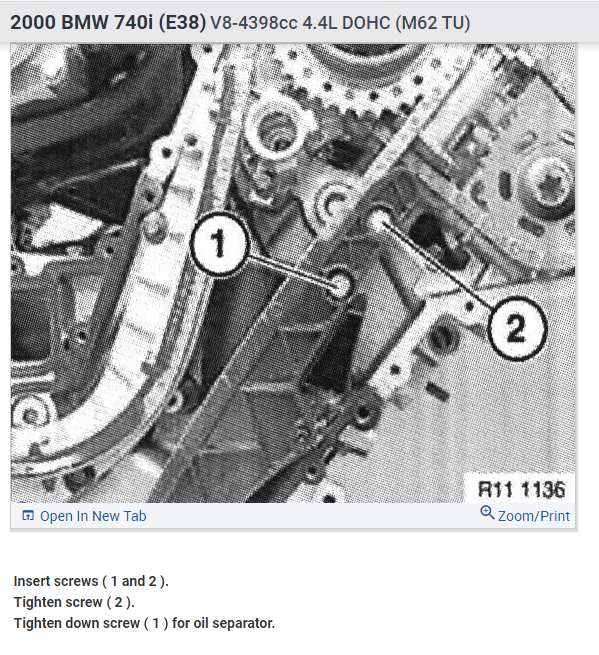

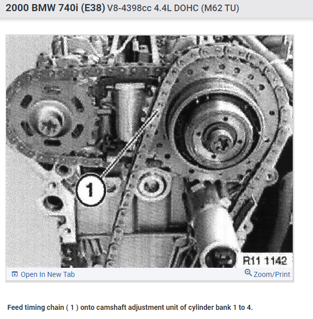

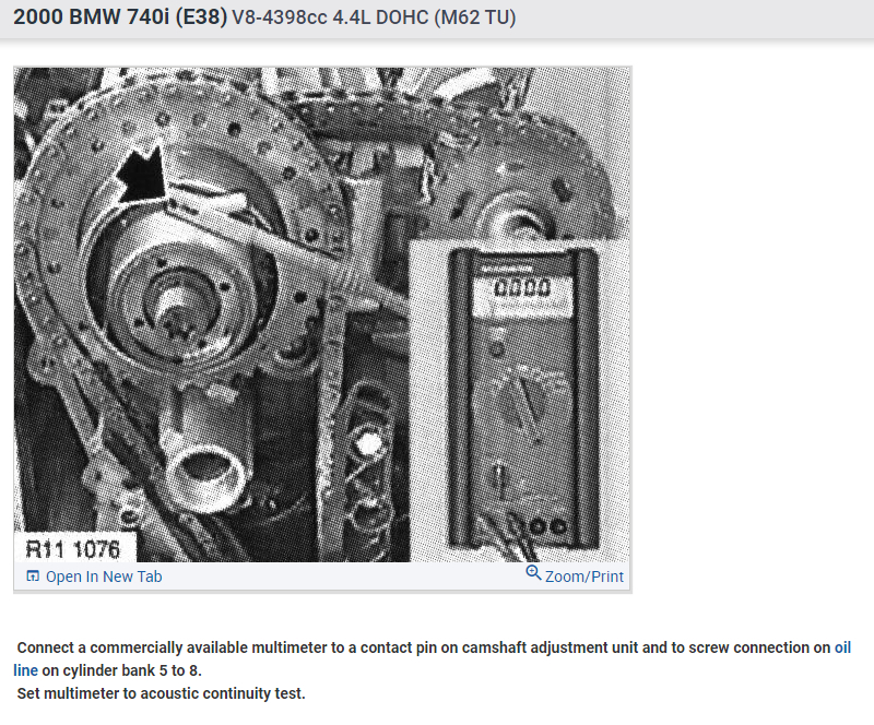

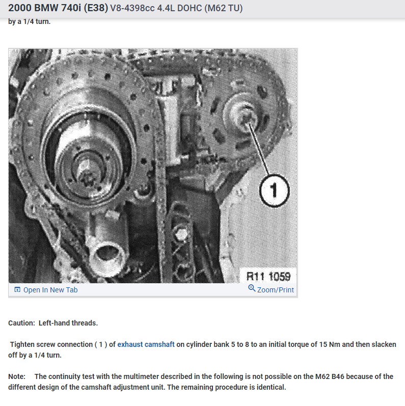

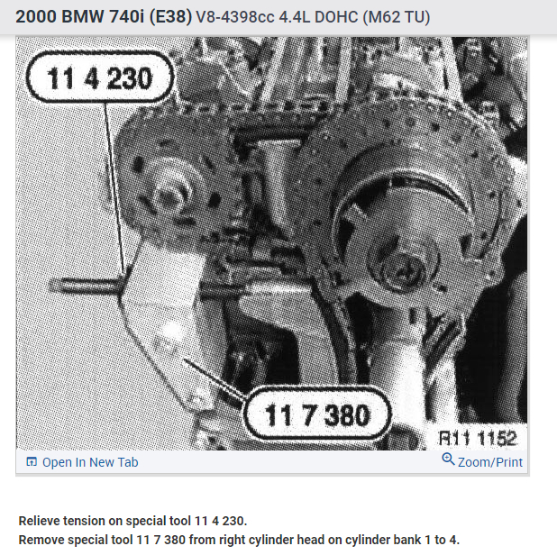

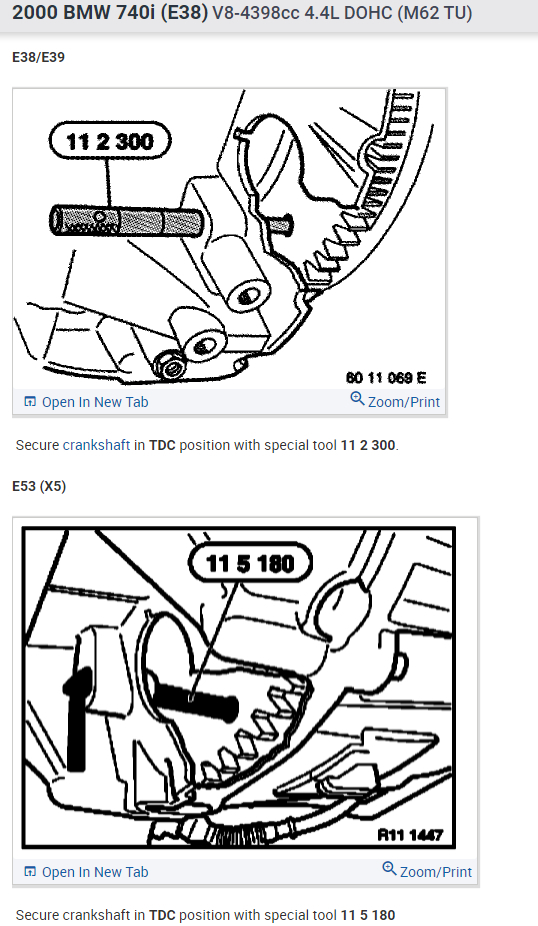

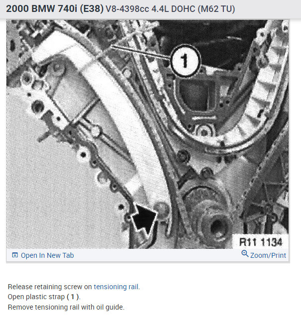

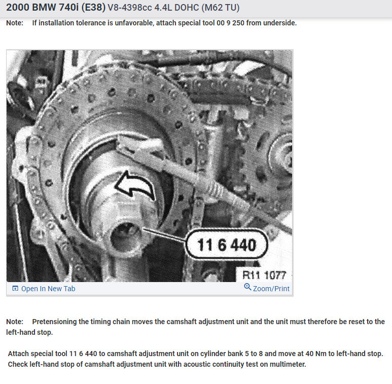

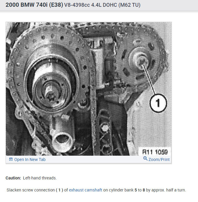

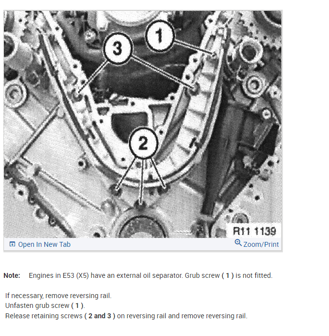

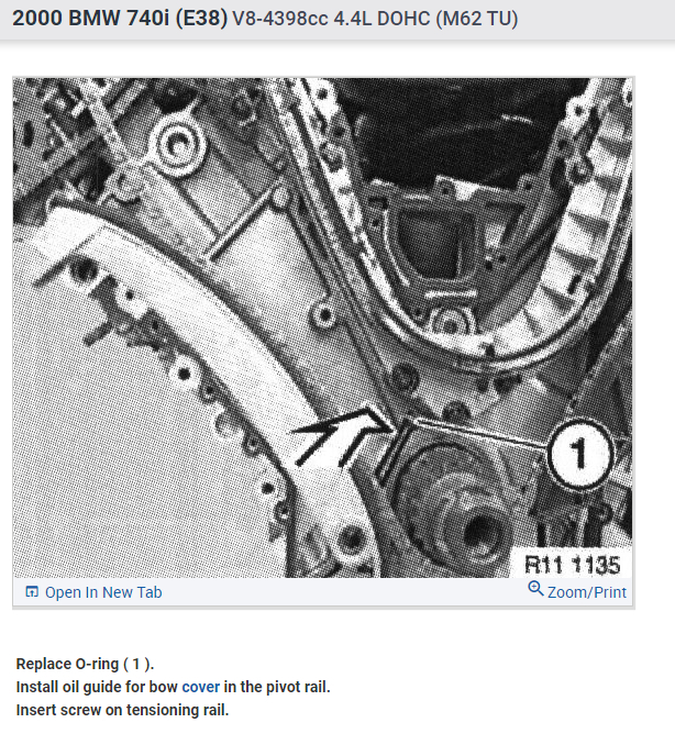

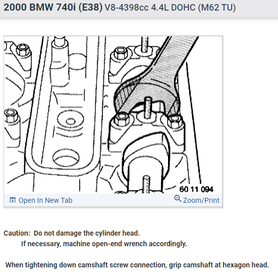

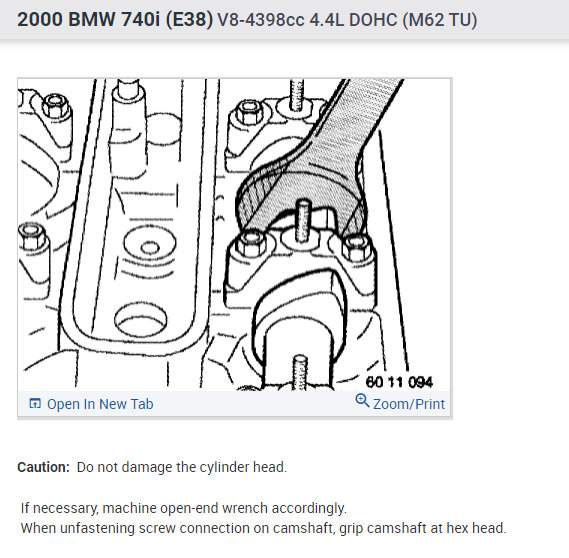

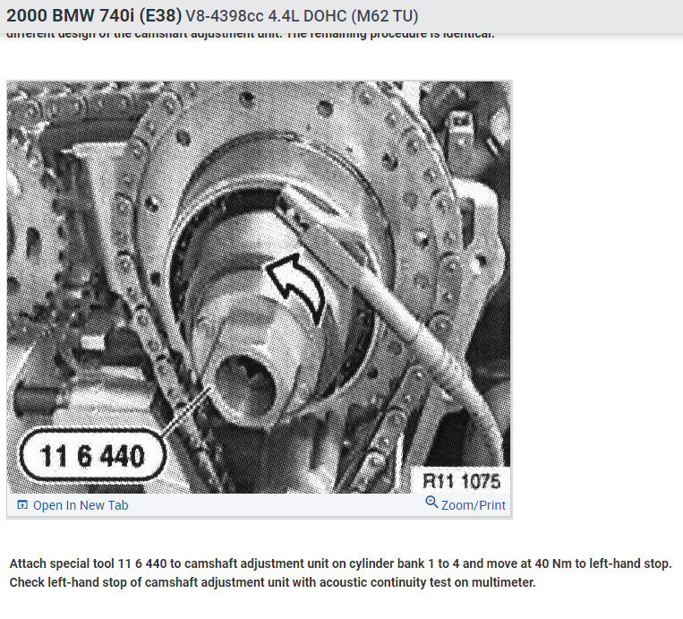

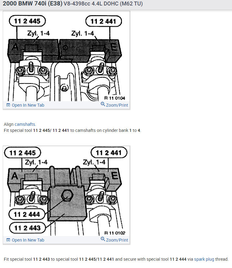

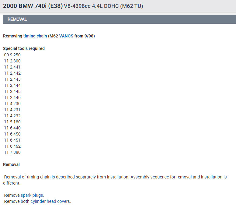

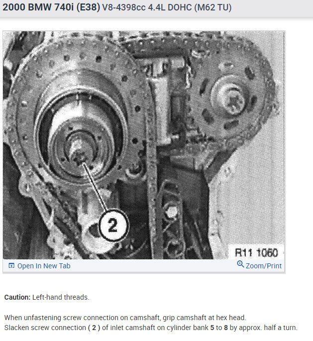

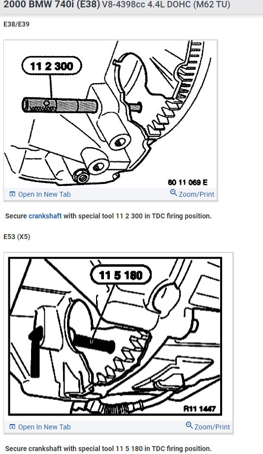

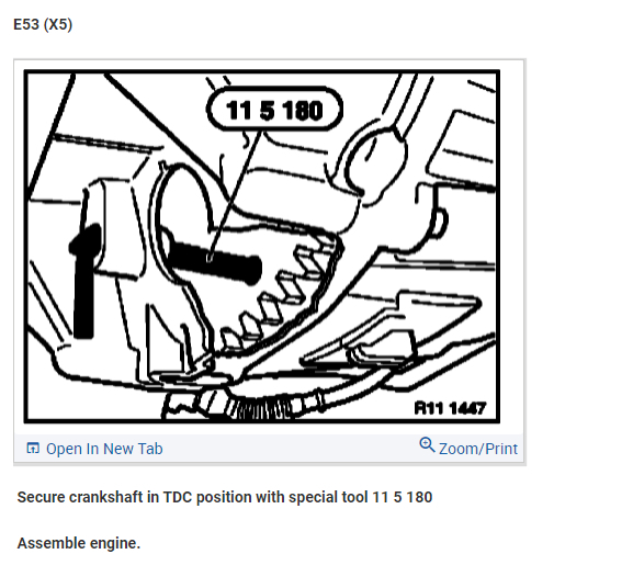

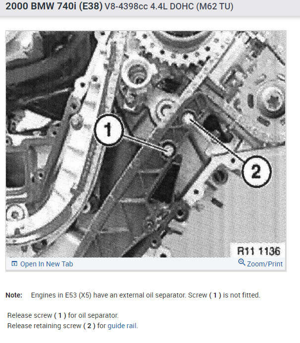

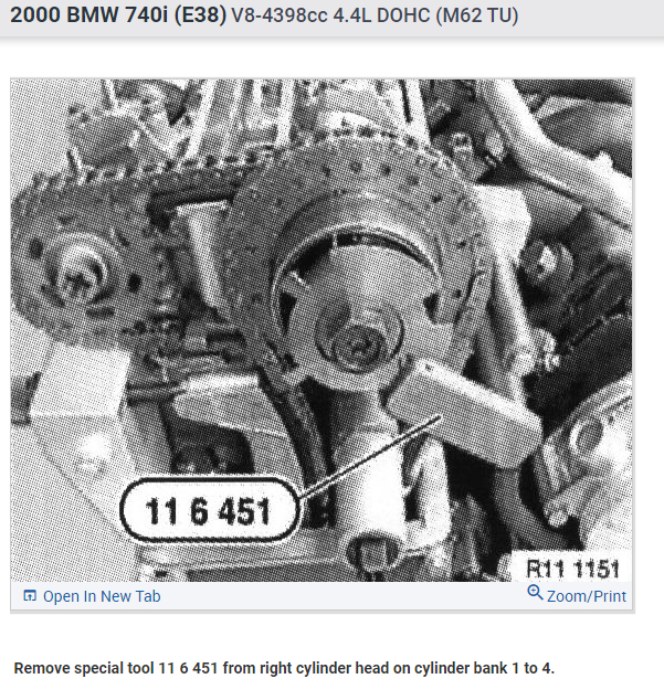

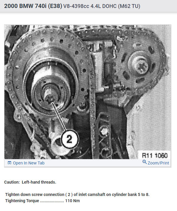

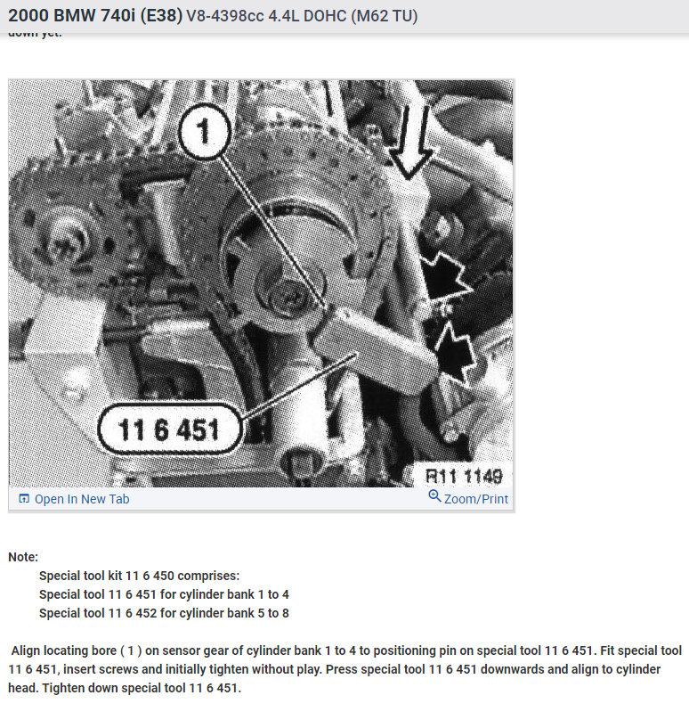

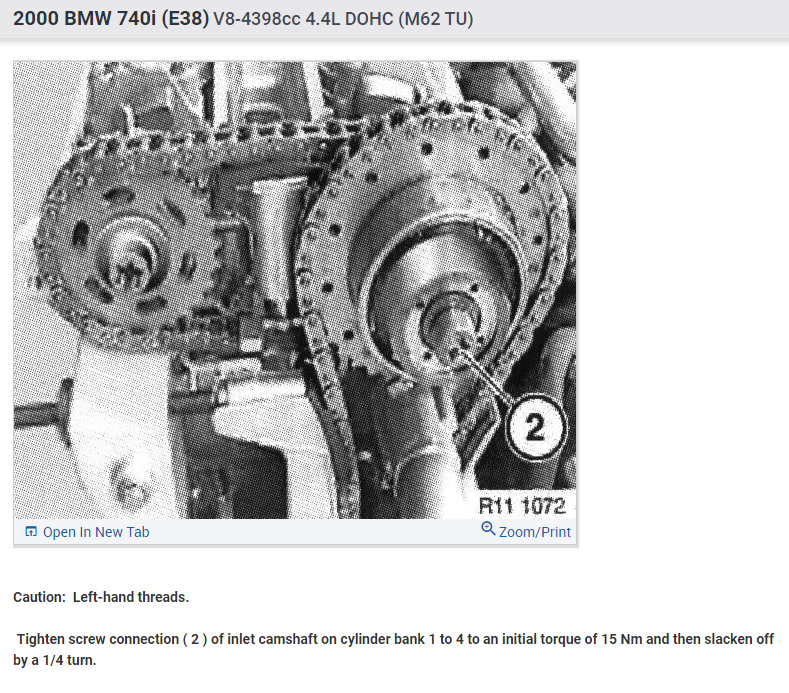

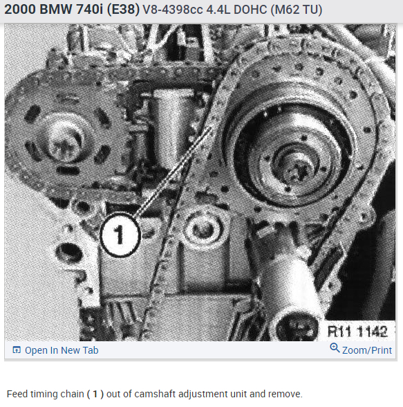

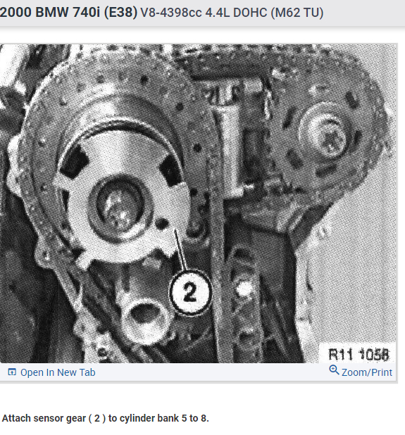

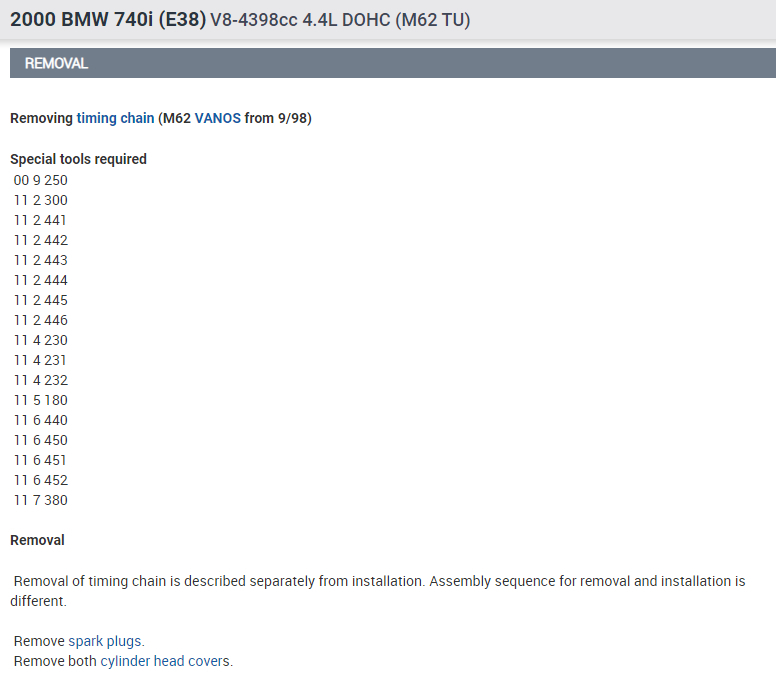

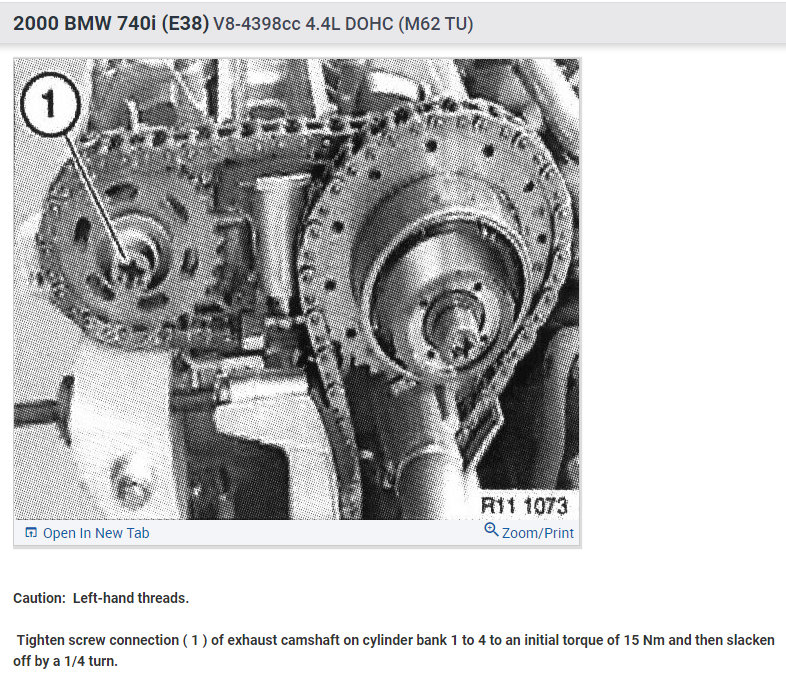

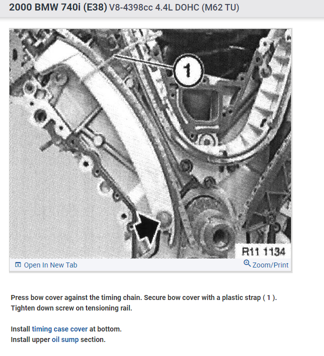

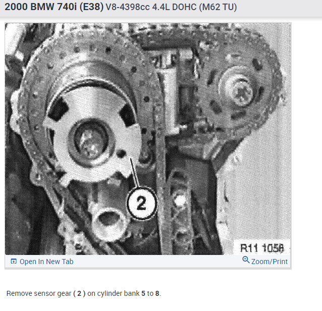

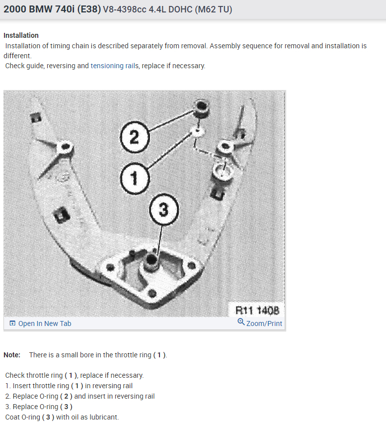

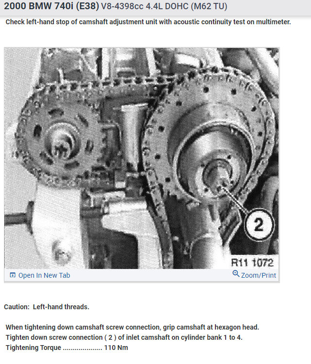

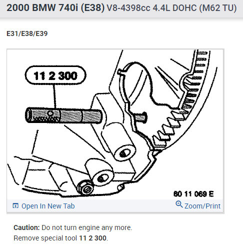

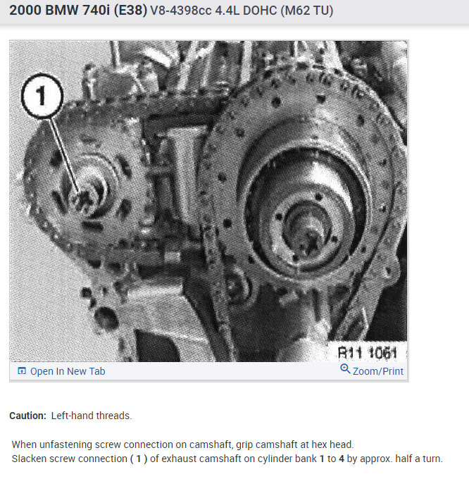

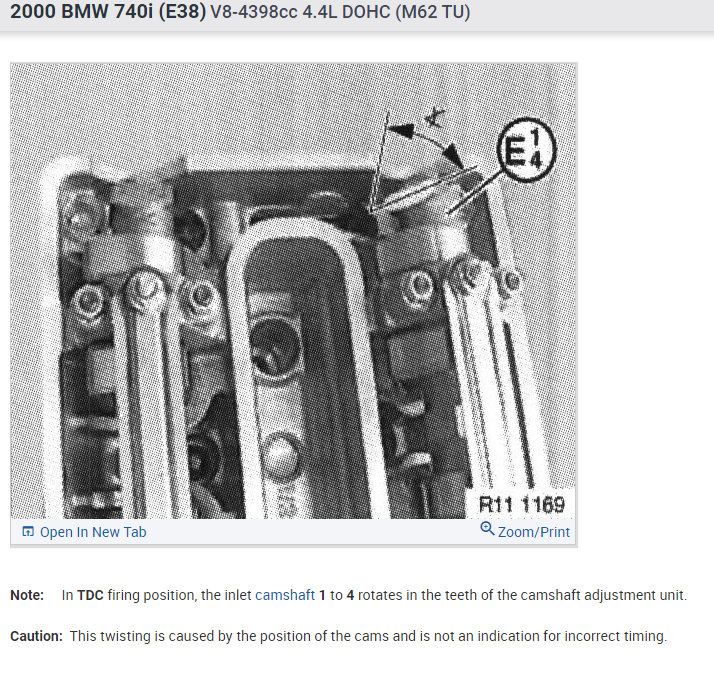

To replace the timing chain on this 740 you will need few special tools to get this doe effusively.
I have attached the complete timing changing replacement diagrams including all the markings and torque specifications as well as what special tools you might need.
Pleas let me know of any questions.
Thank you.
