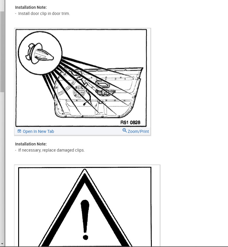

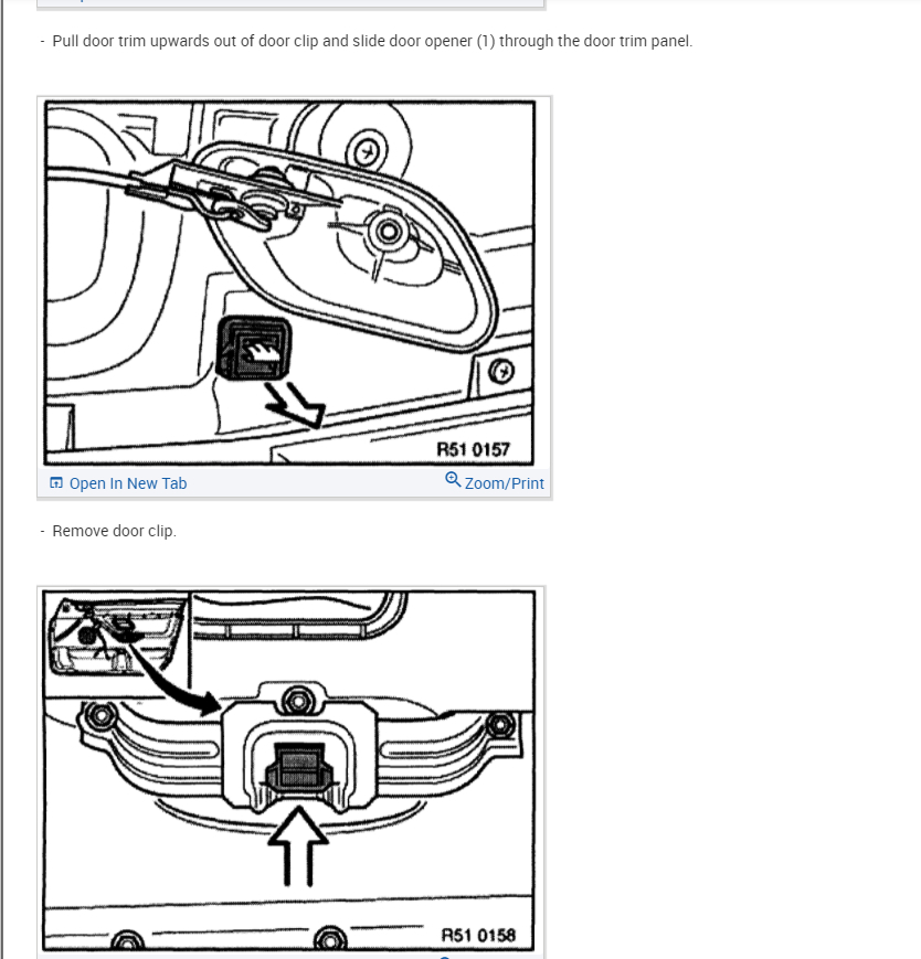

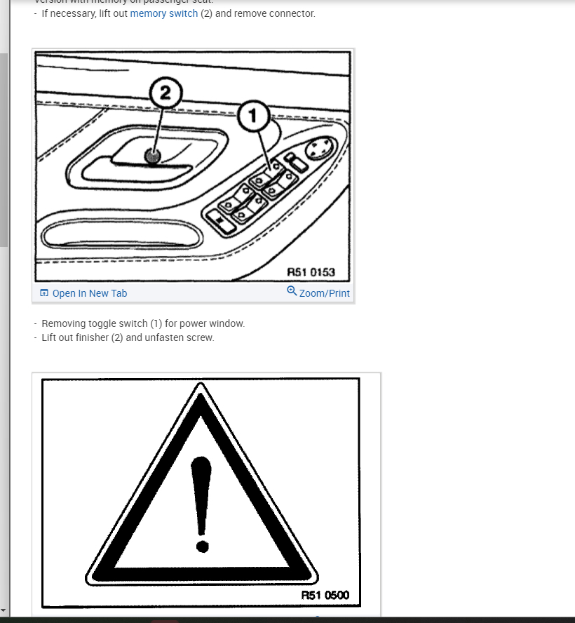

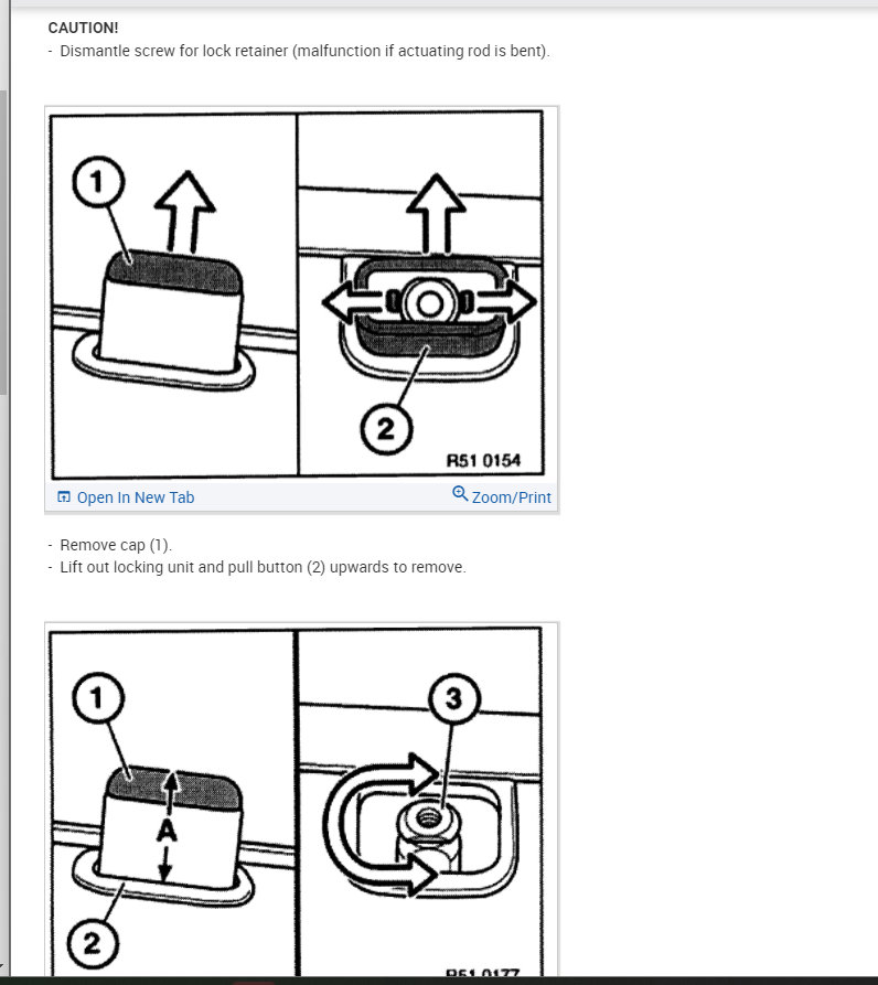

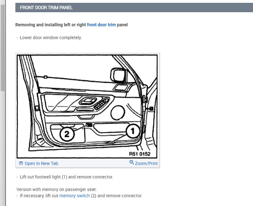

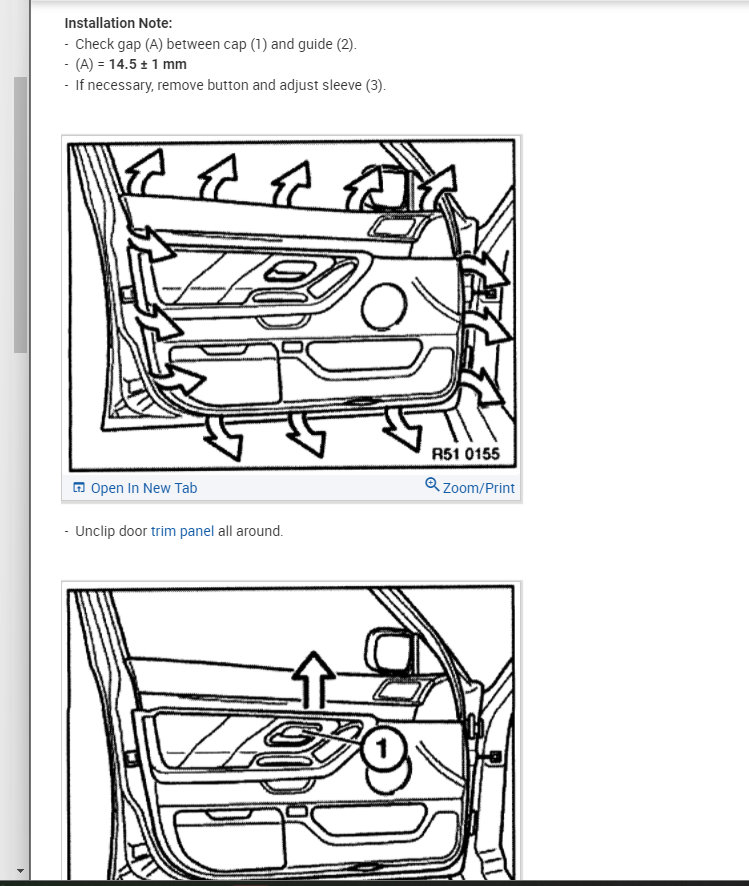

https://www.2carpros.com/articles/door-panel-removal
However, your door panel is not the difficult to remove so I am attaching that process below.
Please remove the door panel and then operate the interior or exterior handle while watching the latch to find out if the linkage or latch are the issue.
Let us know what you find with this, and we can go from there. Thanks
