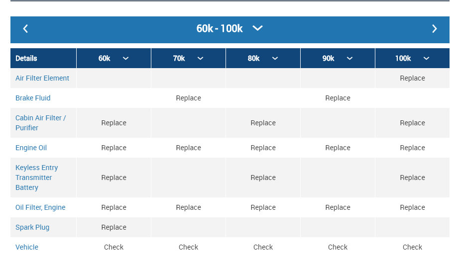

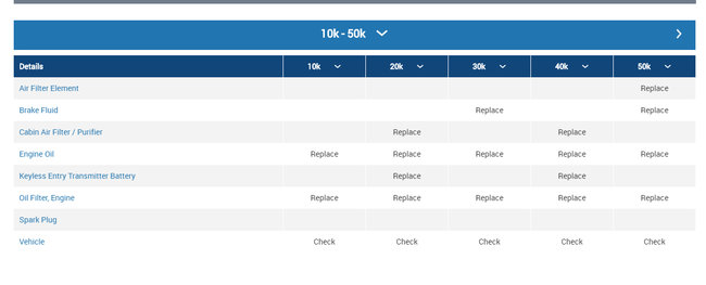

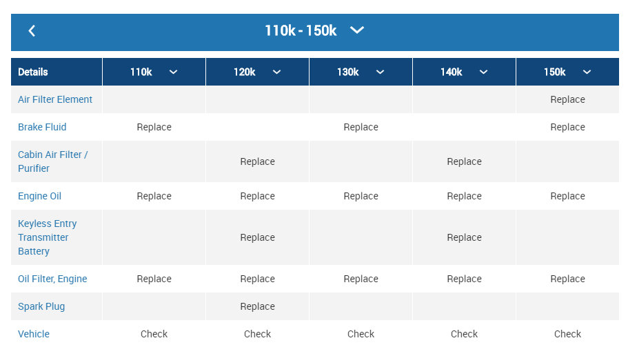

4. Cabin air filter - Listed in the tables attached.
5. Engine air intake filter - Listed in tables attached.

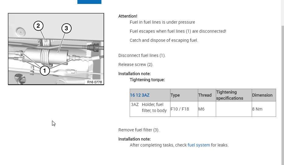

7. Is it recommended to change fuel filter - is not listed but should be changed every 30,000 miles.
