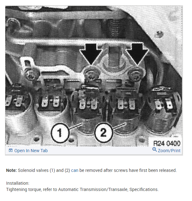

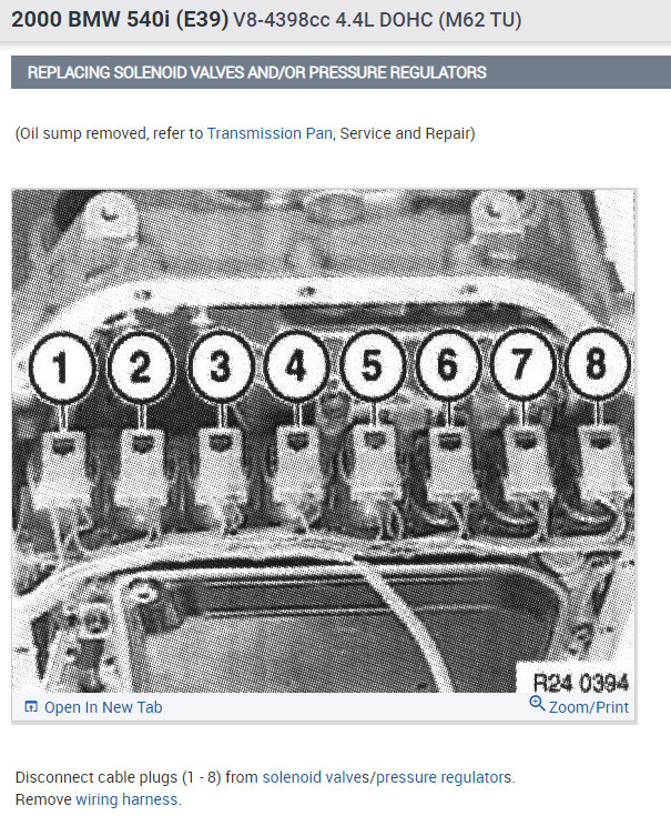

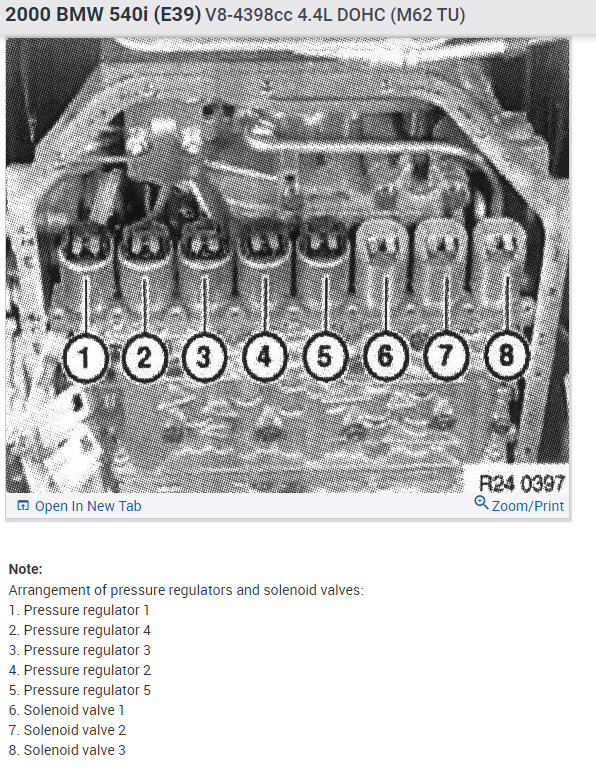

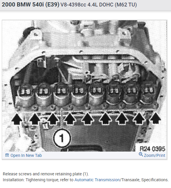

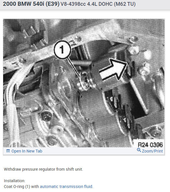

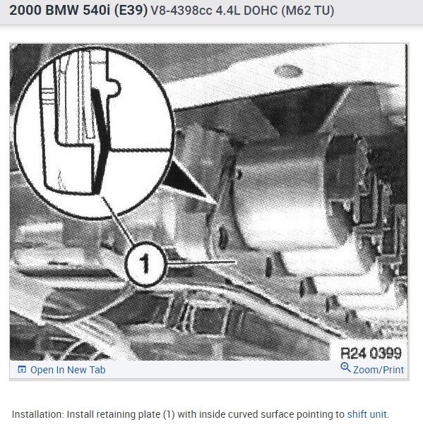

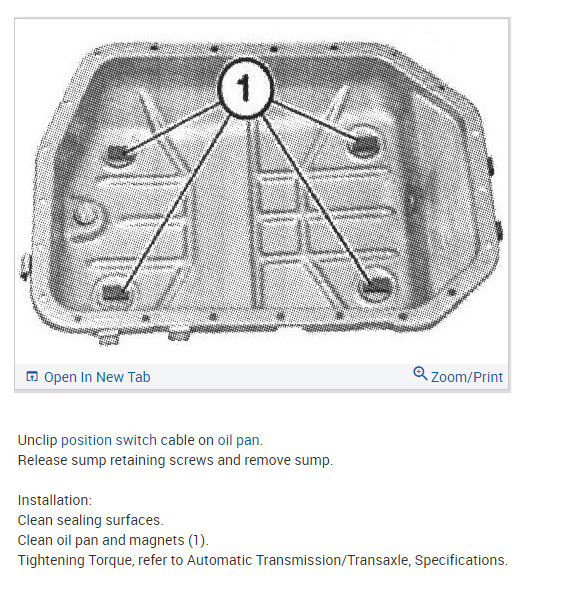

It sounds like the issue with the pressure regulators in the transmission. Your vehicle has 5 regulators.
Overtime those regulators can loose their calibration and will require more pressure to function properly, which typically leads to slipping.
Accessing and replacing those regulator are not terribly difficult.

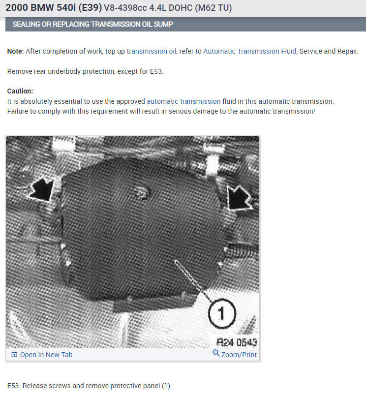

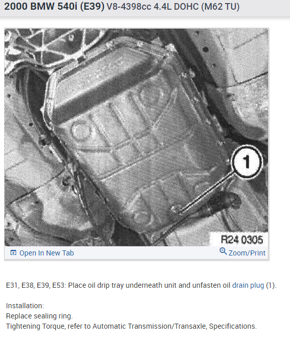

All you will have to do is drain the fluid, then take off the transmission pan. That will give you access to the regulators as well as the shift solenoids.
I have attached the replacement procedures below.
https://www.2carpros.com/articles/automatic-transmission-problems
Let me know of any questions.
