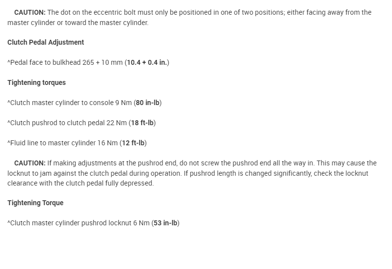

Check the clutch cable from the pedal to the transmission. One of the common failures is at the connection to the pedal on these 535i's.
