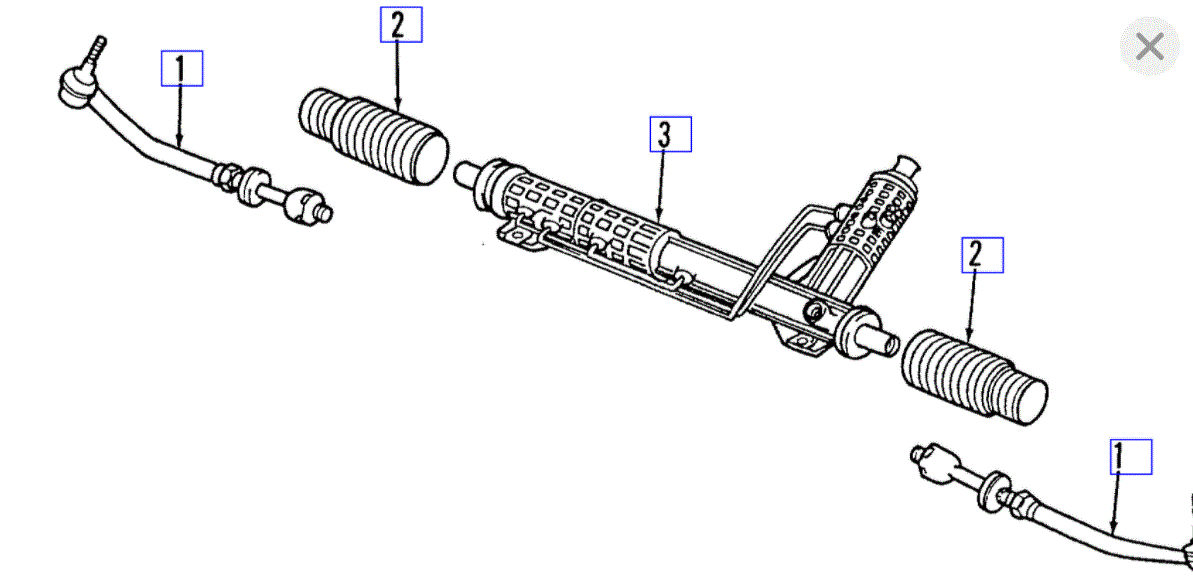

Okay, I attached a picture of the steering for you.
Check the wheel for play side to side with it jacked off the ground. It sounds like either the inner tie rod end or the out may be worn out.
https://www.2carpros.com/articles/tie-rod-end-replacement
Also, check and make sure the steering rack it self is not moving as well.
If the mounts are worn, it will cause this issue.
