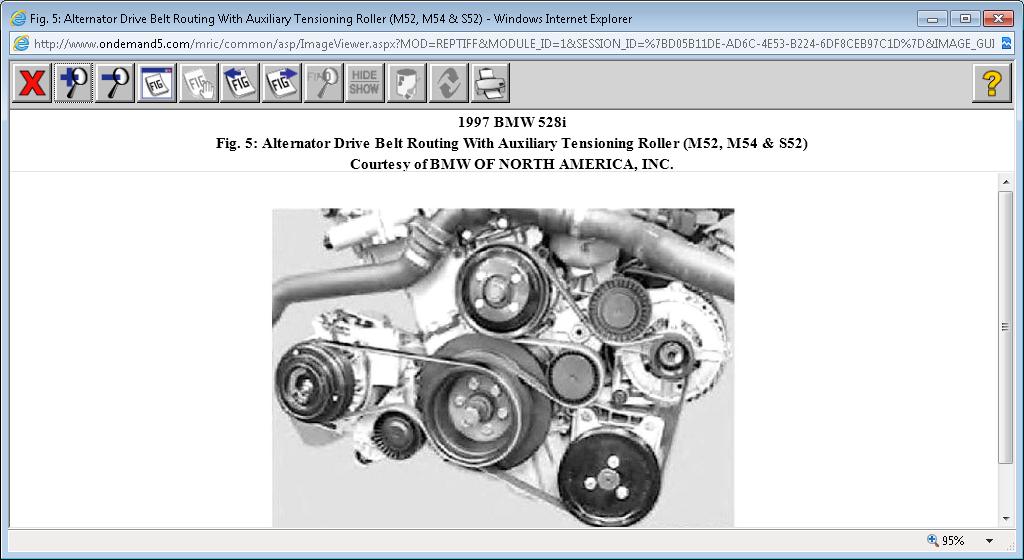

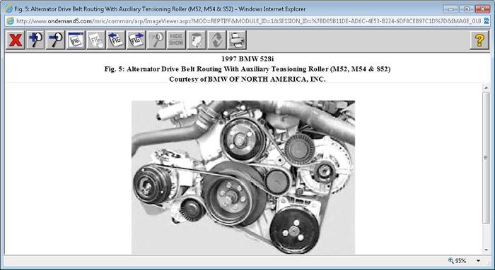

See below
https://www.2carpros.com/forum/automotive_pictures/12900_belt1_1.jpg
https://www.2carpros.com/forum/automotive_pictures/12900_belt2_1.jpg
Thanks to Rasmataz from Dr. Hagerty

What is the route of the belts when replacing them?: Which one goes on first?
May 20, 2020 at 1:35 PM (Merged)
DOCHAGERTY
  • 9,603 POSTS
The A/C belt goes on first and then the water pump/power steering pump/alternator belt. The route is obvious for the A/C. The water pump,alt,P/S belt, starting at the top pulley for the water pump, go under the deflection pulley then over the alt. then around the P/S pump then around the crankshaft and then to the idler pulley and then to the water pump and that is it.

i need thw serpentine belt diagram for my car 1998 528i
DOCHAGERTY
  • 9,603 POSTS
I can describe the routing for you. Starting with the water pump pulley,off the top of that, then it goes under the deflection pulley, over the alternator, down to the power steering pump, along the bottom to the crankshaft pulley, around the tensioner pulley and to then back to the water pump.

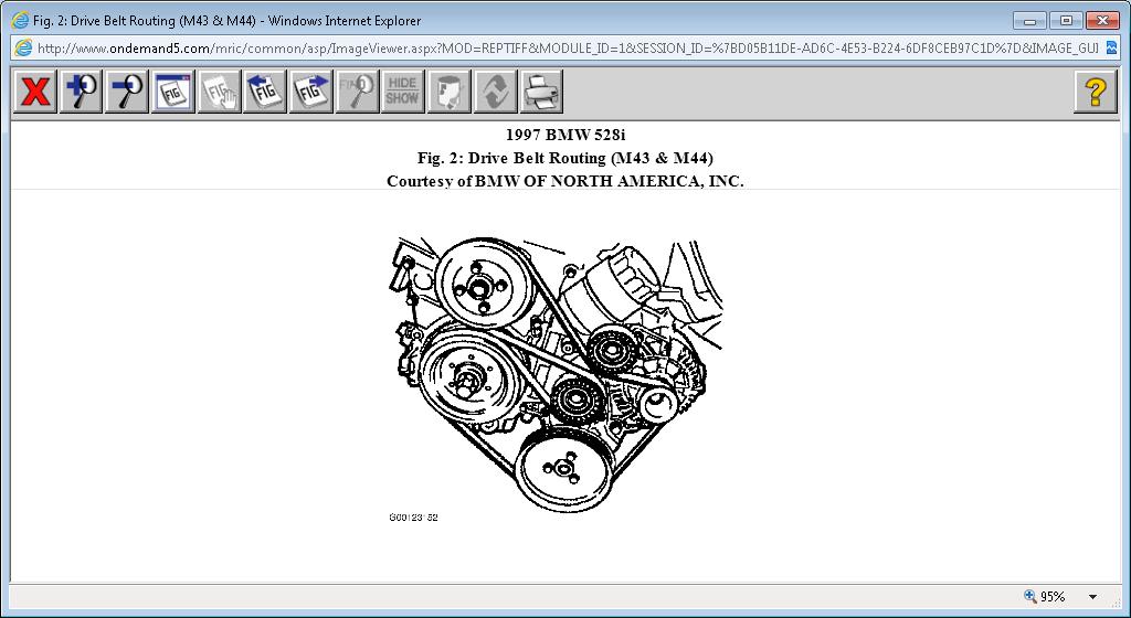

I need the belt routing diagram for a 1997 528i with a tension pulley.
SATURNTECH9
  • 30,869 POSTS
See if one of the diagrams i posted is what you have.

need fan belt routing for 1997 BMW 528i
SERVICE WRITER
  • 9,123 POSTS
https://www.2carpros.com/forum/automotive_pictures/30961_bmw_1.jpg
:wink:
