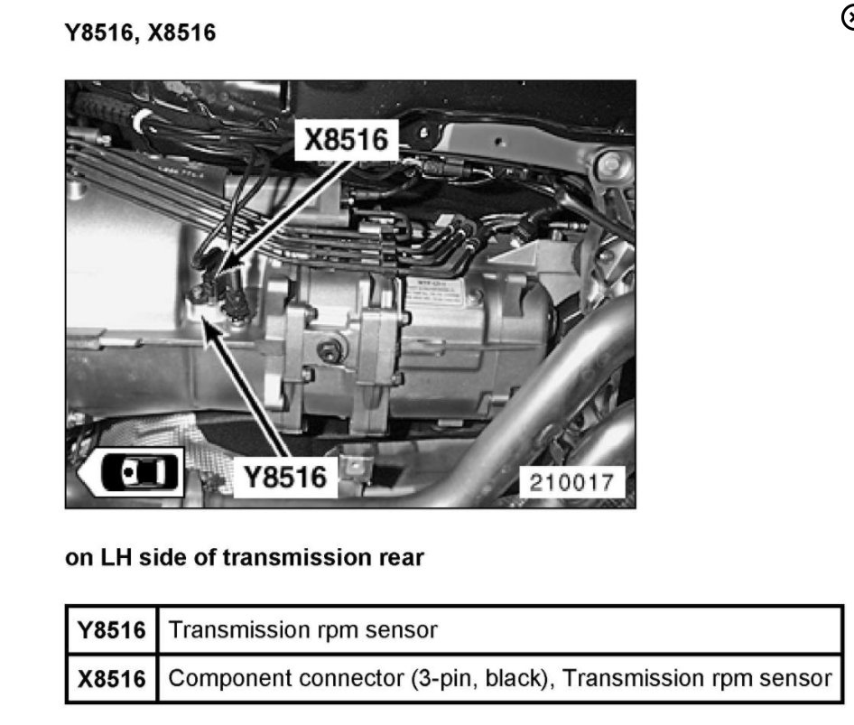

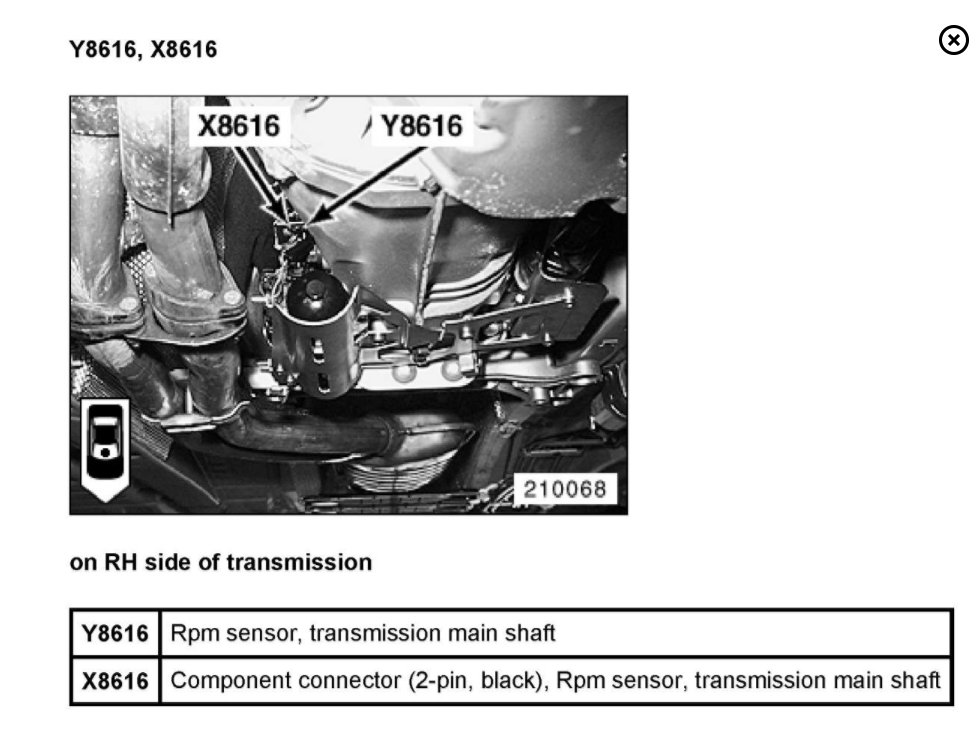

This sounds like you have a a problem with a input or output speed sensor. We should run the codes to see whats come up and then go from there.
Here is guide to get us started.
These cars had big problems with the sensors here is there location (below)
Please let us know what you find.
