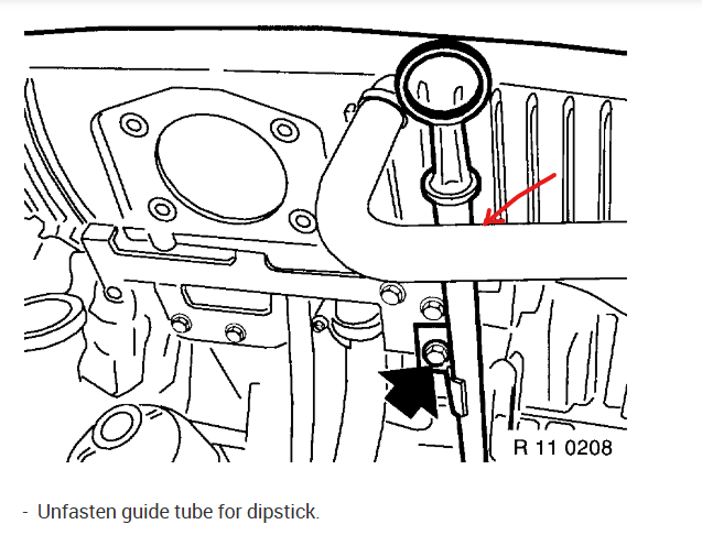

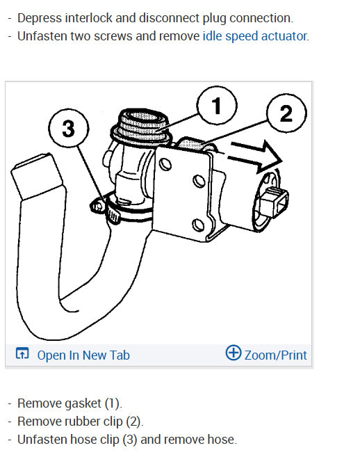

This can be the idle control valve hose leaking which will make a whistle noise as the valve opens when the engine is cold. Here is the location so you can check it out. Check out the images (below). Let us know how it goes
