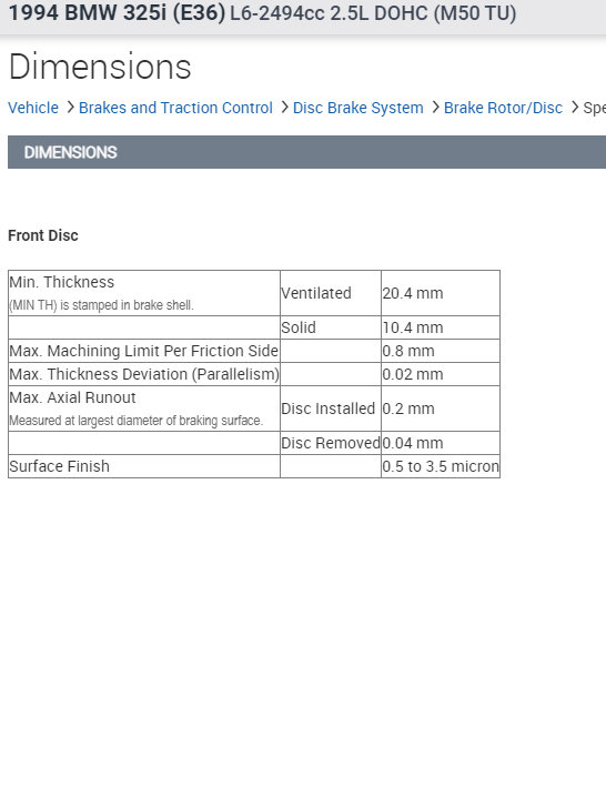

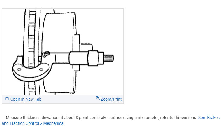

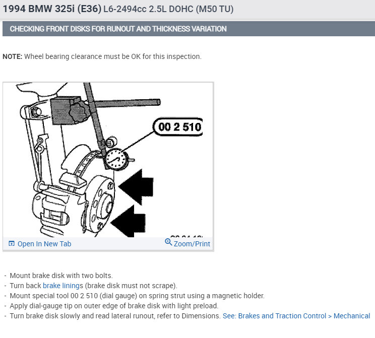

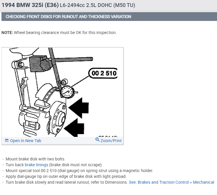

You need to do a lateral runout check on the rotor. This will tell you if the rotors are wrapped.
On you runout test you will have to use a special tool with a dial gauge it will measure if the rotors are wrapped by measuring the lateral runout.

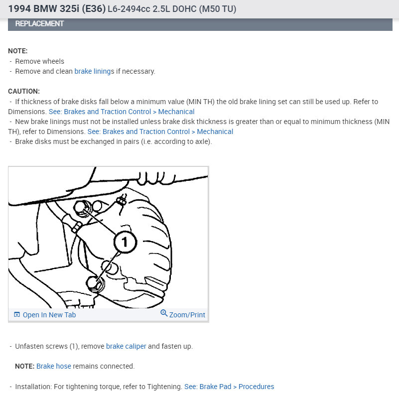

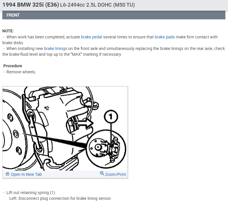

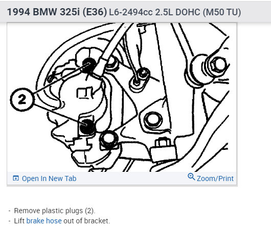

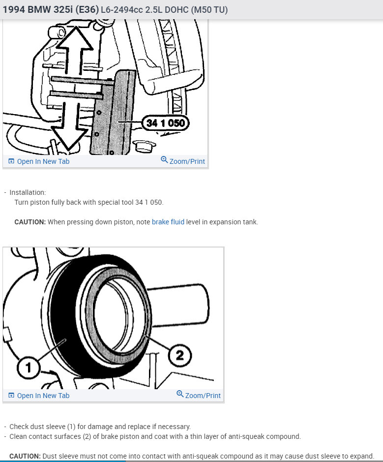

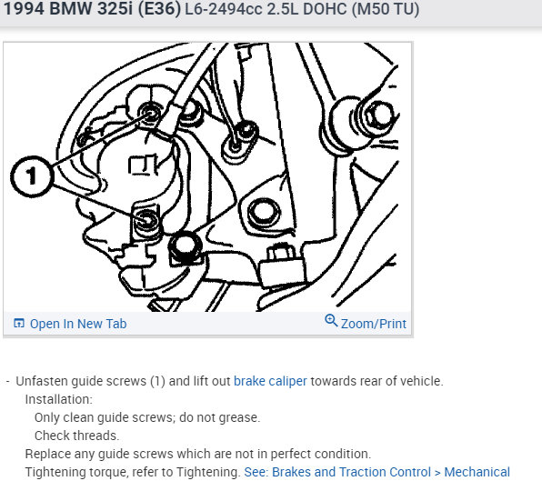

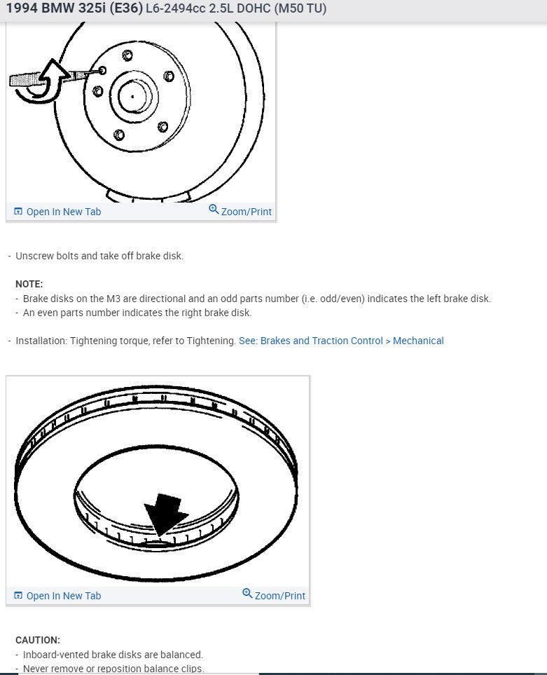

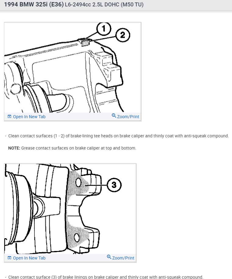

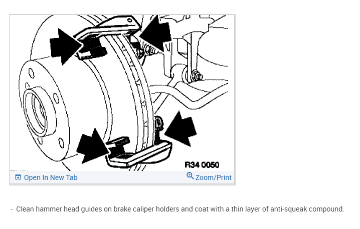

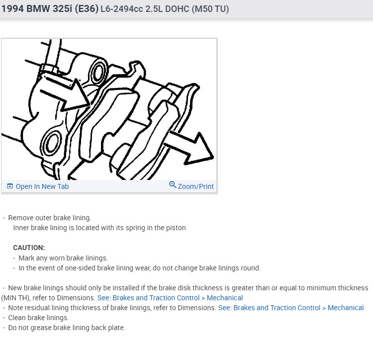

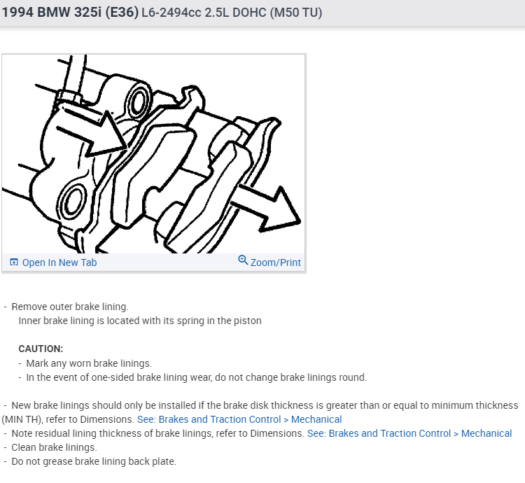

I have attached the runout test procedure below. Also included the brake pads and rotors replacement procedure for your reference.
