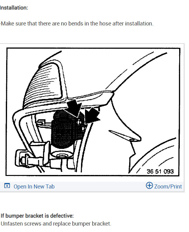

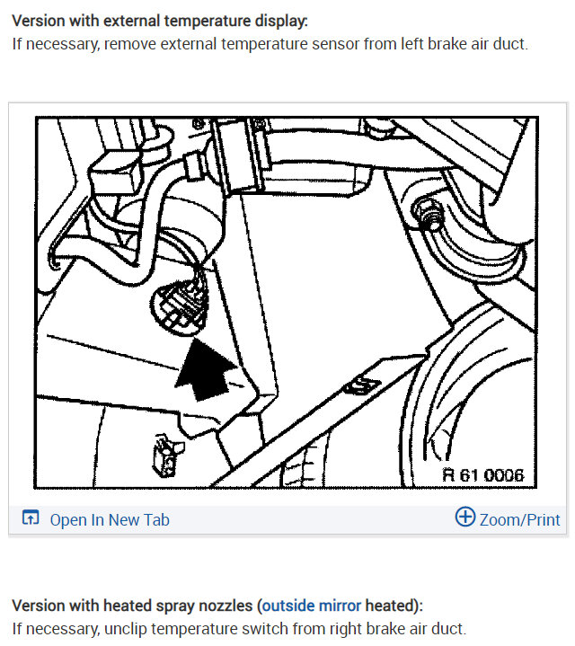

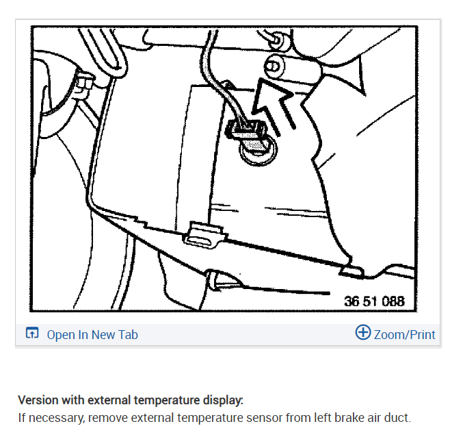

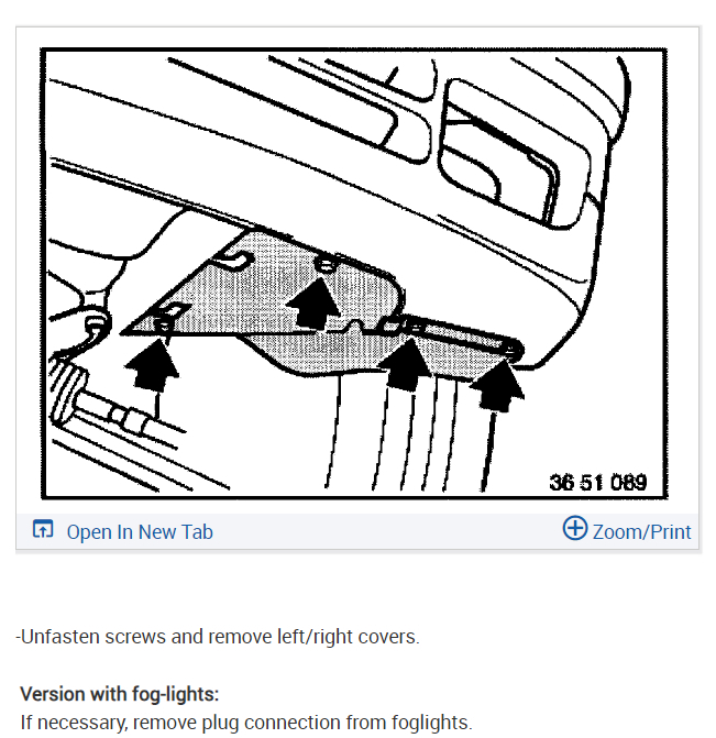

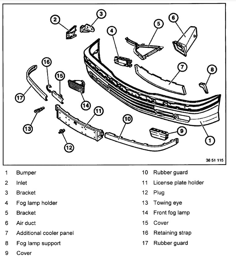

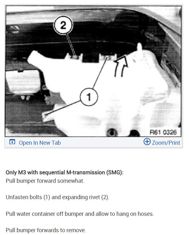

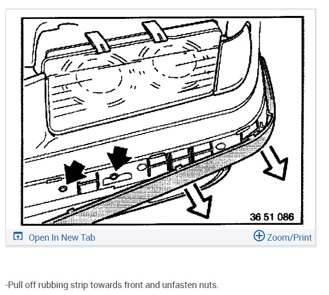

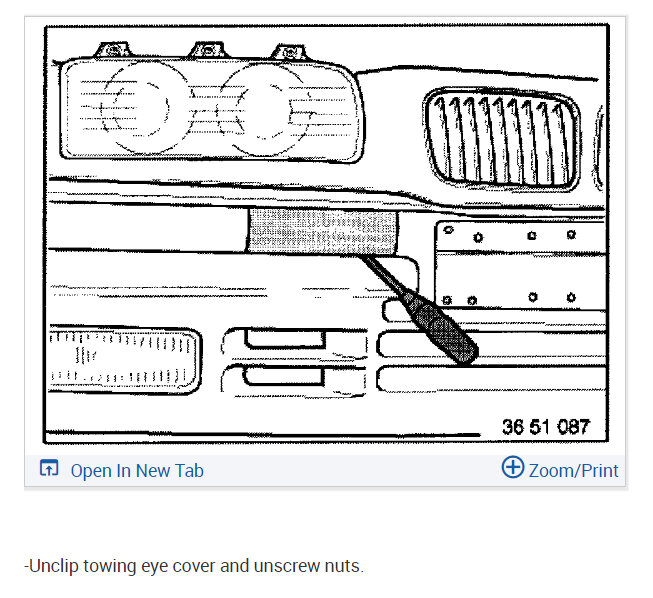

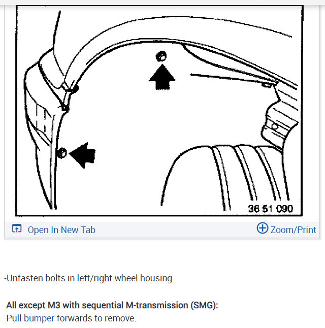

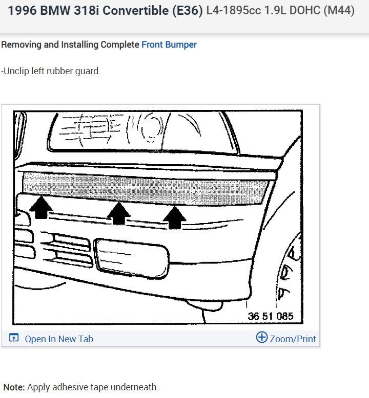

You can save money if you just do the job yourself, also if you take the car into the body shop you will save money on the part. Here is how to change the bumper out.
