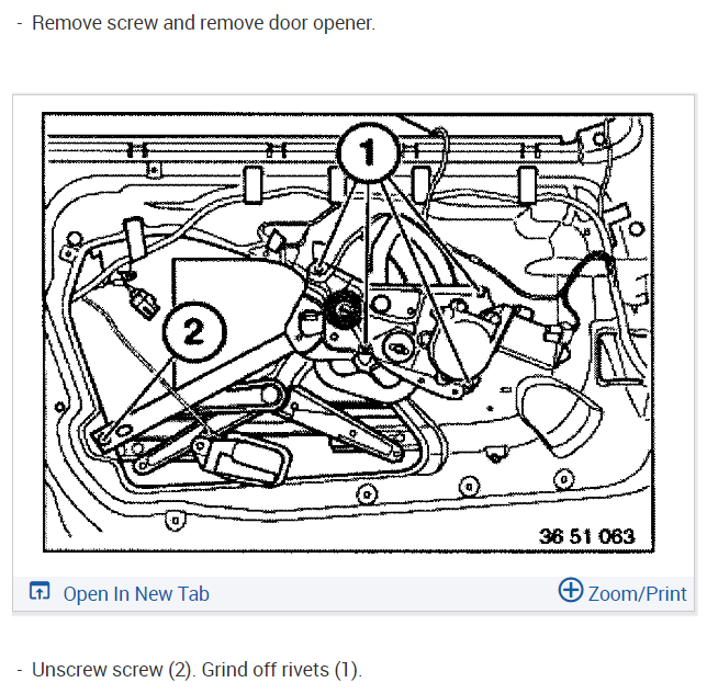

The window regulator and/or the channel the glass runs in are suspect and will require disassembly to know for sure.
Dec 8, 2007 at 5:17 PM

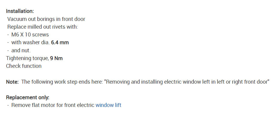

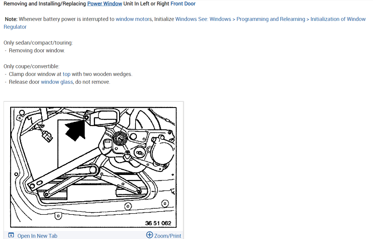

Most of the times the window regulator/motor is to blame. Here is how to change it out. Check out the images (below). Let us know if you need anything else.
