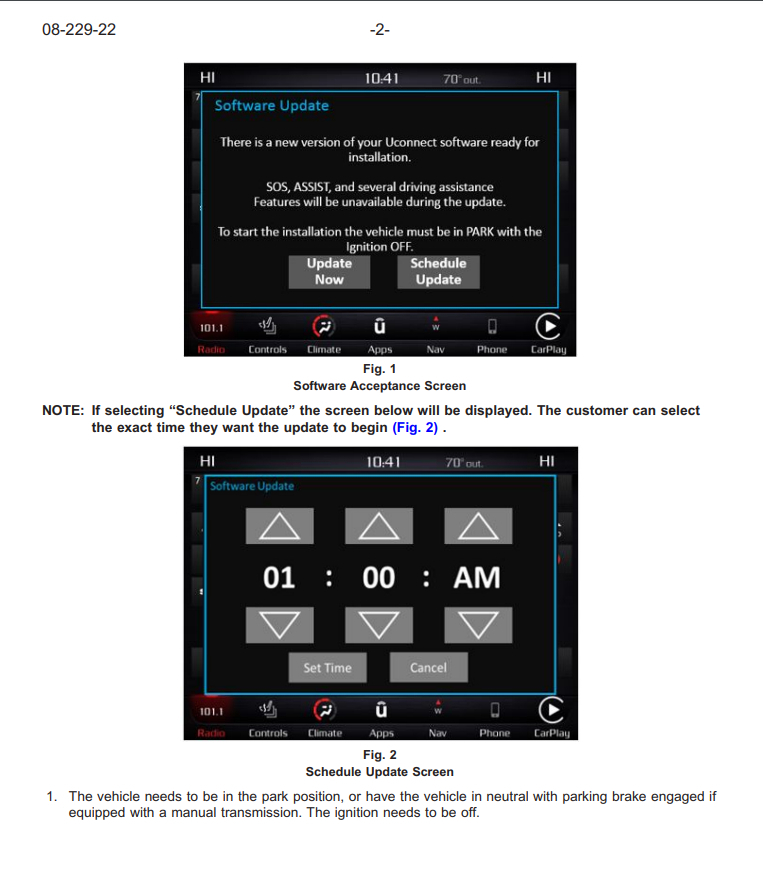

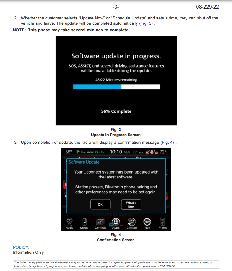

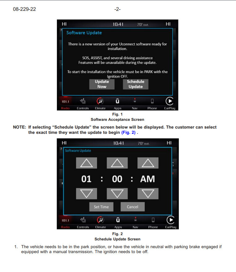

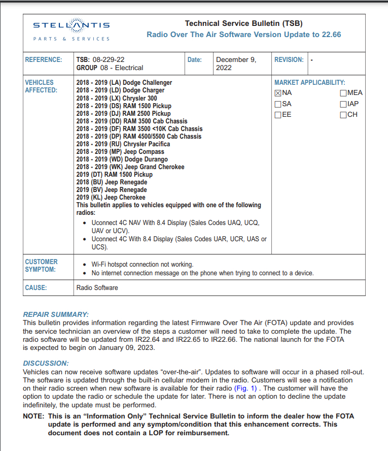

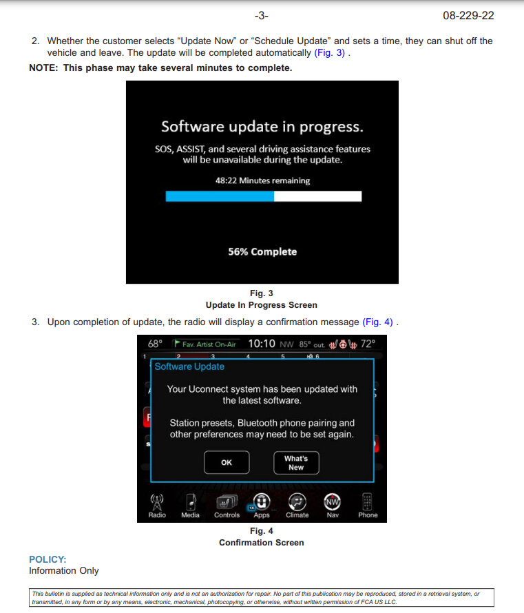

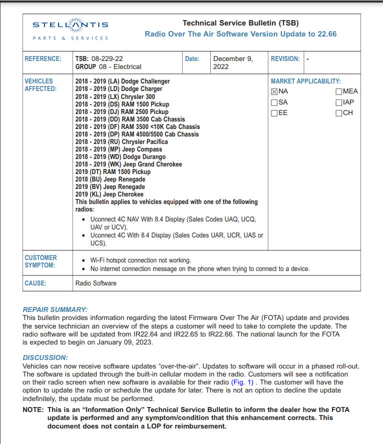

Below is one of the latest over the air updates for the Radio and Uconnect that you can try.
There is one more update, but it needs to be done with a dealership scan tool, it has to do with wireless connections and device app support.
