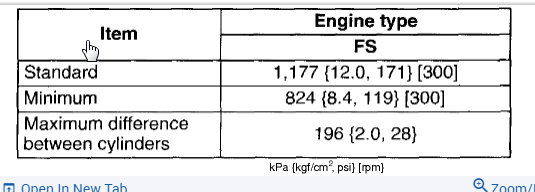

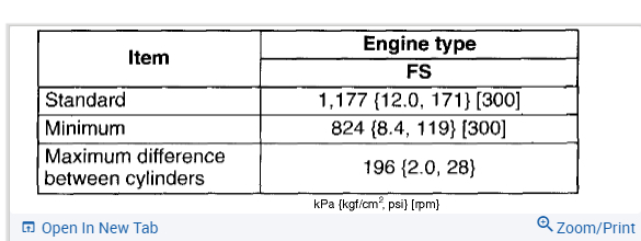

Okay. Compression is low but it is even. Standard compression on this engine is 171 PSI. Minimum is 119 PSI.
You may not like this recommendation but you are about to open a can of worms with this issue. You are burning oil and have low compression. This points to ring issues. I would suggest just checking the oil on a regular basis and make sure it stays full and drive it until it starts making noise or fails. The reason is, you are going to end up with an engine rebuild or replacement trying to fix this smoking issue. However, the car runs and is doing its job but just smokes a little so I would not chase that issue. Basically just start setting some money aside each pay check until you have enough saved for an engine replacement/rebuild and then just drive it until it needs it. The longer it goes, the more it is paying you back. However, if it does fail, you have the money ready to just get it fixed.
If you want to do another test, you can do a cylinder leakage test but the low compression shows it is leaking somewhere and the smoke points to the rings. However, the leakage test will confirm this. Let me know if you are not familiar with this and we can go from there.
This is just what I would do if I found myself in your shoes. Let me know if you have questions.
