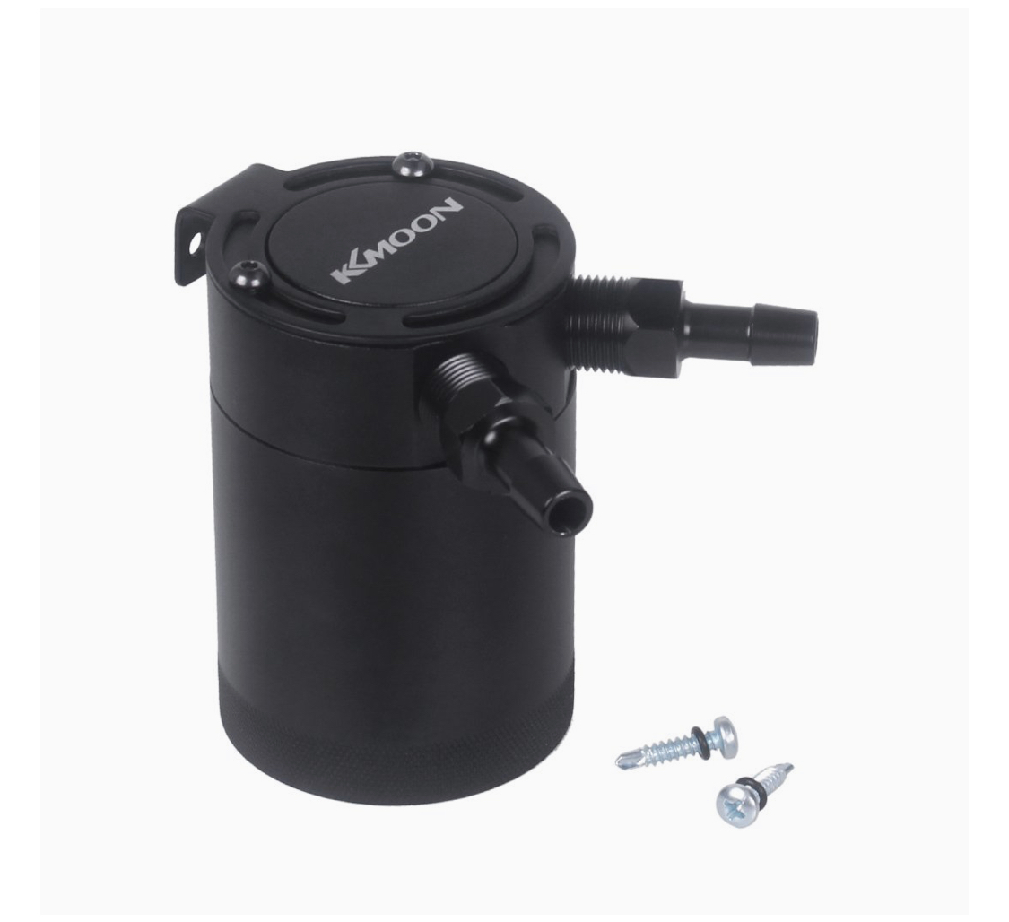

This oil catch can I used. The reviews were pretty much good.
Jun 15, 2020 at 1:35 PM
The only thing I can think is if the lines were installed in the wrong direction. Meaning they were reversed. Basically there is an inlet and outlet of this system and I guess that could cause an issue.
What I would suggest at this point is call the manufacturer of that catch can and ask if they have reports of this. Clearly if you put it inline of the PCV and routed the line coming from the valve cover to the inlet, and the outlet going to the intake, then I just can't explain it.
