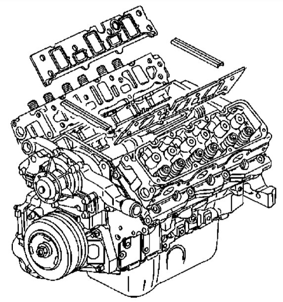

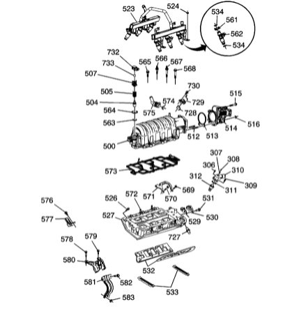

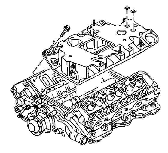

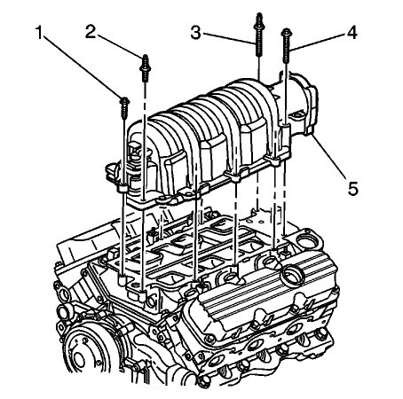

I have included some images here that are for your specific vehicle.
If you do decide to replace theses parts there are some other small components that will need to be removed to access the intake like a small bracket around the EGR valve and the fuel rail/injector assembly.
