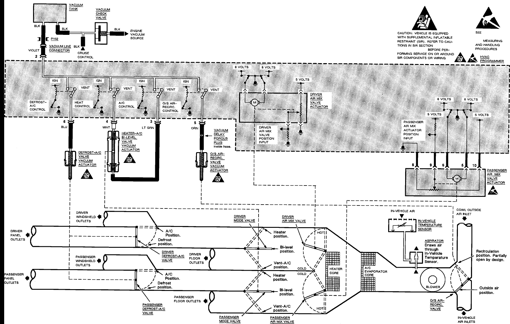

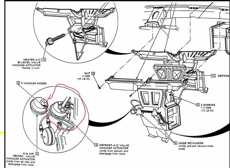

I was reading a post that you made about a problem that you had with the blend door for the panel vents involving the vacuum hose. On my vehicle that blue vacuum hose does have a strong vacuum but it was not hooked up and I cannot find where it hooks up. Can you help me?
