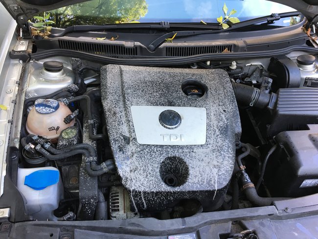

After about an hour of collecting the car I heard a pop and lost most of my power.
Another motorist stopped and confirmed that my turbo pipe had come off. I rang the garage and he almost too quickly agreed.

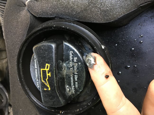

When I looked under the bonnet the engine cover and other plastic parts were covered in a spray of a grey/brown substance. This has stained the plastic and will not come off. When I rub the substance it becomes shiny almost like graphite from a pencil.
There was also water, oil and a greyish gunk around the filler cap on the engine.
I sent the attached photos to the garage and he says the stain is from a "cleaner" they use on the engine. It is obviously not a cleaner as its actually stained my engine cover.
