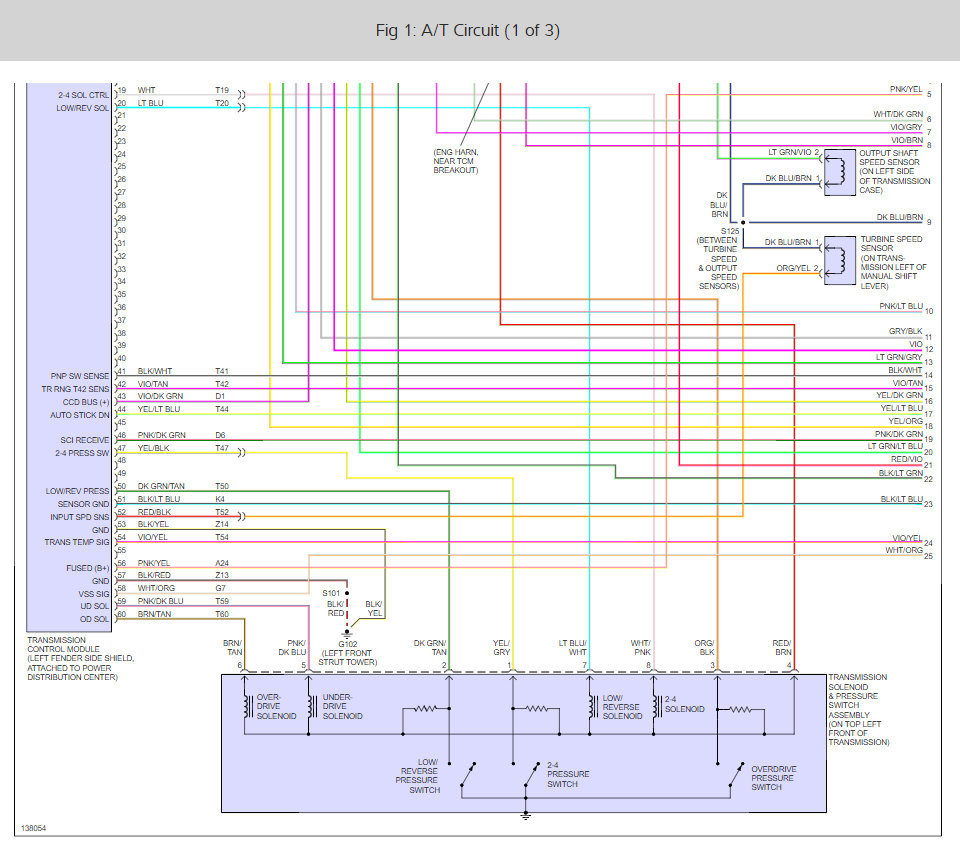

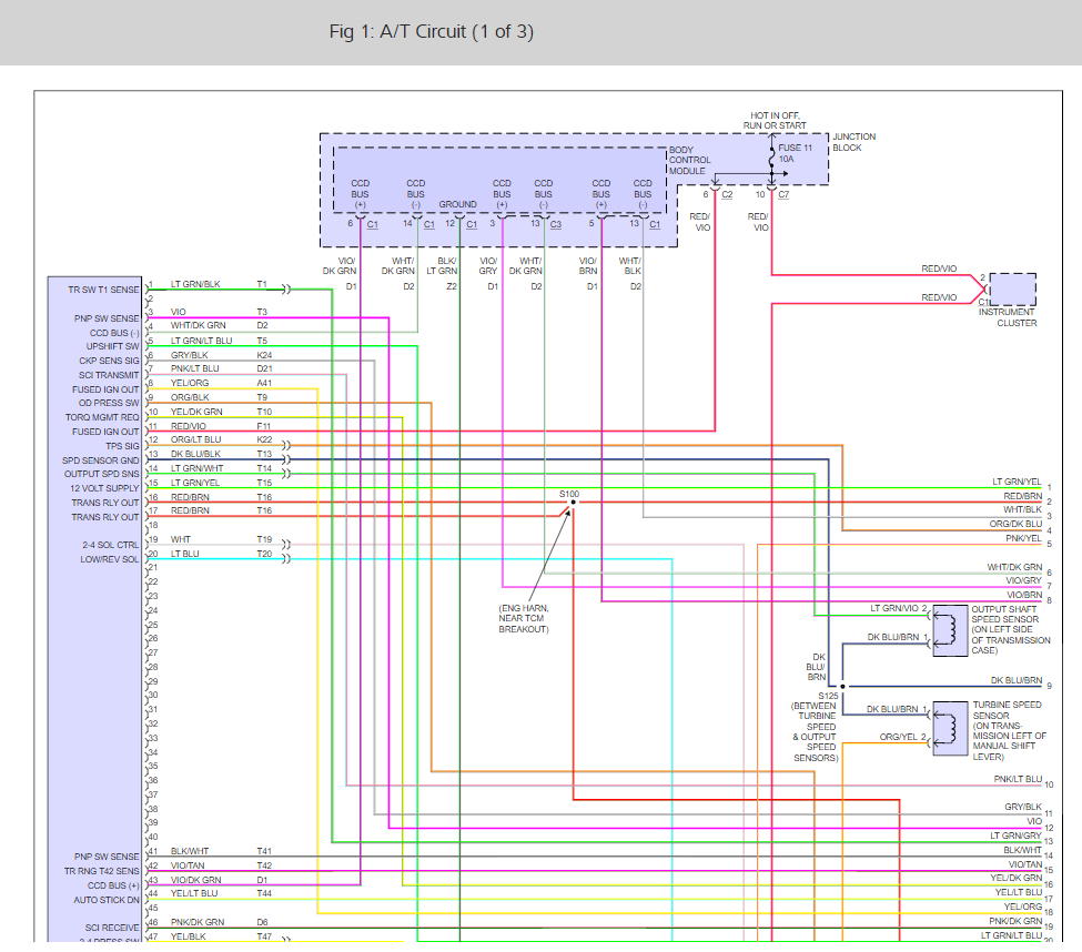

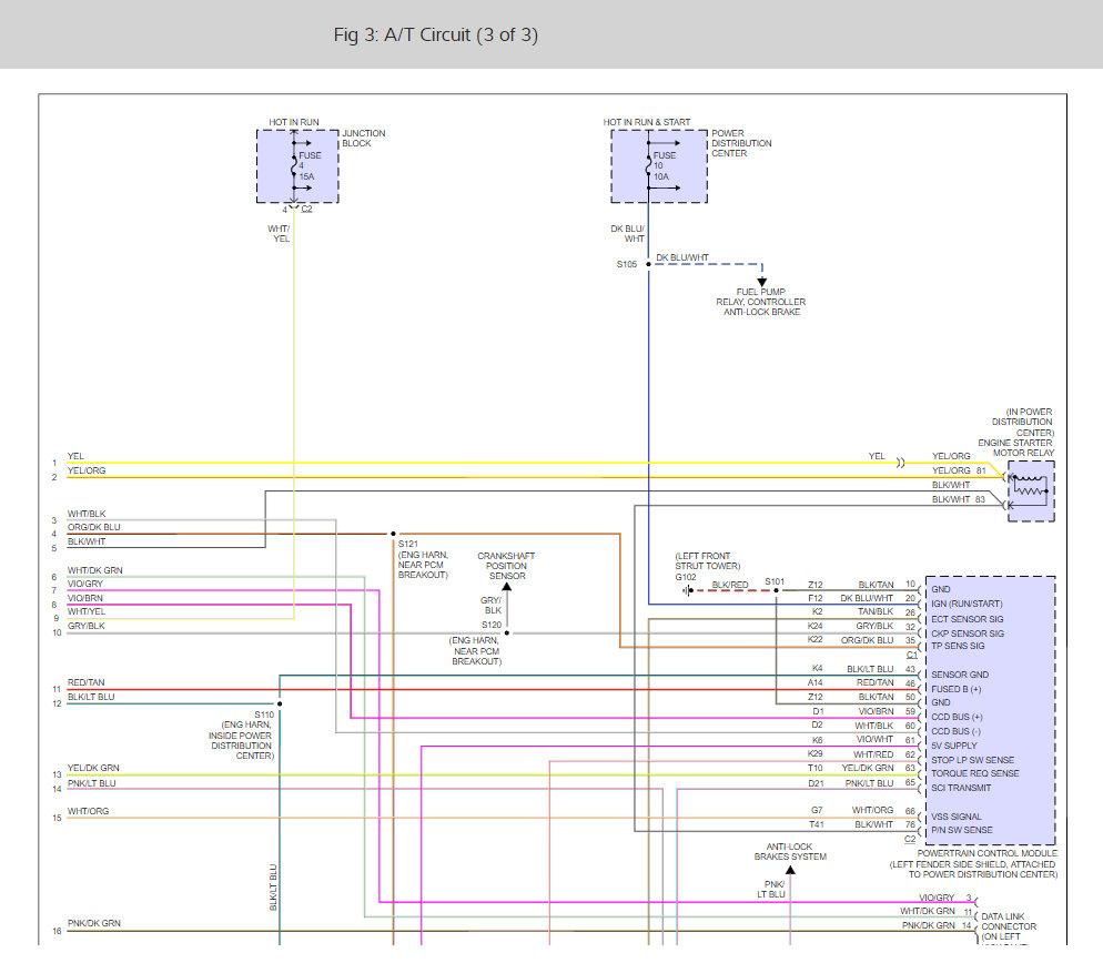

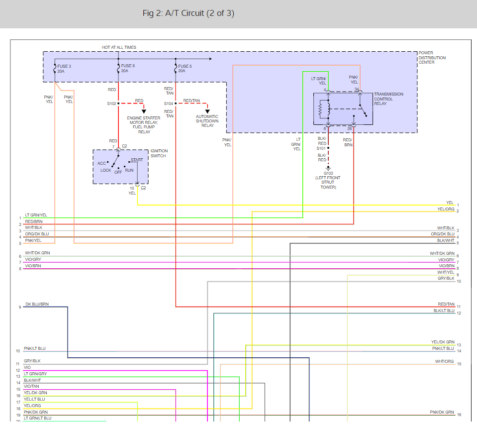

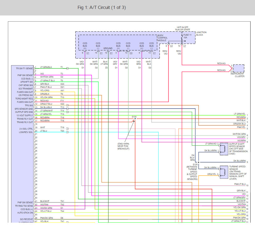

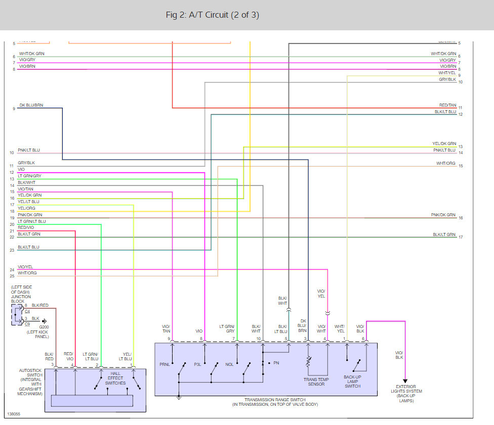

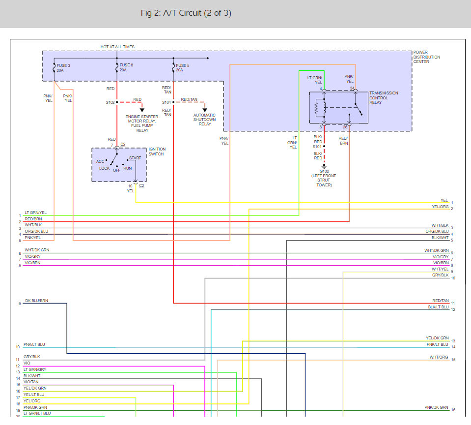

Sorry about the access thing I hope we got it figured out in the mean time here are the wiring diagrams (below) for the transmission and TCM with a guide for anyone who needs it.
Please let us know what happens so it will help others.
Oct 13, 2017 at 1:08 PM
CARADIODOC
  • 34,306 POSTS
Yippee! I got my nose in the diagrams. Thanks, brother Ken. First of all, there is a 20-amp fuse, fuse # 5, in the under-hood fuse box, that feeds the ASD relay and some other circuits. After the relay there's a 10-amp fuse # 1, also under the hood. Which fuse is blowing?
The 20-amp fuse feeds the coil side and the contact side of the ASD relay, and it's the feed circuit for the Engine Computer that's attached to the under-hood fuse box. I'd be surprised if the computer is shorted, but there is a diode in it between that circuit and ground. It's in there backward so it doesn't do anything until someone connects the battery backward, then the diode turns on and looks like a dead short to force the fuse to blow, thereby saving the computer. It's not common, but those protection diodes have been known to short. If it is shorted, your test bulb will go dim when you unplug the computer. That short will be there all the time. You don't have to turn on the ignition switch or crank the engine for the fuse to blow. It will blow as soon as you plug it in.
If that 20-amp fuse only blows when you turn on the ignition switch, the short is after the ASD relay. That relay feeds the large number of circuits, and one of them is protected by the 10-amp fuse. Just to double-check, remove the 10-amp fuse, then see if the test light stays dim. I suspect it will still be bright because if the short was on that 10-amp line, that's the fuse that would be blowing. That 10-amp fuse only feeds the heater circuit for the downstream oxygen sensor after the catalytic converter.
The other circuits coming off the ASD relay go to the alternator, the ignition coil pack, the front oxygen sensor's heater, the Engine Computer, (to verify the ASD relay turned on when it was commanded to), and the four injectors. All of those wires are dark green / orange.
The only other thing I wasn't aware of is a noise suppression capacitor. That is also fed with a dark green / orange wire, but the diagram doesn't say where it's mounted. The only clue I can find as to its location is the splice is listed as "engine wiring harness, in breakout to ignition coil". It says "TO" the coil; not "near" the coil. That splice is fed from a main splice listed as, "engine harness, near cam sensor breakout". To check the capacitor, if there is no connector to unplug, just unbolt it and hold it away from the engine.
