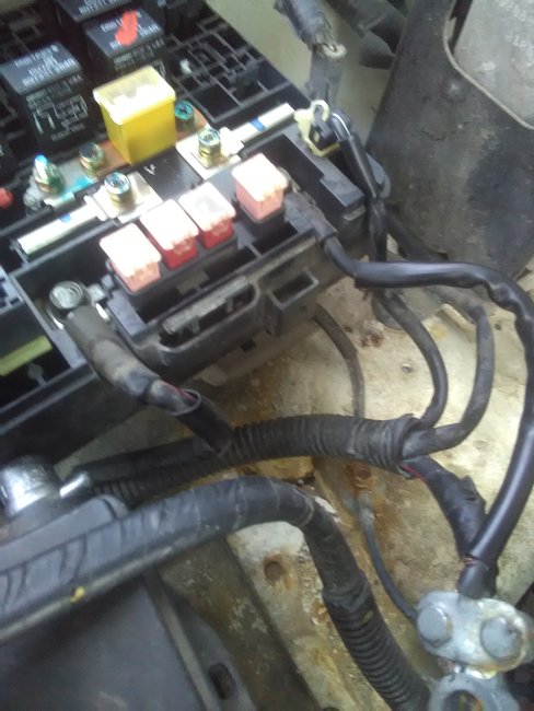

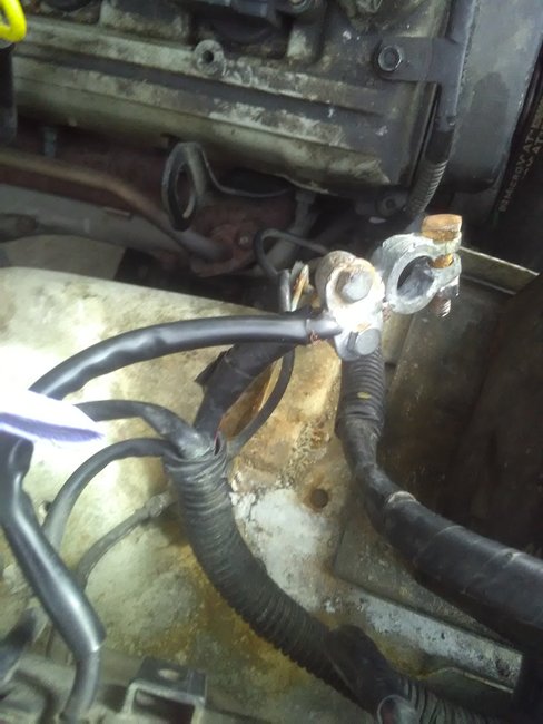

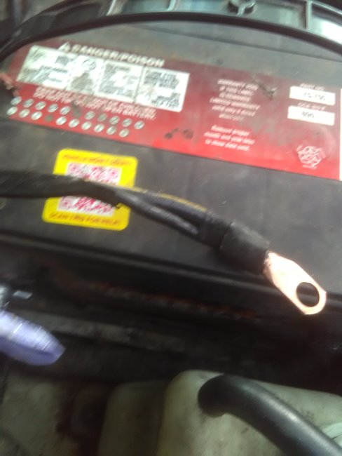

That may be the problem. There are two cables that are connected to the negative terminal. The negative cable it the first picture and the positive has four wires coming from it.

I cannot tell where they are all connected. Make sure nothing from the positive side is touching ground.
