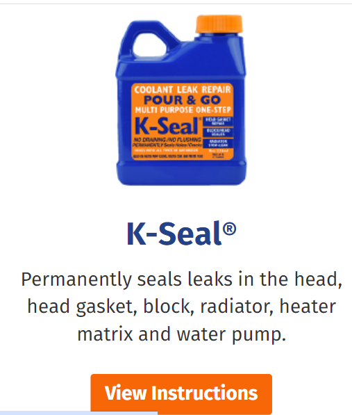

When my car overheated after it cooled down and I was waiting for a tow I checked the oil and it looked normal (It did not look milky as I later read could be a clear sign of a bad head gasket and yes I know that just because the oil was normal does not mean the head gasket was blown. As I said the drive home from the mechanic was very short (no more than 5 minutes) so I do know that the fact that the car ran normal does not mean it is ok, I do not feel safe driving it to work right now which is also 5 minutes away, What I am going to do is this I ordered K Seal HD, (This may have been a mistake because I read later that HD is for bigger engines like trucks and tractors so I will read and check to see if it is ok for cars and if not I will order the regular K SEAL, The reason I bought K Seal HD is because I figured with two leaks (radiator, blown head gasket) it might be the better choice, Either way when I install it (I am not sure yet do I put antifreeze in before or after) I plan to drive it around locally when I am off work and take it too another mechanic for a 2nd diagnosis.

That sounds like a plan. I'm not familiar with the product, so I looked it up. I wouldn't recommend the HD based on what I read. It is exactly like you mentioned, for larger engines, commercial vehicles, and tractors.
The pic below is what appears to be what you need. Yes, there must be coolant in the system because you have to install it and then allow the engine to reach operating temp. If you have to add, just leave enough room for the K-seal. Also, I know it is extremely important to follow the manufacturer's directions with this type of product.
If you can, let me know if it works. If it does, it is supposed to be a permanent repair, so don't be worried about keeping it. It has low mileage for the 3.1L engine. Also, the most common location for a coolant leak on these is the intake manifold.
Take care of yourself and let me know if you have questions,
See pic below.
