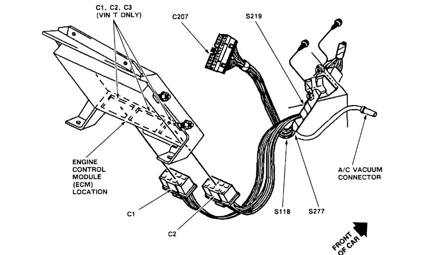

You would need to disconnect the module and see if the fuse still fails. If it does, it is a wiring harness issue.
https://www.2carpros.com/articles/how-a-car-fuse-works
If it does not, then it is an internal issue with the module.
Component Locations-Behind RH Side Of I/P (VIN 4 Shown, VIN T Similar)
