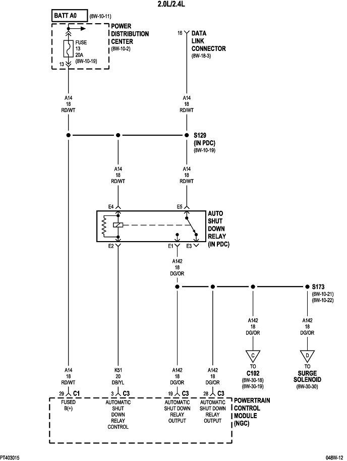

The fuel pump/ASD fuse keeps blowing after 5- 10 minutes of idle. do i have to replace the fuel pump and where can i find a wiring diagram to look for a short?

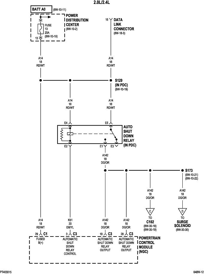

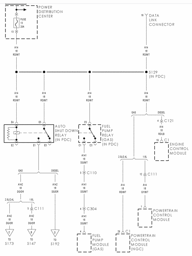

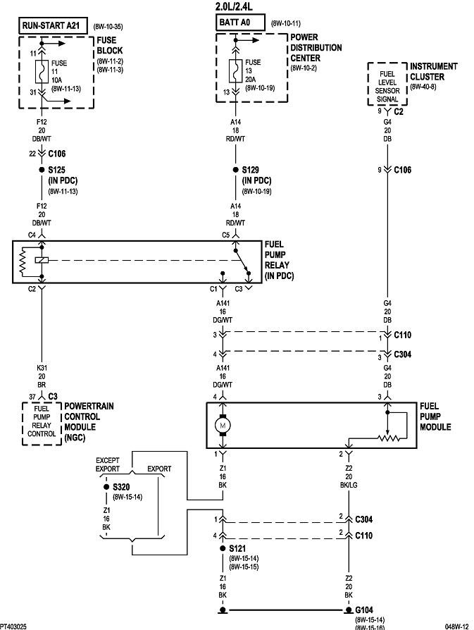

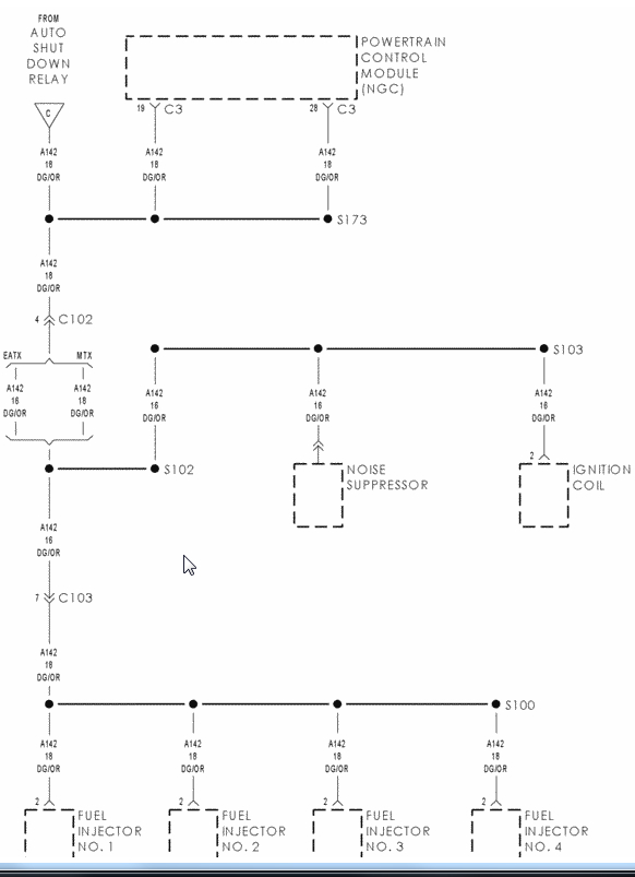

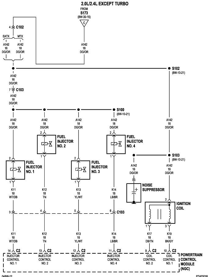

Okay. This is great. If the fuse that is blowing is fuse 13 which is a 20A fuse for the ASD and fuel pump relay, then I would suggest a little different approach as these are not items that you can install smaller fuses on.
Here is a list of components on this fuse:
1. NGC Controller
2. Fuel Pump
3. Noise Suppressor
4. Ign coil
5. Fuel injectors
Clearly you will want to inspect wiring as stated above and you can use the bulb method as well. That will probably be the easiest thing to do to test it. You can also use an amp meter in place of the fuse that way you can see what the actual amperage is. However, the most common causes of these items to draw to much current are the fuel pump and ignition coil. In fact, I just had a 2.4L vehicle about 6 months ago doing this same thing and it was the coil. This is way it seems like because once the engine starts to get hot, I bet it is causing the issue in the coil. If you have another coil, I would swap it out and see what happens. It is the easiest part to get to and in my mind, is worth the risk of being wrong. Worst case, you have an extra coil for the future.

I haven't changed the coil yet,but did unplug the fuel pump and turn the key to on and the fuse blew as soon as i turn the the key to on.
Oct 8, 2019 at 3:05 PM
Okay. That is good because that eliminates that as the cause. As I stated before, more than likely this is a component but there is a chance that you have a wire that is rub through and shorted. However, I would check the other components and go from there. Thanks
Oct 8, 2019 at 4:55 PM

Do you own stock for the company that makes the fuses? The light bulb trick is specifically so you don't have to keep wasting fuses. It's almost impossible to find the short the way you're going about it. Put the light bulb in place of the fuse, but because the ASD relay only turns on for one second, that's not enough time to run around unplugging things. Instead, put a new fuse in the socket, then remove the ASD relay. Put the spade terminals and jumper wires to the bulb in terminals 30 and 87. This will power up the circuit without even having to turn the ignition switch on, and the bulb will be full brightness. That proves the short is present, and the bulb will limit current to a safe one amp. Now you can unplug things and move harnesses around. When you do something to isolate or remove the short, the bulb will get dim or go out.

I found the coil to be bad so i changed the coil and the fuse blows when it tries to fire. I have checked the fuel pump, noise suppressor. How can i check the fuel injectors to see if they are the problem? also i checked the main wire (dark/orange) and found no short.
Oct 22, 2019 at 1:25 PM
You can check the resistance of each injector. It should be around 11-18 ohms.
Oct 22, 2019 at 5:24 PM
