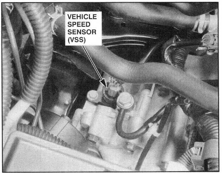

A slightly educated guess, from experience, would be to say to check the vehicle speed sensor first. Occasionally, on older vehicles, animals will build a nest around there and chew up some of the wiring, causing a short circuit condition. Usually, with a flashlight, you can poke around and see what is going on.

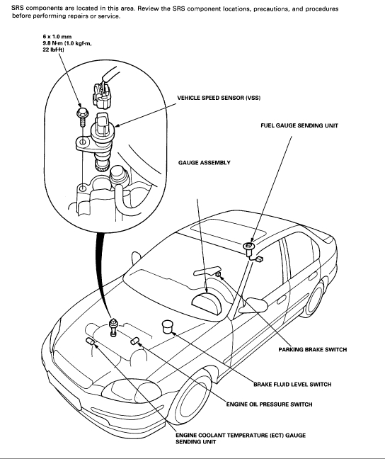

So here is the first test. Open the hood. Using the attached diagram, find the vehicle speed sensor and trace its wiring as much as possible. Look for any obvious problems. If you see nothing, unplug the sensor itself, and turn the key on and see if the fuse blows again. If the fuse does not blow, then you have identified that the sensor is the problem.
