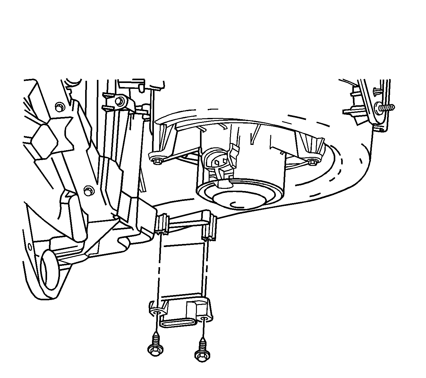

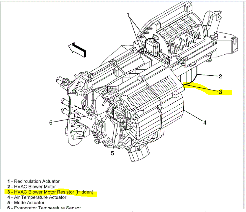

First, confirm there is power to the blower motor resistor (see pic 1). I attached a pic below showing the general. If it does have power, replace the resistor.
Here are directions for replacing the resistor. The attached pics correlate with the directions.

pic 2
1. Disconnect the electrical connector from the blower motor resistor.
2. Remove the blower motor resistor screws from the HVAC module.
3. Remove the blower motor resistor from the HVAC module.
