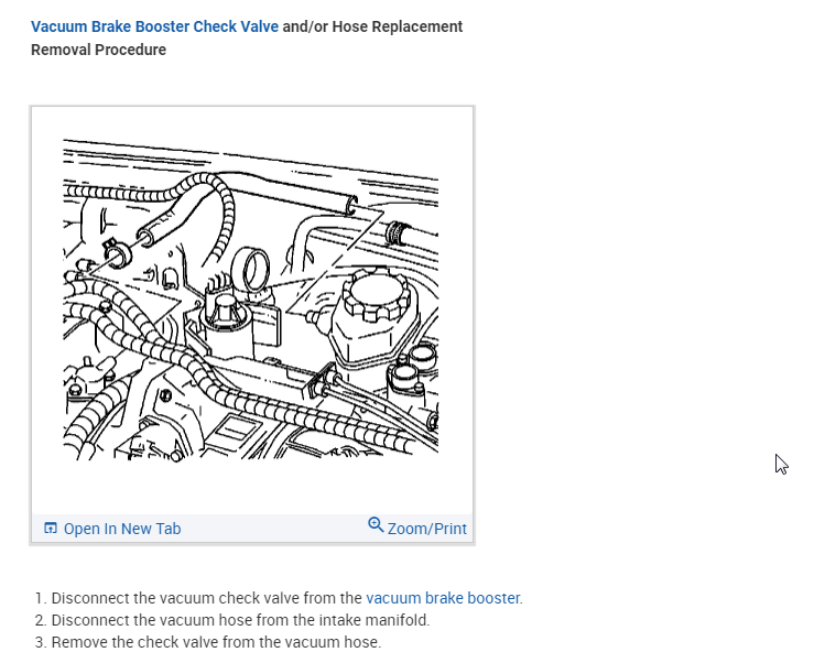

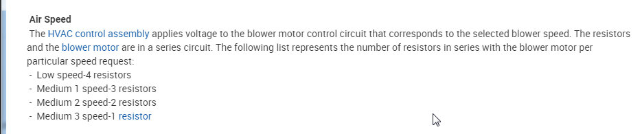

Just got the van back from local shop for an A/C evac and fill. Tech says that there may be a vacuum leak as the blower is increasing as you accelerate. He mentioned a vacuum check valve but I don't recall that being on this model. Anything I should be looking for or another place to check?
