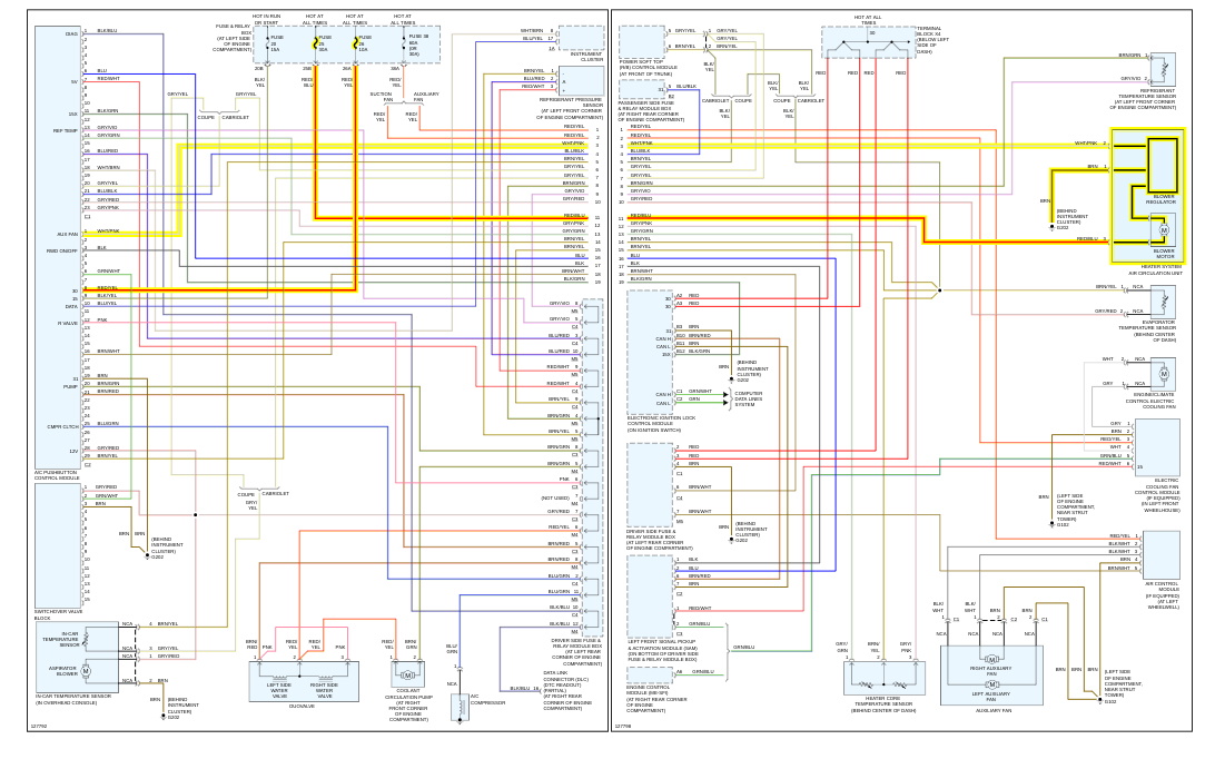

I was having a blower switch not working on high. so I replaced the A/C climate control console with a new one. It work at first but I had no hot or cold air. I checked the fuses and now I have no fan blowing at all. I even put the old one back in and still nothing.
Any ideas?

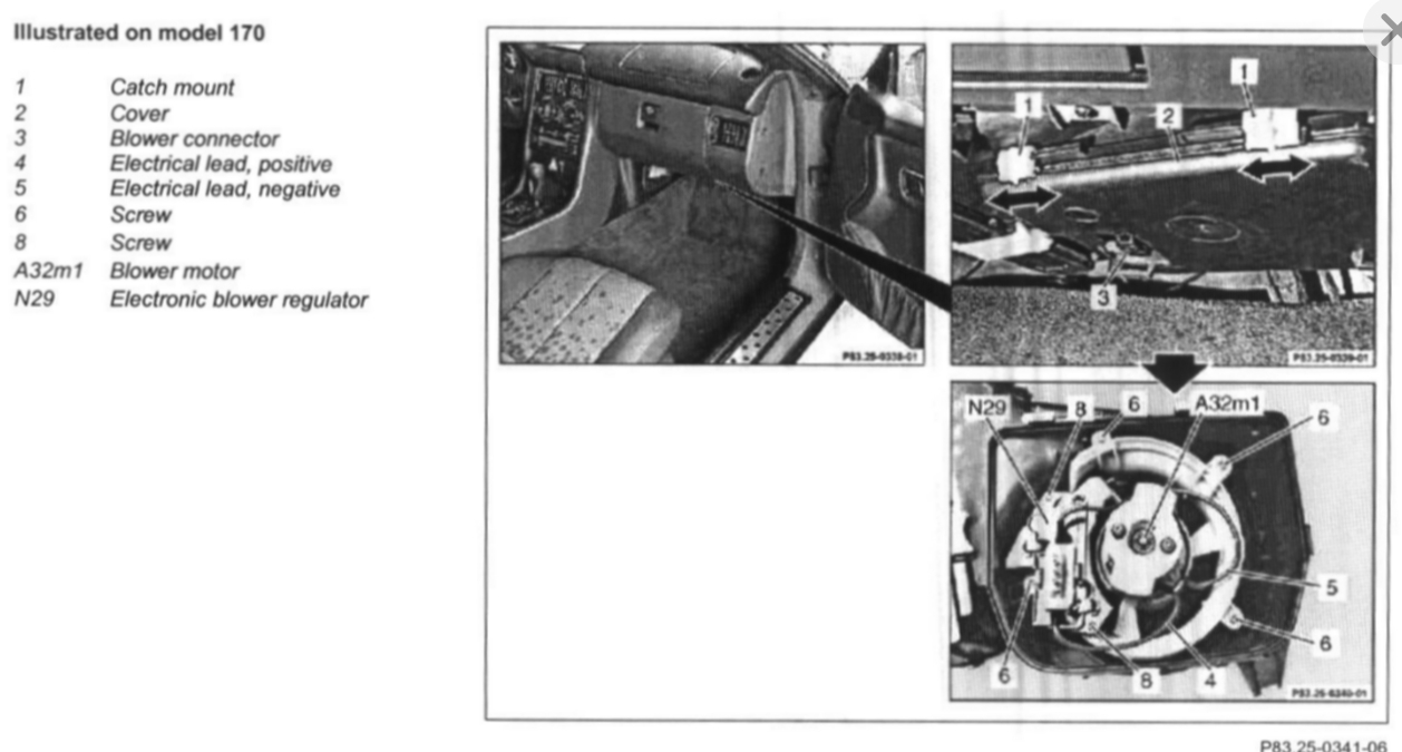

It could be the heater blower motor regulator is faulty, I'm attaching wiring diagrams of the heating system for you to check the fuses, wiring and grounds. I'm also attaching replace heater blower motor regulator replacement procedure below for you to check voltage drop across the blower motor circuit. Please let us know if this information was helpful and if you need more information.
