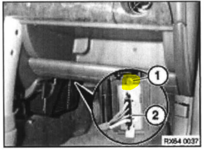

I can't get the Torq screw out to replace the resistor. i know where it is located just can't find the right size for the screw.
Jul 29, 2023 at 10:54 AM
That isn't something they provide in manuals. However, if I recall correctly, I believe it is a T15 or T20. Please understand, that is from memory. I may be wrong. Try that and let me know if it works for you. Also, just for confirmation, I attached a pic below to make sure I'm thinking of the same part. Let me know.
See pic below.
