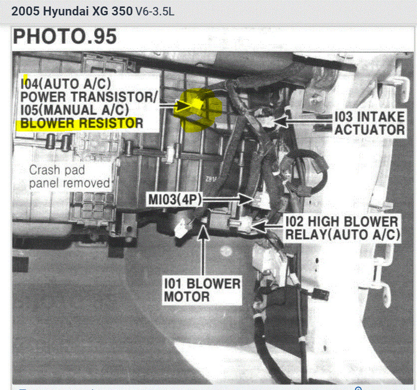

Wheres is it located on my car?

It is located under the dash on the passenger side and is mounted on the HVAC box. I attached a picture of it's location.
Let me know if that helps or if you have other questions.
