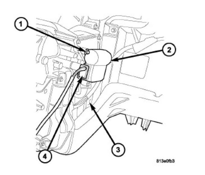

It sounds like you have a blend door actuator that is not working right. Here is a guide and diagram on what you should check and/or replace.
Please let us know what you find so it will help others.

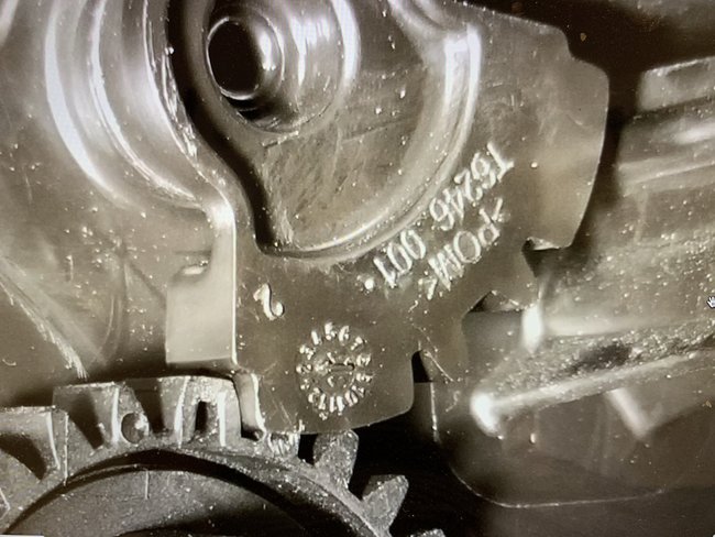

I was in the process of replacing the driver side blend door actuator gear on my vehicle listed above today, when the adjacent gear it aligns with, fell off and got lost. So now I’m looking to find the part name and number for that item so I can purchase and replace. Please see the attached photo for reference.
Please help!!!

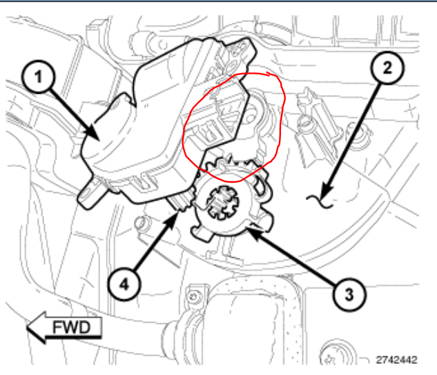

Since you used your cell phone to take that picture is there any way you can magnify the screen shot by blowing it up by hand to get those part numbers? I looked on my repair guides but the gear is covered by the actuator and doesn't show a name or any numbers. I've attached a picture below and circled in red. Let me know if this looks like the plastic gear. Hope you might have found it or can blow up your photo. Keep us updated as soon as you can. Hope this helps and thanks again for using 2CarPros.

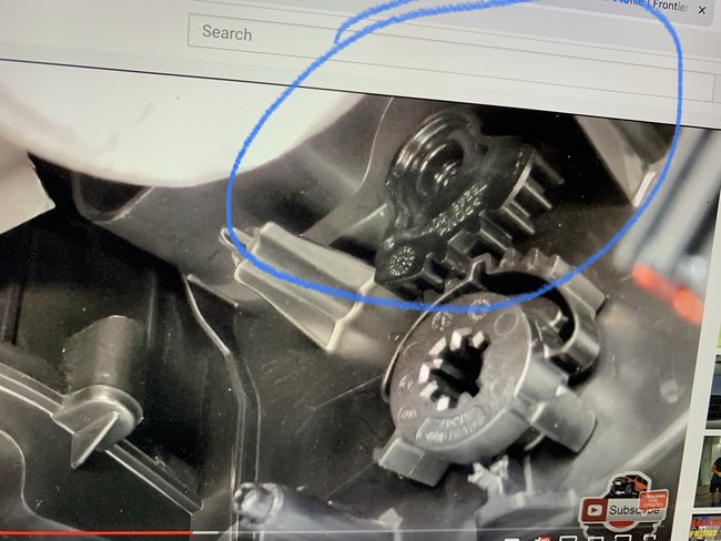

The part you have circled looks like it. Here is the zoomed in image I found online.

You might have to buy a housing. There are 3 different versions so I will need the last 8 digits of your VIN number to find out. Get back to me and we'll go from there. Thanks again for using 2CarPros.

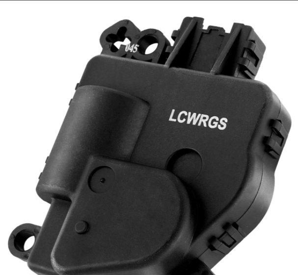

I've tried finding this for you with not much luck. I was told there are only 2 items able to be purchased being the gear itself and the actuator. I've attached pictures below available for purchase from local Jeep dealers. Your best bet might to be to take your phone with that picture on it to your local Jeep dealer parts department and see what they can do for you. Hope this helps and thanks again for using 2CarPros.

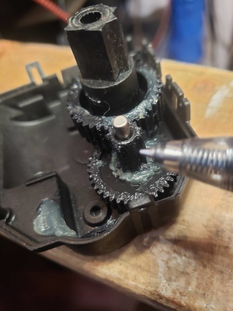

I just opened up the old one and I can see where the gear is all chewed up. I will remove new one from car and remove case tomorrow. thank you, will let you know what I find.

Yep, that is common.

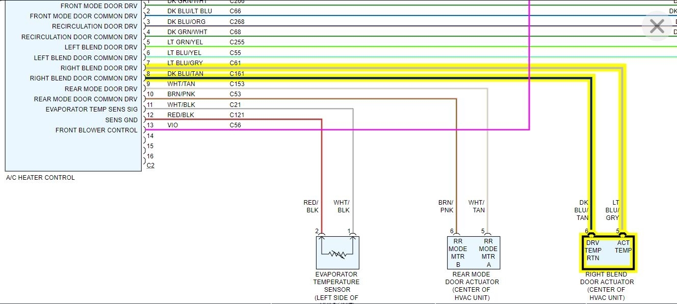

Can you hear the door try to move or move? Did you move the door manually and see if it blows cold air?
I attached the wiring diagram for you of the blend door motor.
Check for voltage at the actuator when you command cold and heat.
